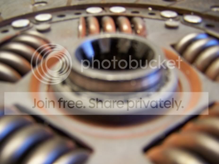

    Here is a pic of the spline note once it backed out it ground off the groove for the snap ring
    [​IMG]

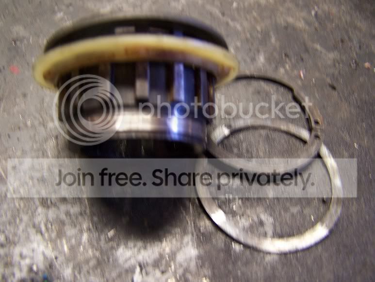

    Here is a pic of the spling on the clutch where the snap ring should be
    [​IMG]
    I am baffled to what will caused this,any ideas????
    Everything is new and I double checked to make sure the clutch was install correctly.
