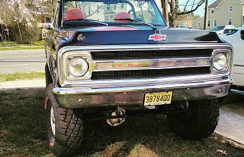

So I bought this '70 K5 and fell in the rabbit hole ever since. It was tired, a victim of someone's "perfume on a pig" restoration. Original 350/350.Paint is nice.

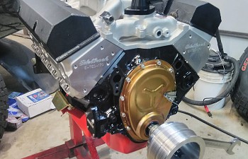

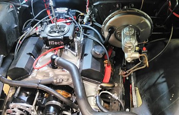

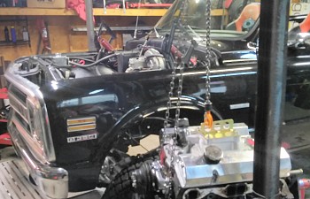

Engine
Original 4bolt main bored and stroked 383ci, 11:1, edelbrock etec 170cc heads, edelbrock performer airgap/vortec intake, MSD pro billet/6al box, QFT 750cfm carb, fender well headers, Diy4x detachable cross member
Transmission
Original th350, Rebuilt and deep aluminum pan, hughs rv/tow converter, transgo shift kit

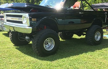

Suspension

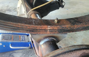

6" skyjacker leafs rear with traction bar and bilstien 5125s axle moved back 1.5", 6" tuff country soft ride leafs front with 5125s, chassis unlimited modified traction bar/Ord cross over, Diy4x detachable xmember
Axles
Front d44 stock open, rear 12bolt with Detroit locker and moser axles, welded center section
4.88s
Wheels
American racing ansen replicas
Tires
35x12.5r15 General grabber
