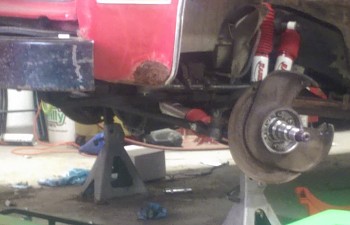

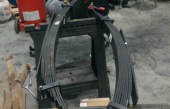

replaced front springs with 1 ton 4 leaves, energy suspension bushings, rancho rs 5500 shocks 4 in front, rancho steering stabilizer shock, new 1 ton rear springs with energy suspension bushings, roadmaster active overloads (adjustable from 1.5 to 3 ton overloads,), rancho rs 9000 adjustable rear shocks, shackles bushings were replaced with energy suspension bushings,
Axles
10bolt chevy front, 14 bolt sf rear, 4.11 gears g80 locker rear, replaced all the brakes,(rotors front calipers pads hoses),(hoses are off a 2wd they are about 4 inches longer),(rear brakes shoes adjuster kit spring kit shoes and had the drums cut they werecut in great shape and wheel cylinders replaced,axles bearing and seals replaced in rear, front new inner and outer bearings spindle rebuilt kits

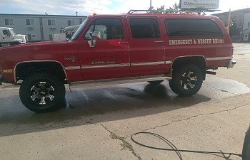

Paint
was originally gray put was painted fire truck red with gold flakes on the lettering when it was a fire rescue rig
