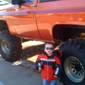

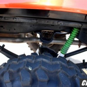

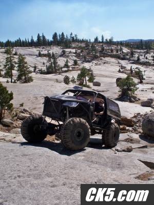

this is my 1983 blazer that i got stock and decided to make a crawler. The most questions i get asked about this truck is " what the headlights out of?" well they are out of my old 05 honda civic, they were laying around so i used them. The truck has rockwell axles, detroit in the front welded rear, 44 boggers, pinion brakes,4 link front with 2.5x18"travel fox air shocks,63" chevy rear springs,axles pushed 10" forward, propane injection,marlin crawler dual ultimate tcases, full hydro steer,very heathly 355 small block and so on. its still a work in progress but its full as hell to drive
