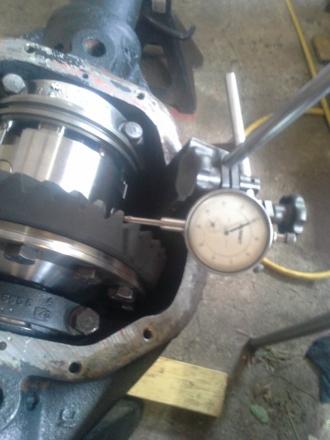

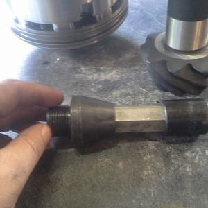

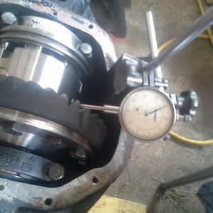

85GMCJD all set up
MorganBrady
85GMCJD all set up

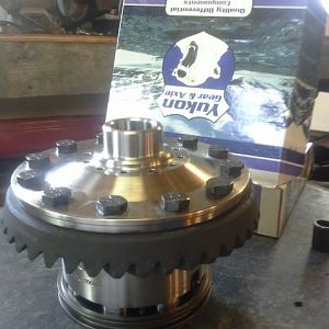

I use a homemade diff spreader and a set of spare bearings that are opened up inside so they slide on and off the carrier. Use these to get my shims right, then press on the real bearings to be used.
