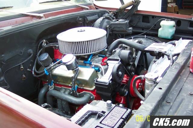

Finally in my truck. Made 451 hp @6300 on the dyno. Added a TBI sepentine setup, I like it. Its a 30 over 383 with Eagle steel crank, eagle 6in H-beams rods, Wiesco pro-tru domed forged pistons, Dart iron eagle 215 cc intake runner with 2.05 intake 1.60 exhaust valves, roller rockers, guide plates and stud girdles, Comp solid cam 532 555 lift. Toped with a Dart Kool can intake and a Barry Grant Mighty Demon 750. She is a torque monster, 502 ft lbs @3800 RPM.
