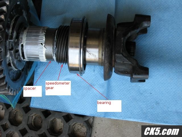

NP205 output shaft
JDNobodi
Aug 8, 2007
Here is an early model NP205 fix yoke with the bearing, speedometer gear and spacer assembled without the output housing.
