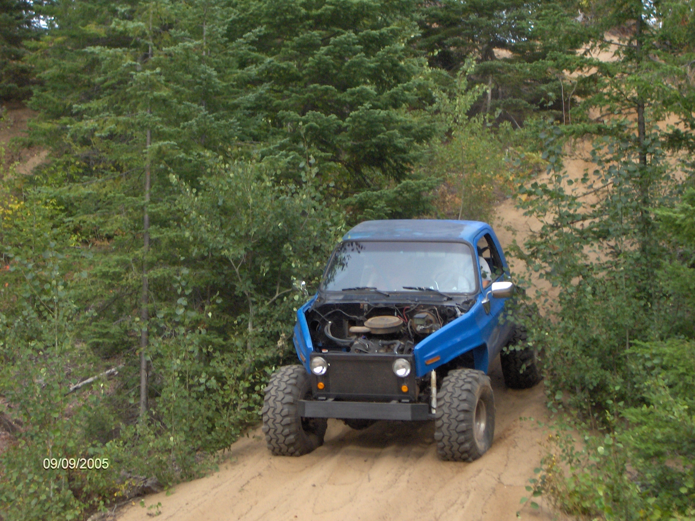

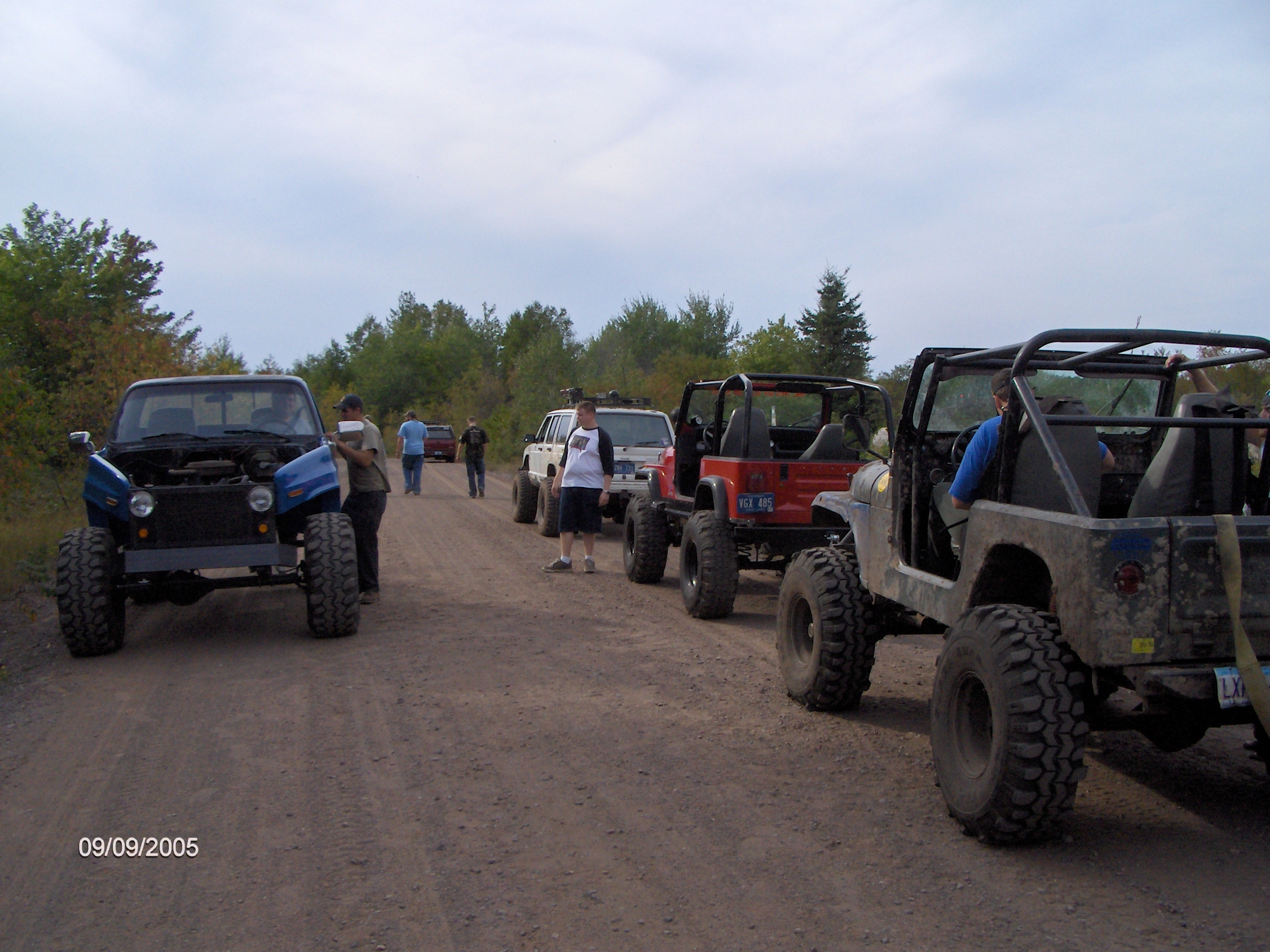

My abomination weighed 2660 with me in it and 31 gallons of gas. That's no bed, no inner wheelwells, and no hood... and no tools/parts. 10 bolt/12 bolt locked with 4wdisc and crossover with 40s on aluminum wheels, TBI305/465/208. 56"/64" springs. 87 cab with buckets and zero interior, not even a dash pad. No door glass/window regulators/locks either. Cab moved back 3", motor/trans/case moved back 2.5", rear axle moved back ~2.5", front axle moved forward 4.5".
Embarrassed the hell out of a lot of people with 4x-10x the amount of money in their rig. In that form I had around $2600 into it. It went like hell and I never broke anything, largely due to the fact that it didn't weigh anything. I've since retired the axles and tires. 40s are just stepping stones.
Asking here on ColoradoK5 is about the last place I'd ask a question like this. You're better off anywhere than here. Here, if you don't have 1 tons with anything bigger than 31s you aren't given the time of day.

I have a plethora of half ton axles. I could break my spare for my spare for my spare... and that'd just be my spare shafts... not my spare complete axles. I ran a 12 bolt in the rear because the shafts are just a wee bit bigger than 10 bolt ones, I could get the same clearance out of it as a 10 bolt (13" under both cases after shaving... with 3psi in the rubber), and I could just swap on a set of 10 bolt disc brakes. I could run my 6 lug wheels... which I happen to have like half a dozen set of aluminum 15x10s...
Most of the club runs Heeps with 37x13 Boggers or 38x12.50 TSLs with Dana 44s and either an I6 or Chevy/Ford V8. I had the same clearance as them, a tread width wider than their section width, and 2.5" taller tire... while having between 800 and 1,500 fewer pounds to carry around. While I had a foot more wheelbase than them... the lowest part of my frame was 25" from the ground (flat crossmember/clocked 208)... with just 4" of suspension lift... so I had the same breakover angle as them. Since all my weight was low... even my battery mounted under the passenger seat and running zero glass in my doors... my **** could run at an angle that they cried at. I tried to get the weight so low on the chassis that I didn't even run sun visors.
CK5 is full of people running 1 tons because their stuff weighs 5,500 to 7,500lbs. It's almost like they all build their stuff out of railroad tracks with 1/2" plate welded on it or something. Or bending a bunch of tube so they can try to piece together their frame that keeps cracking from poor nodal analysis and it ends up looking like a jungle jim that weighs twice what a full on tube frame would.

Well, when I started building it (this past March) I figured there was a 90% chance that wherever I went 36s would get me where I wanted to go. So, I planned on selling the 40s and buying 38s and then build a buggy for "real wheeling" that requires a trailer and several states worth of travel.
Like I said, I have pretty much nothing into it compared to most people. Half ton stuff is nice because nobody wants it.
