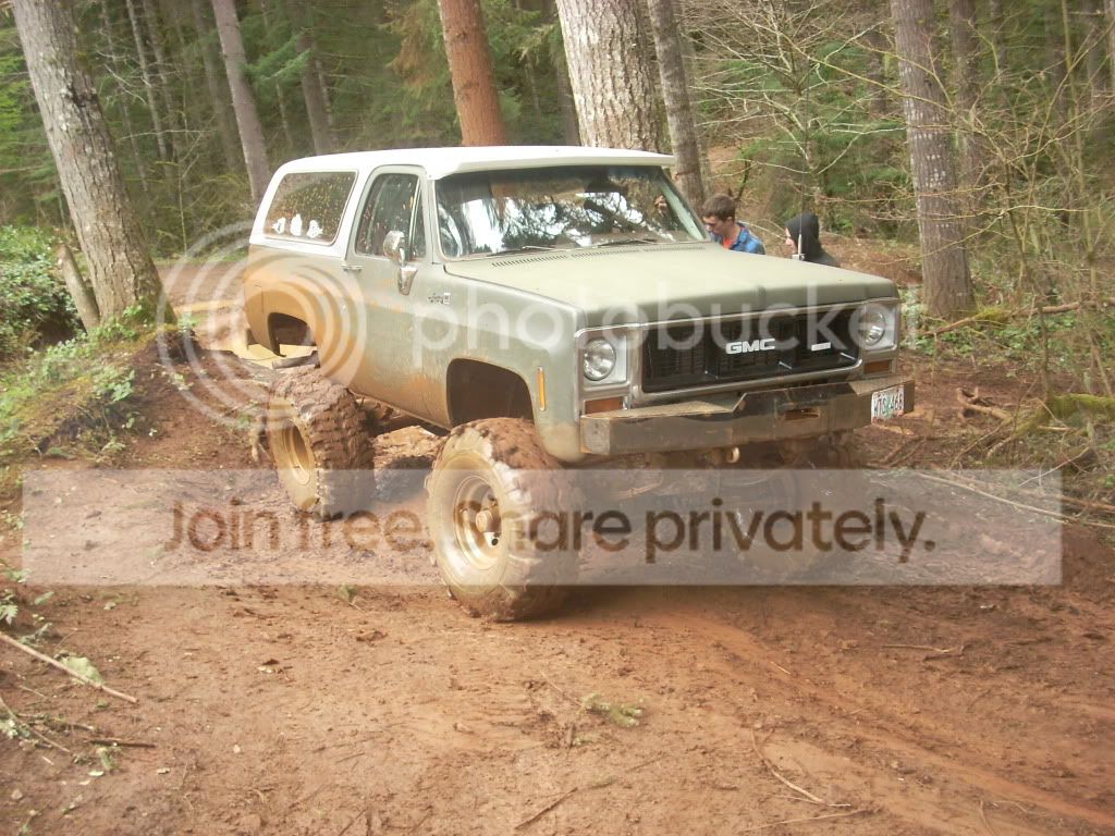

so i can get a set of 12'' superlift springs for a killer deal right now for my blazer, but i was wandering if any of you guys have experience running superlift with such larger arch, wandering how they ride and how well they hold up.
and wouldnt it be possible to remove a leaf or 2 to and give it a softer ride and flex batter?
What's your plan for this rig? It's going to ride like a Sherman tank. What size tars you gonna run?
I have ridden in one truck with those exact springs. They ride like crap!
taking leaves in and out can be tricky at best, you could end up with a way softer ride and less lift or break your springs
One of the biggest problems is the fact that xover steering is a must with a lift that tall. Even then you have to use every steering correction possible. Raised block under the arm, biggest drop on the pitman arm.
well i would like to be running 44s, i want it big, but i also want to get some flex out of it. i would be doing the 12in leafs up front and 8in springs in the rear with a shackle flip. but i was thinking maybe pull a leaf or two from the front leaf to soften it up a bit and get more flex out of them
