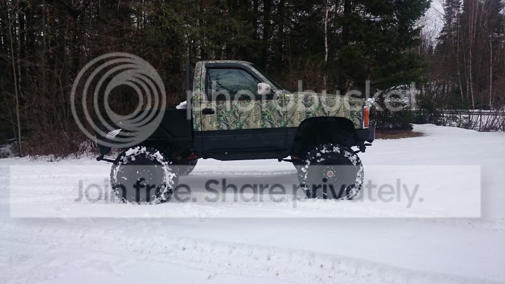

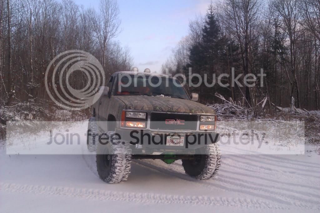

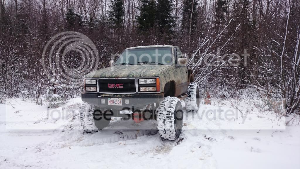

I had 3.5" back spaced 8" wide wheels for awhile, they looked good and I was getting compliments now and then about the look of the truck and it's stance.

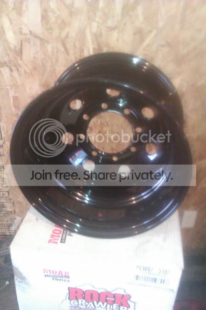

These are my 15x10 pro comp 8 lug wheels, I went with the 2.75" backspacing to help clear the ford dual piston calipers
What is the model name and part number for those? Do you know if they come in chrome? I've noticed with some of the pro comp steel wheels that it's impossible to find some that I've seen people have from a while back. I thought that maybe they make temporary runs and then discontinue some. I've never seen ones with 7 holes like yours. I like that look but I haven't seen those before and I've searched the Internet ALOT.
The part no was 87-5182. I just bought them a year ago from 4wheelparts and was no problem getting.
