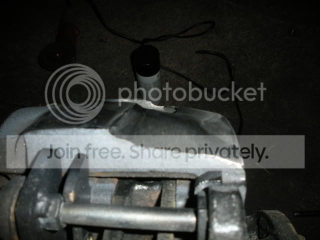

i run a 4.250 back spacing on mine with a 60.had to grind all 4 calipers and grind alot on the 60's
i actually cut my caliper bracket if you see it in that pic

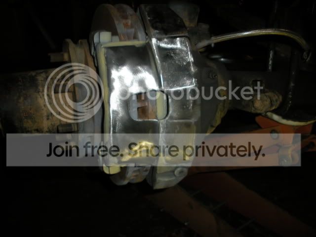

I ran 4.25" BS 15x10's on my 8-lug 10-bolt / 14FF combo. Not nearly as much grinding is required on a 10-bolt or D44 as compared to a D60. I ran that setup for years on the road (pre-trailer) and trails and never had an issue. When I went D60 front and converted the rear to disc I actually used the same ground down 10-bolt calipers for the rear. Bet I have 5+ years now on them.

Check my thread in the tech articles for an example of how much grinding is necessary.
