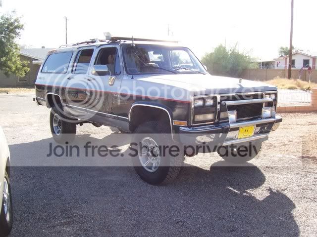

Here is mine with 16x10's on 315s, in my opinion 315's look better on 10's on these body styles.
