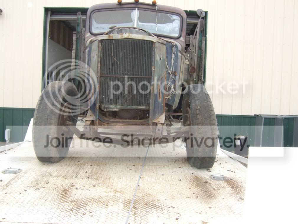

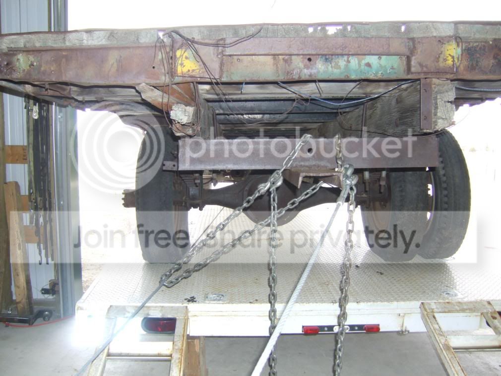

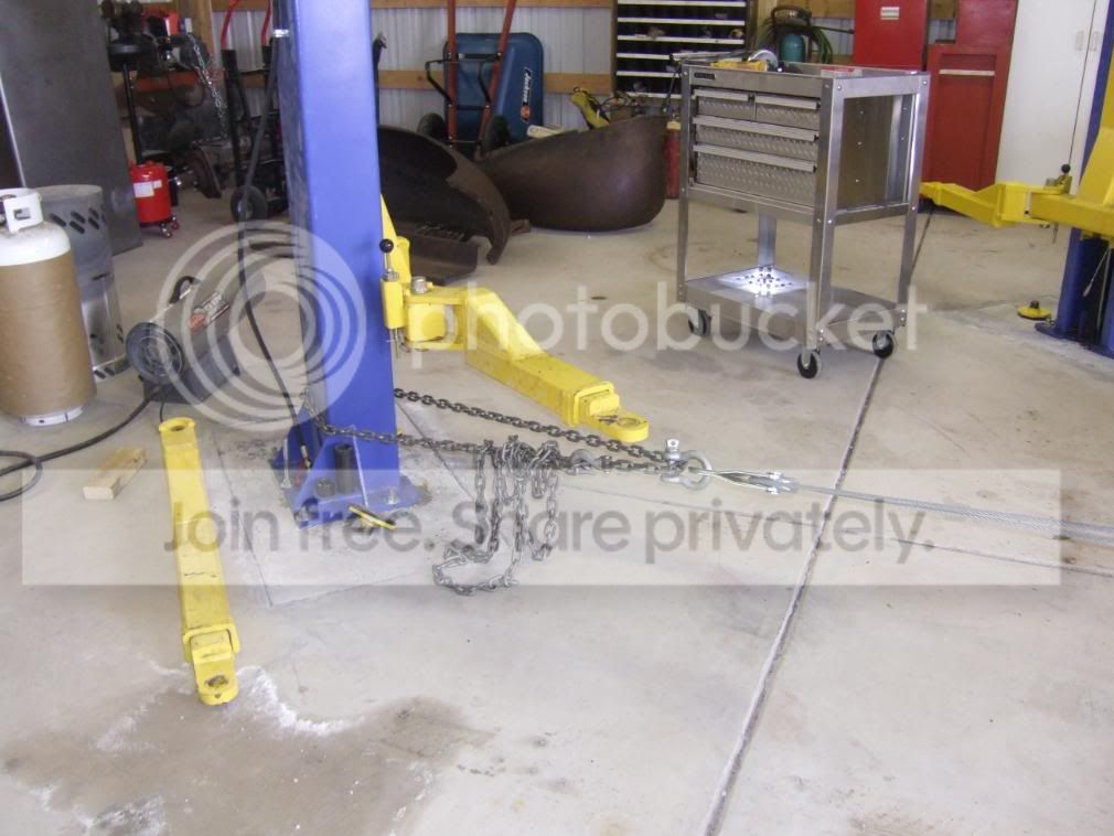

Work started last night on the tear down of the 39 donor truck. I can not believe that a 69 year old truck would unbolt. I have not had to get the plasma cutter out yet. It started as a complete truck. Hope to have the cab off by Sunday night.
First 2 pic's are of trying to winch the truck off of the trailer. It worked.

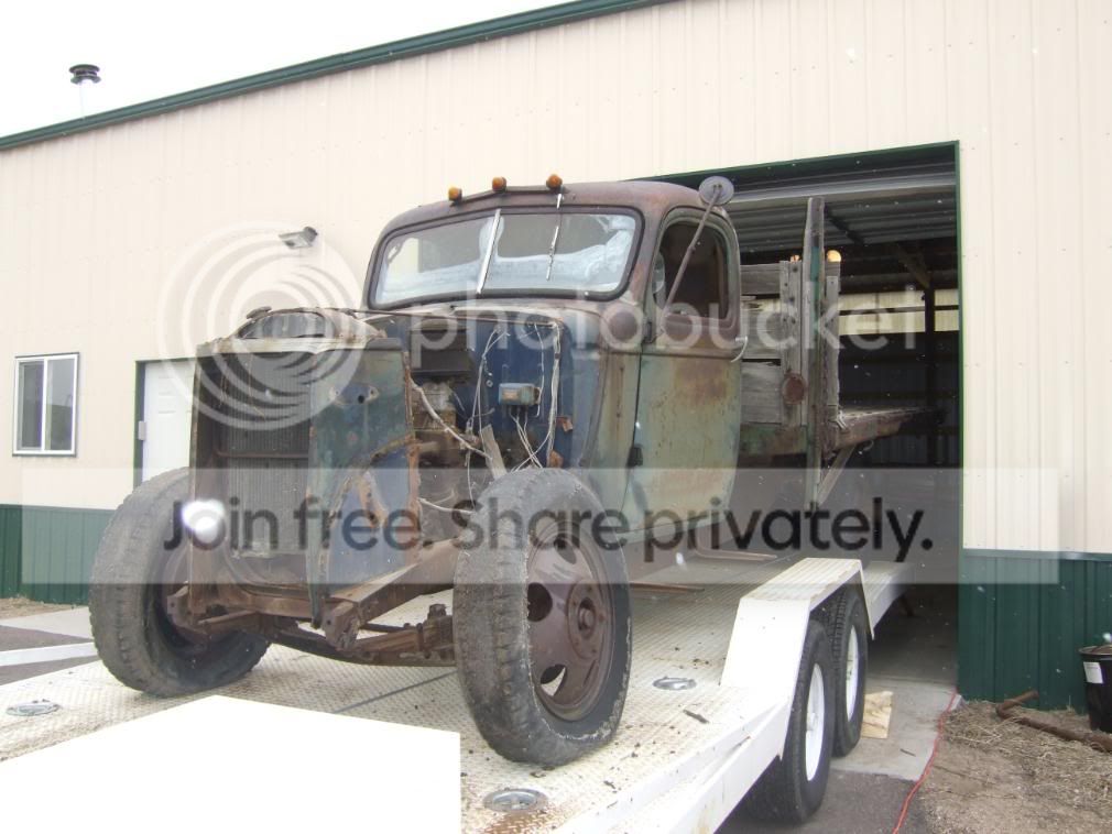

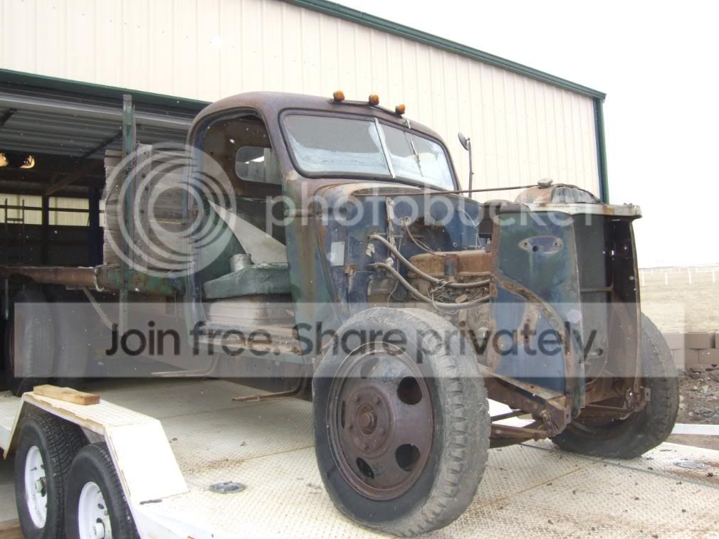

gotta love that cable operated mechanical (non hydro) brakes. Looks real good for a 69 year old rig.
Not sure what you're looking at. The Fords are what had mechanical brakes back in that vintage. I see rubber brake hoses up front. :confused:
