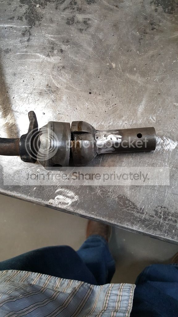

    The 66 has a horrible vibration thru the shifter so I decided to perform the classic fix for this.
    I started out welding the half sphere, stick, and collar together.
    [​IMG]
    You will notice the picture is taken after some grinding. The welds were quite ugly with the oil contamination. I suppose the ideal would be to give the stick a good cleaning and drying before welding.

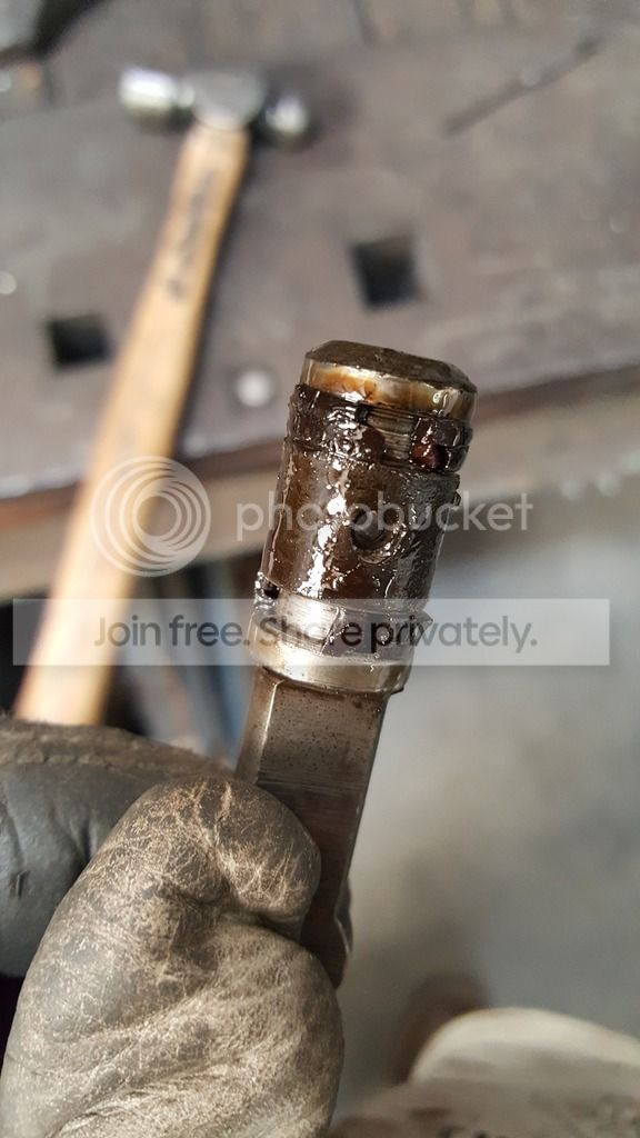

    I also pulled out the stub that engages the shift rails. You can see there were nylon rings in there to help dampen vibration but they are all busted up.

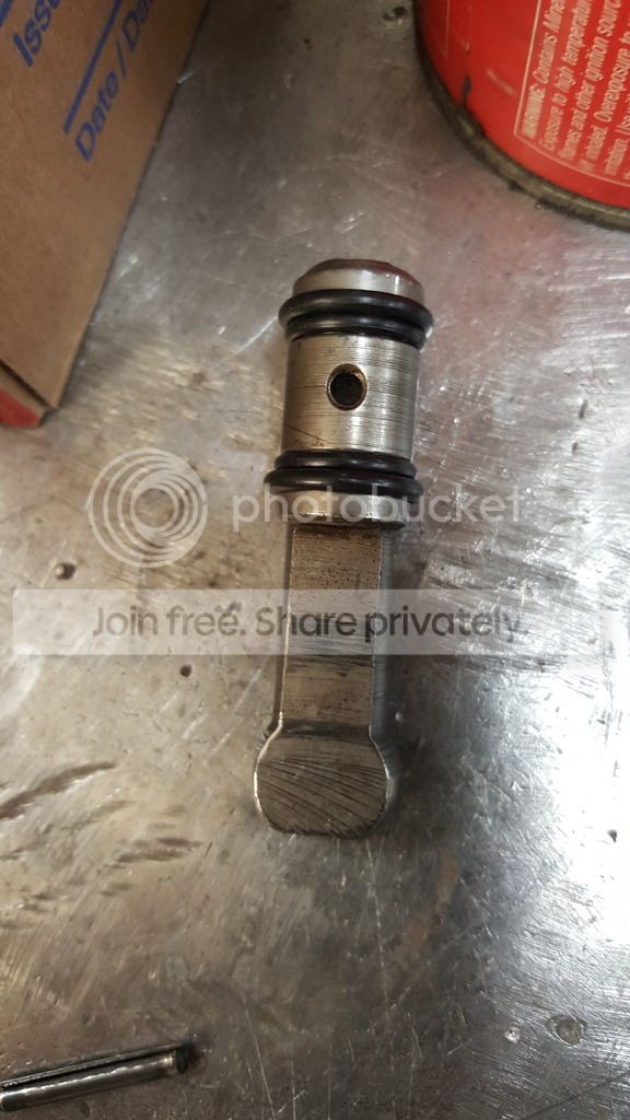

    [​IMG]
    I replaced them with 2 oring in each slot. 2 orings because I didn't have one that was thick enough to do the by itself.
    [​IMG]
    Made a big difference in the noise as in eliminated it. Also tightened up the stick. Glad I did it and really didn't take much more than an hour all said and done.
