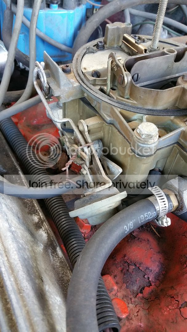

I need some guidance on getting the choke hooked up. Currently it's just wired open. It's the type that takes the manifold mounted choke stove deal. It doesn't have one on it. Will one off a 350 work? Or does it need to be for a big block?

I think a SBC coil setup will work with the BBC manifold if its set up for it....having the depression in the manifold and a screw mount for the tin cover...after that its getting the linkage working right to close the choke plate when cold (<50*) and opening fully as the engine warms up past 100*. have any pics of what you have now?

I'll take a pic tomorrow. It looks like it has the normal pad on the intake, I just don't know if they are the same for sbc and bbc.

What year is the engine? It's a 396 correct? Didn't some of the 60s stuff have the choke operate differently than the stove they used later?
I think the style that uses the coil spring deal had a square flat spot with a peg to locate it, and bolt hole in it. IIRC. It's been ten years almost since I've messed with a Qjet like that.

I can snap a pic of my 76 454 and show you what it should be like, just not sure if your intake and carb are compatible though. Can you get a better pic of the intake choke coil platform?
Yea I'll get a good shot today after work. I'll also try and get the numbers off the carb and motor so we can figure out exactly what I have going on.
