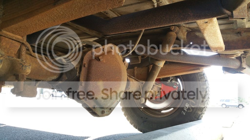

Rear disks do look nice. I always thought they looked puny after removing those giant drums.

smaller and work more effectively. gotta love advancements in technology. lol
I believe that in pure stopping power, properly set up 13" drums can outperform discs. It's the constancy of the discs that I like better.
I like drums. Would have kept them because they stop fine. But it's cheaper to convert to disk than to replace the drums, shoes and cylinders, which mine where junk.

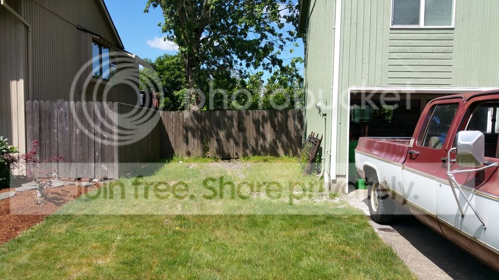

So I have been talking to the wife and a plan is confirmed. After the 4th, 90% of extra money and time is going to getting the crew painted before Halloween! I think I can do it. Not having ever painted a truck before, It might be tough, but there really isn't much body work to be done. I'm thinking about putting a lean to off the side of the garage and having that be my paint area. It's about a 15'x25' space which would be better than trying to paint it in my garage. That's still slightly up in the air, but is likely to happen. Either way, the crew shall be lookin good before long!
The space,

For a paint booth, you can use PVC pipe to make a frame and hang plastic sheeting over it. Add in a positive air flow with a filter and you are set.
Well I want to build a lean to off the side of the house anyway so I can have a spot under cover for one of the rigs during the winter. I figure I can just do that and then wrap it in plastic when it comes time to sand or spray. My neighbor is pretty cool so I'm sure I can tell him what's up and when I'll be doing what I'm doing and we can work out an arrangement.
