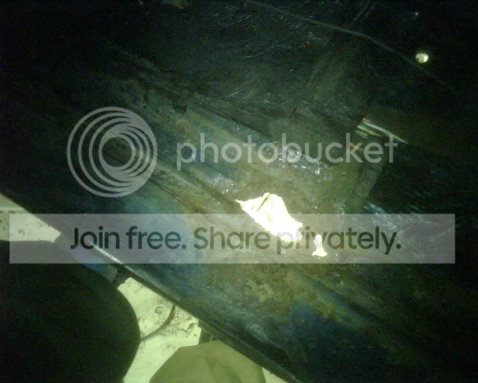

Hey guys, first post here. I have always wanted a blazer since I could drive and now finally have one. Problem is, its rusty. Let me know if you guys think its too far gone? It has a newere crate motor, rebuilt trans, and i paid 1700$ for it. It also has a tach! which i hear is pretty rare. Its a really strong truck but this rust :( Frame is solid, just the floor pans . . and under the doors on the body and the rear floor by the tailgate and the rear support for the tail gate. Also, whoever had it before tried to hide the rust so under this black paint there is some more rust we cant see.
right in front of rear wheel wells inside
This cross memeber looks pretty bad, how necessary is it to structural integrity?

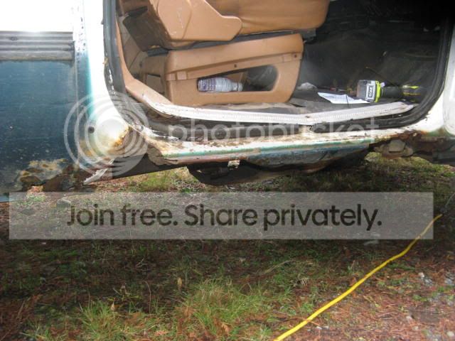

Actually, I should thank you for the pics. Even though yours is a different gen, its good enough. I am replacing that same rusted out corner in my truck. All I can say is, don't be afraid to cut wider. Salavaging as much of the 'original" isnt worth anything, because the edges are going to be too thin. Rust is like a bomb. The center is the worst, but as you move to the edges it gets better- however, it is still in the affected zone. You have to cut/repair all the way until you get to solid thick steel. That was my beginners error, and I spent a lot of hrs cutting "little bits" away.
In this pic:
you can see my rust issues.

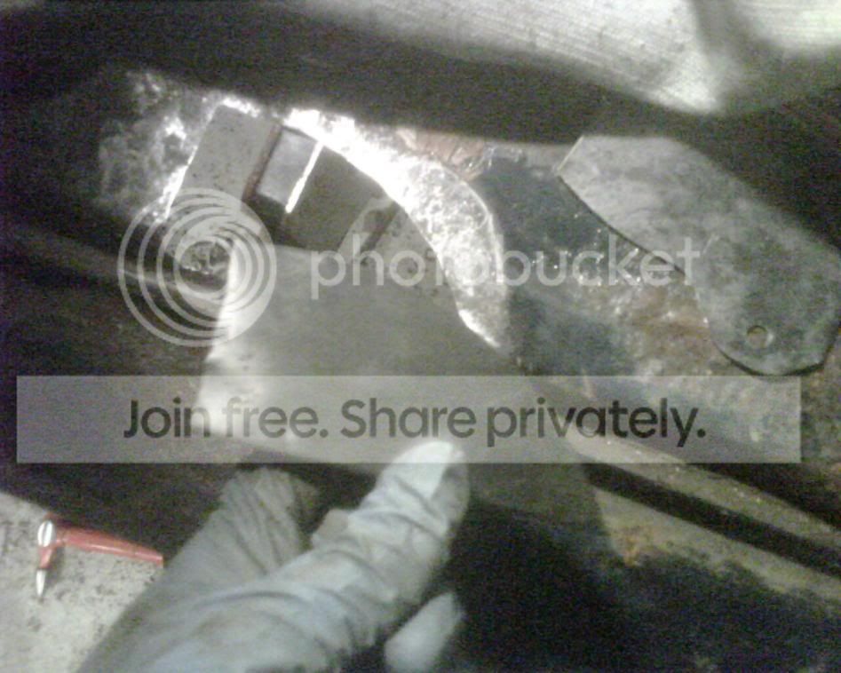

But what I didn't learn in the beginning is, make easy shapes. Not like this.
See that? DIFFICULT SHAPE!!! Also dont use stainless, its hard to bend. :)
The other thing is- you see that outer rocker? I ended up cutting it all off and replacing it and welding in new.
Dont be like me.
cut straight lines. No wibble wobbles or strange turns. THere are enough bends to deal with, dont add your own!

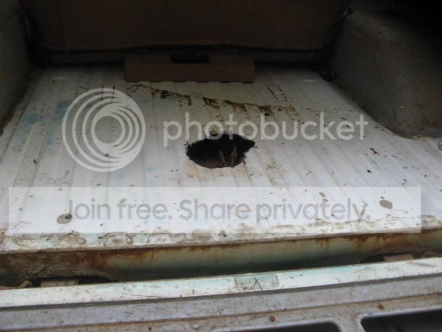

That's not bad at all, although I didn't see any rear floor/tailpan pics...
This is mine...
And I don't consider this to be a terminal case either...or I wouldn't have bought it. My rear floor is really good though.
It has some flaky paint and surface rust at the tailpan, plus an badly cut access hole for the fuel pump, other than that it's very solid and rust free back there.

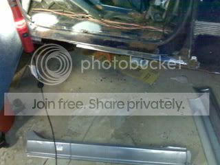

I find the key is to not try to save every tiny piece of the original truck when replacing sheet metal. It doesn't save any time at all. Here is my rear quarter repair.

that aint bad man.you got more sheetmetal left than i do.some of that looks like surface rust.you may be able to just clean it up good and if youre using rust bullet it will strengthen up those areas a lot from the writeup i read on people using it.interior you could clean up and put new metal then herculine to keep the rust away.that crossmember looks like the one that goes under the rear seats.it is structural and helps to keep the rear from falling through when people sit on the rear bench seat.good find and a good price also.:wink1:
