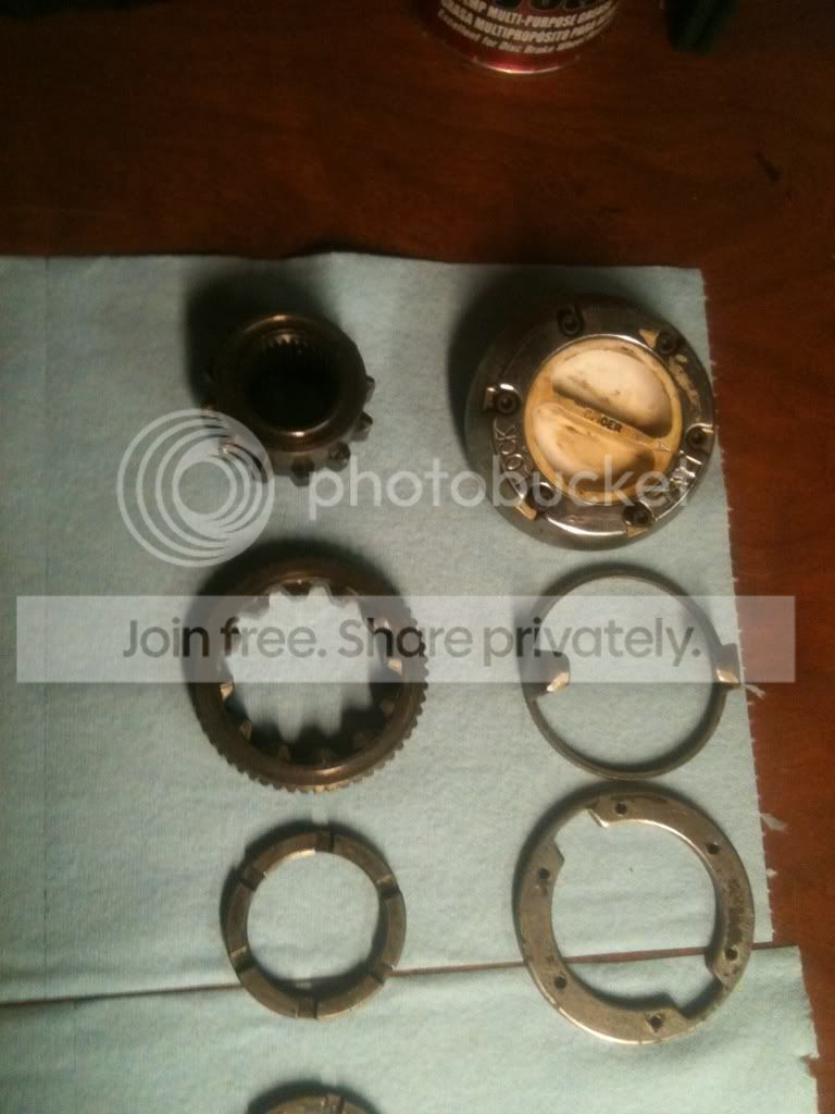

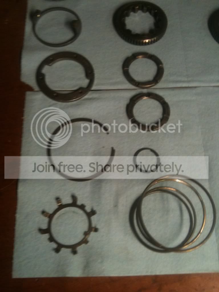

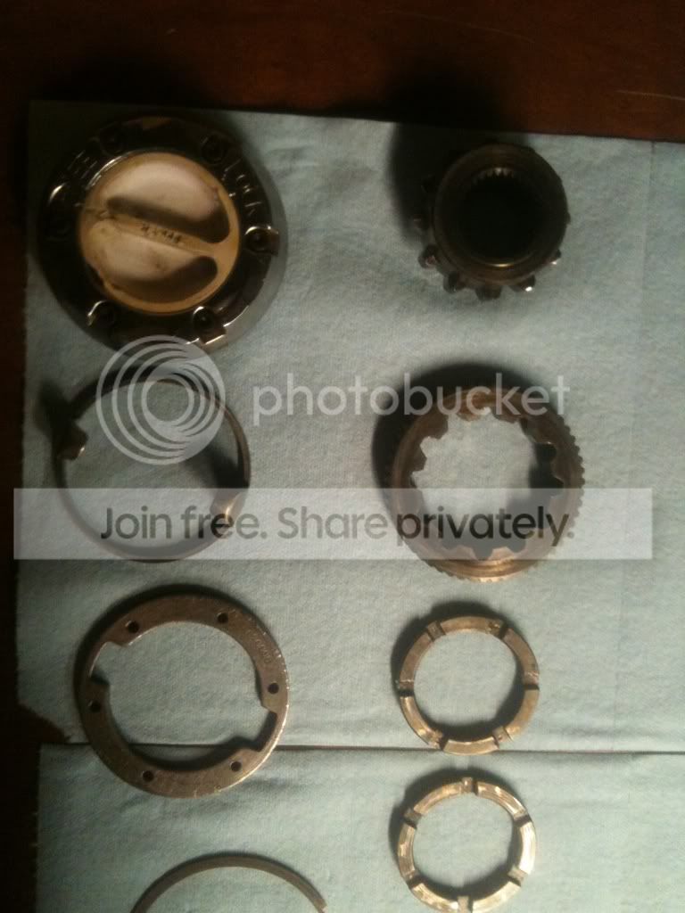

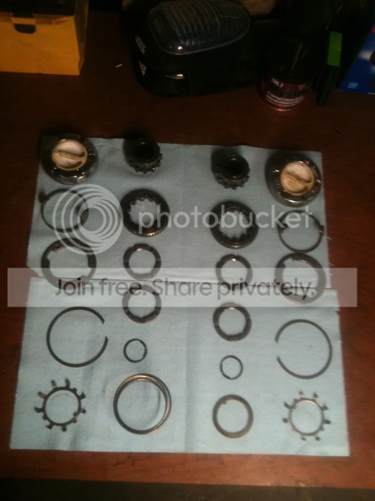

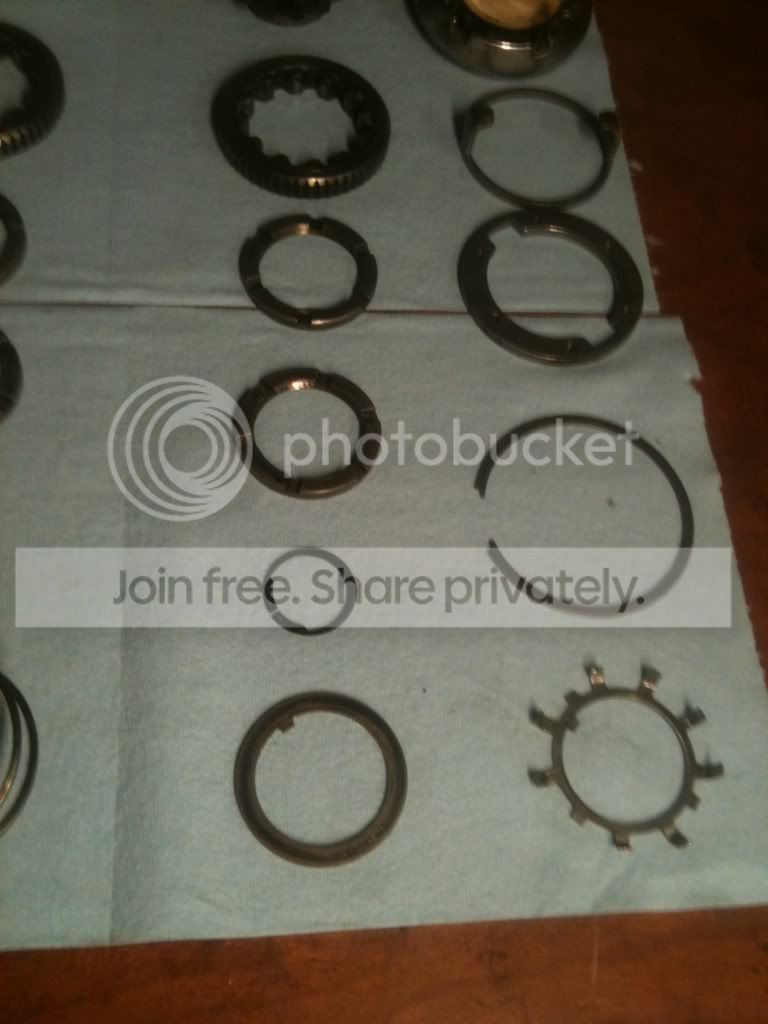

So with my axle came a greasy parts bag. It's a spicer 30 spline setup
What am I missing?
Having never opened an operable hub setup how does it all go together
What and where do I need to complete this setup
And is it worth using this with my stock 30 splines or just wait to use the 35 spline setup
bump for eyes to see.
from just cleaning up the parts i see i only have 1 spring, and 1 of the little flat plate with the knob on it. (both parts in middle rows on bottom)
I bet if you were to put it all back in that greasy bag and throw it at the wall long enough everything would just pop right into place and the extra peices may even show up too...:whistle:
Ive taken mine apart a few times, and nothing looks the same so i gots no idea, sorry.
Wish I could give you the exact answer but my D60 is a dodge unit with external lock outs...yuck!
might try looking at the pirate4x4 Dana 60 bible... I feel like I seen an exploded view of the hub assembly there
edit* kind of hard to make out but they have an exploded view of both hub types on page 1
http://pirate4x4.com/tech/billavista/60_front/
You kno I stared at that pic looking for something else which it didn't show. Completely forgot to look for this problem lol. Thanks

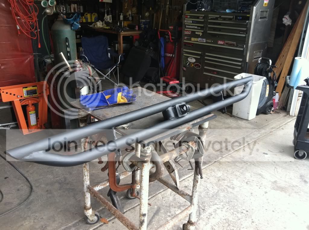

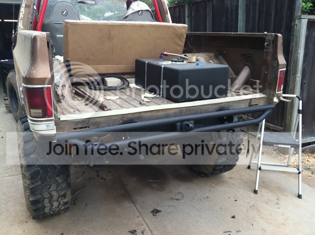

So since I have a harbor china tube kinker and Ive got my buddies big welder and some ol pipe I got for free decided to build myself a bumper.
That looks nice man. I got that same "Pipe" bender. Did you use it on pipe or tubing?
I like that a lot, actually. Simple, yet effective. I might be referring back to this in the future.
Pretty sure it's just poop pipe. Got it for free from my work
Thanks. Actually my wife told me how she wanted it. It's not perfect since I just used the calibrated eye ball to build it. But as long as the frame can hold up and the welds on the receiver hold up I'll be happy
