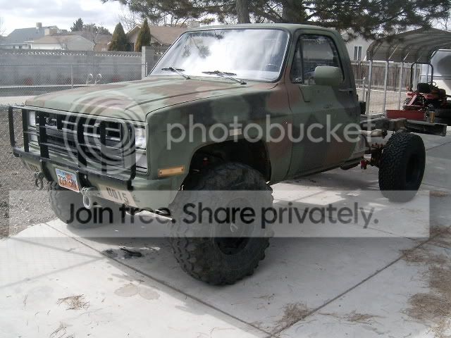

1986 M1008 Rebuild
I think the next oportunity I get to work on it I will;
Move the fuel tank on top of the frame rails behind the cab.
Craft up a diy shackle flip.
Take it wheeling:D
Looks good. How soon you going to tube it out? I did the same thing with my cucv, took the bed off and moved the front axle up a foot or so. Still havent tubed out the rear tho, I hate how it looks. Once I get my turbo on Im going to tube it out. I look forward to see what you do.
Do you have any pictures of your truggy:DAnd are you running full hydrolic steering in the front with your axle so far foward?
Not sure on the tube yet, I have a bender but no dies yet. Also I'm gonna bring the rear in about a foot and move the front out about 4" so I may wait on the tube until the wheelbase is set.
Haha sorry Im about to pass out and cant type, I ment to say that I moved the REAR axle a foot forward. Yeah my front axle is only 4" forward. Ill get some pictures tomorrow.

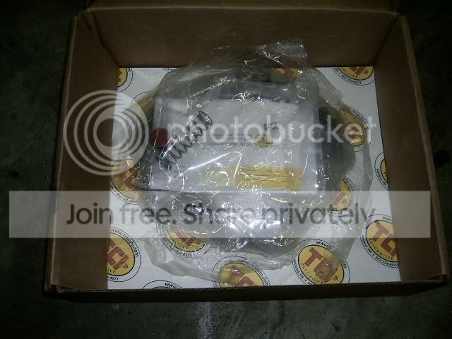

more parts have arrived:D

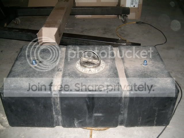

70.00 used jazz fuel cell
Full manual reverse pattern valve body never used

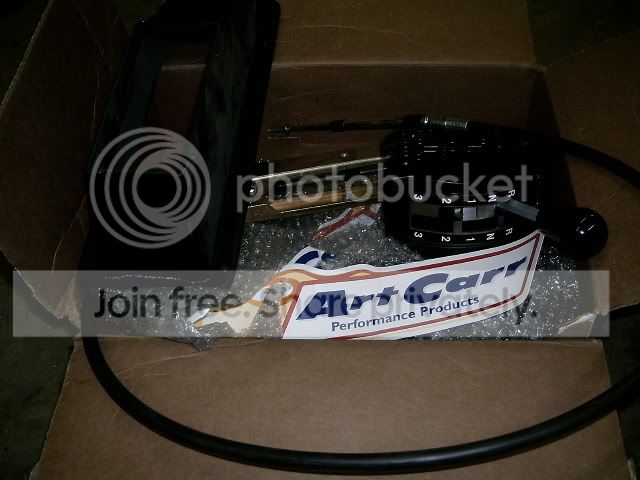

Never used shifter

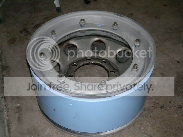

Re-centered H1 wheels with pressed centers, o-rings, valve stems and pvc for 660.00 shipped:D

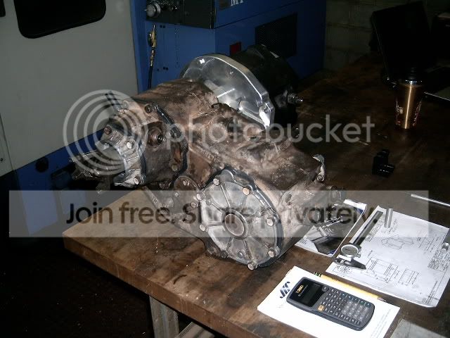

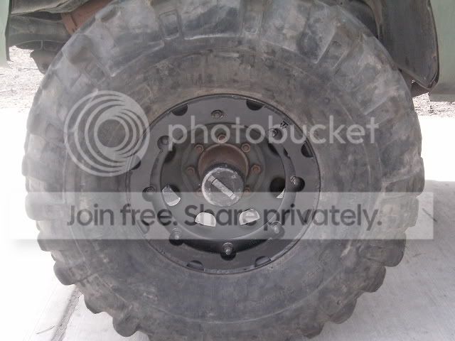

Welded a 3/8 rod on the inside of the rim bead and the rock gaurds on the outside:D Plus a picture of my doubler to be.

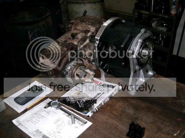

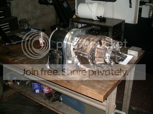

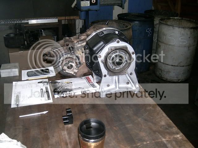

More progress:DThe doubler adaptor is a clone of the ORD version that I bought and it now has a Ford 32 spline front output and the Ford rear output for my slip yoke elimnator:DOh and ground the shift rod for front digs!
Still have to build some shifters and 2 more wheels but it's coming along:D
I also need to come up with a new shift collar for the 203 and weld in a fill port in the 203 acess cover oh and get ahold of some 1350 yokes front and rear:D
Here is the collar I need so pm me if you have anything i could get cheap:D
Hey David unless you are getting 1350 yolks for a great price consider going 1410, the 1410 allows alot more angle before binding. You can get the 60 yoke from the rear of a newer dodge 70, I don't think there is a stock 1410 app for the 14b.
Although the yoke for the 1410 from the 70 uses straps, I got my straps at car quest and they are spicer parts and beefy, I don't think I will need to worry about them
Yeah if I buy new I'll sure look into it but I'm trying to find some used ones locally first.
