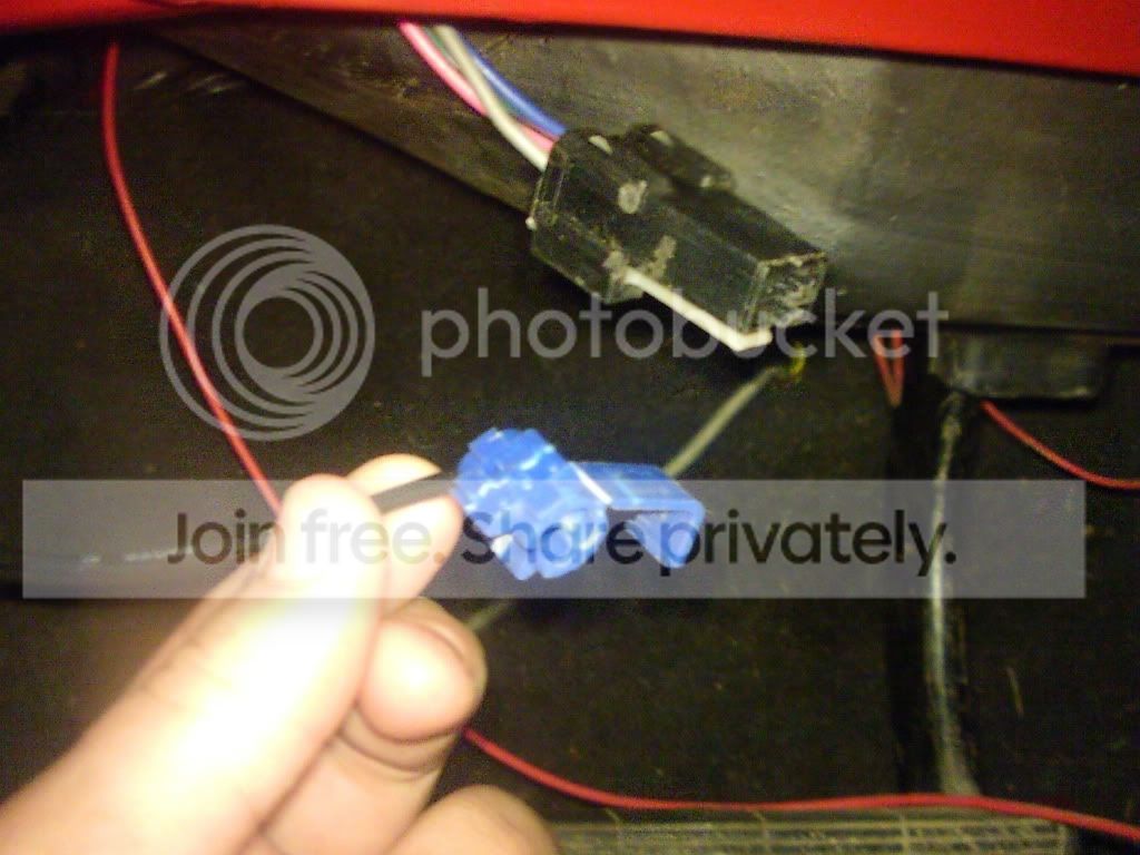

ok i just replaced my steering column wich pretty much fixed all my light problems but when i turn my high beams on my dash lights start flickering and all four headlights start flickering also and after i finished putting in the new steering column in i had 3 wires left over one black wire with a weird flat connector on the end a wire with a weird blue plastic piece on the end of it and then a wire with a black plug on the end of it if you need pictures of these wires let me know. thanks for any help

That blue thing is a scotch lock, not original to the truck. Looks like someone tapped that wire into something. Follow that wire, find out where it goes. Just a guess but it looks like a ground wire for an aftermarket radio or other similar aftermarket add on. Usually the factory wires don't have printing on them.
The other square plug with multi wires and the flat tab on it looks like it goes to a cruise control module.
ok haha i actually was fartin around in my garage last night and i happend to come across a package of those blue connector things and then i was ooooooooohh so thats just someone elses **** under there but last night i was playin with the headlights again and the low beams are flawless but when i turn high beams on they just wont stay steady, they are trying to but something is holding them back and the dash lights flicker with them too. its making me crazy cause ive never had all 4 lights on and for less than half a second they were all on and bright but then went back to flickering
