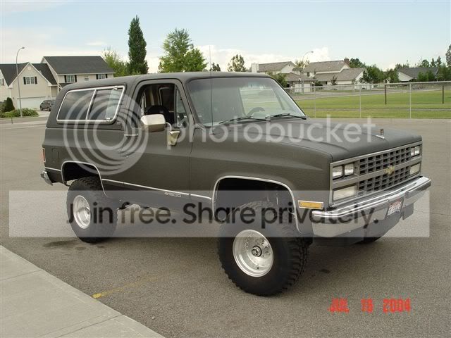

She has come a long way, but there is still a lot to do.
She now has a bullet proof shell of bedliner head to toe, 3" lift, 33" BFG's now on 15x10 wheels and Freightliner Bucket seats.
Now it is time for new engine, trans, axel (at least rear) and steering.
It spends a lot of time on the road going to and from very mild off-road adventures. I also tow a drift boat and 4wheeler trailer with it. So I want and engine that will keep it going 75mph with a load. I also spend a lot of days just idleing round hay fields shooting ground squirels. So I need something that isn't going to over heat. I want a rear axle that is the same width as the front so I can get rid of the 1.5" spacers on either side and I want to get rid of the slop in the steering. This isn't a hardcore rock crawler. Just rig to go tool around the hills in.
SO! I want input on what engine/trans combo, axel and steering parts I need. What parts would you use and where would you get them. I want everything new.
