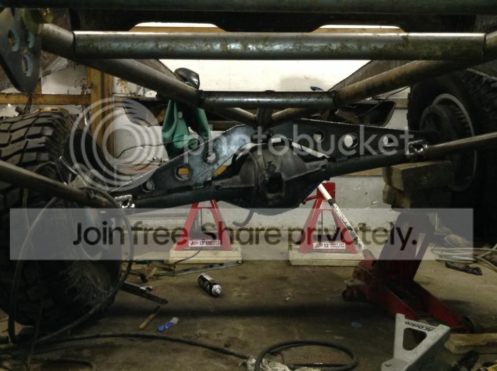

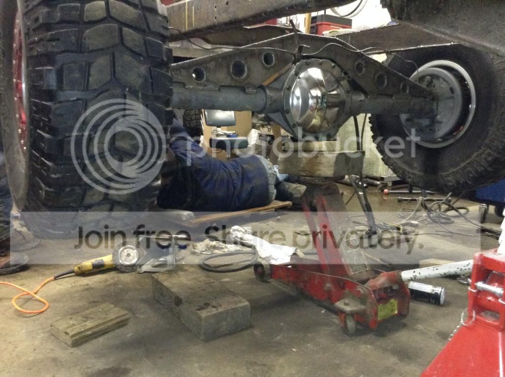

rear axle
Rear axle sand blasted and fast etched and ready for truss when its done. To come 4.10 gears in rear eaton e locker and brake rebuild

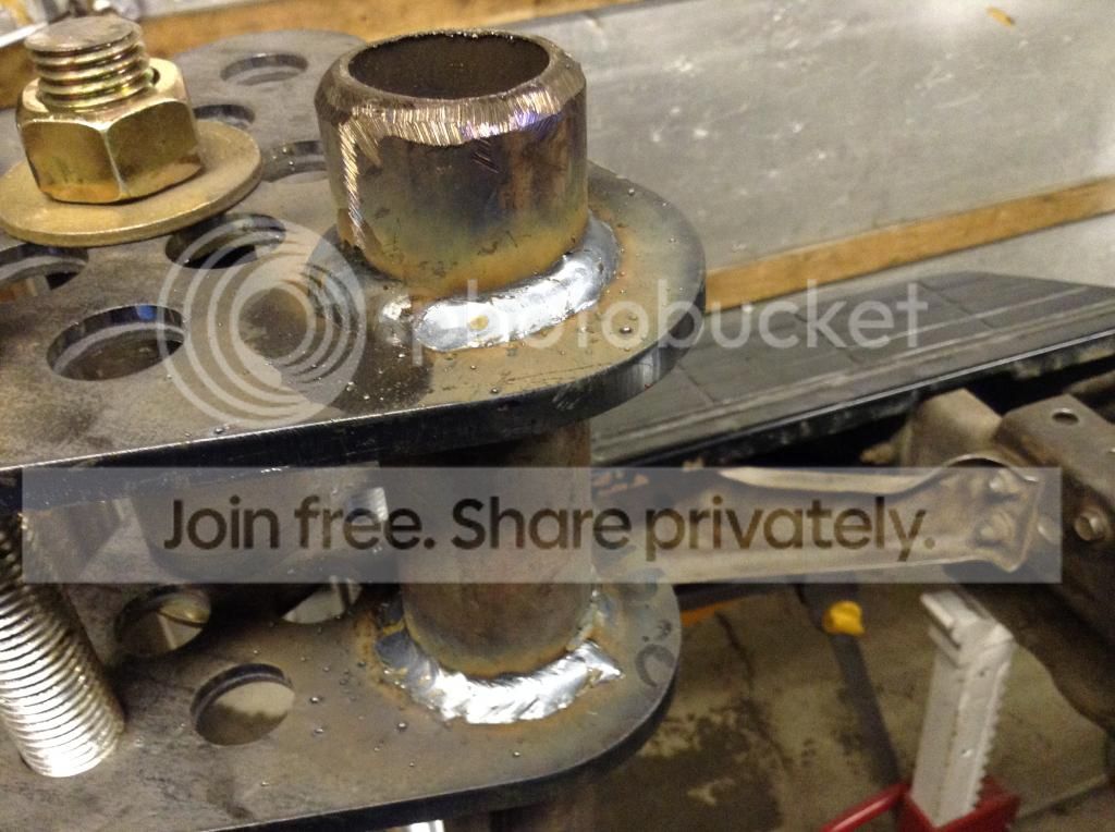

Gonna have these upper mounts cut that I just drew up.
The front 5 holes are on a 47.5" radius which is the length of the wishbone. So should be able to adjust without even turning the heim in or out.
Holes are 1" and tube hole is 2".

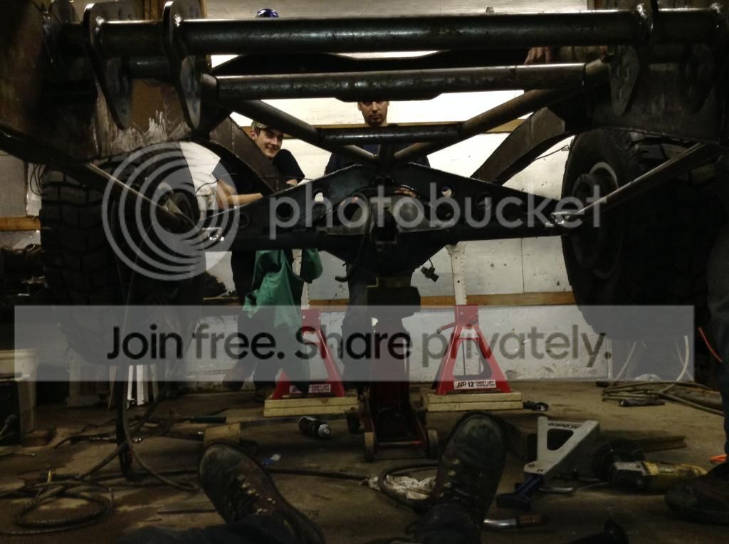

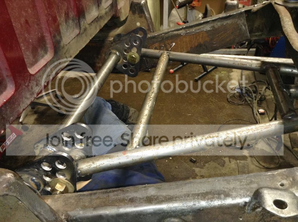

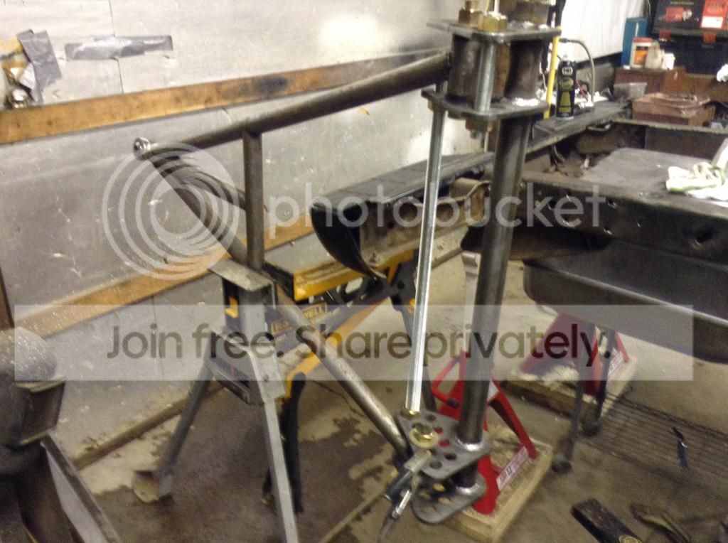

Wishbone mock up.
Can't get over the sexiness of those brackets lol

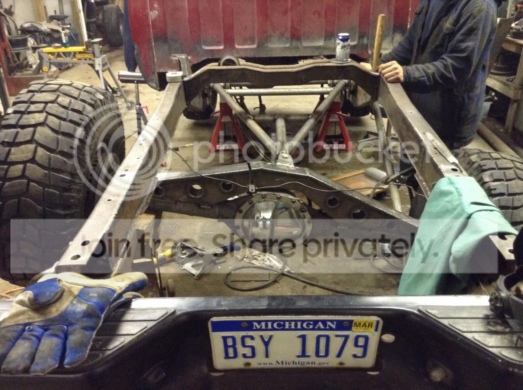

:thumb: the rear works just like I designed it
Stock driveshaft even fits perfect :bow:
****ing saweet.

Thanks dude. Kind of my first try on any of this. Im glad I have hook ups to cut the plasma stuff out. I think the brackets and trusses turned out awesome and really make it DIY and super clean :D
Idk if I mentioned that the lower frame bolts are 1-1/4 in diameter, and the wishbone upper bolts are 1". Delron bushings in 2" .250 wall tubing at the frame mounts. 1-1/4" lower hiems.
Crazy overkill lol. 1-1/4 shank bolts are like serious rock bouncer/ KOH territory. Plenty of guys have no issues with 9/16ths and 5/8s lol.
We call ourselves Overkill Kustomz. (its spray painted all over the garage lol).
Nothing legit (yet) but we do tend to make stuff overkill :haha:
