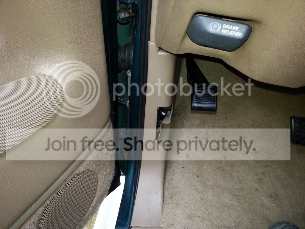

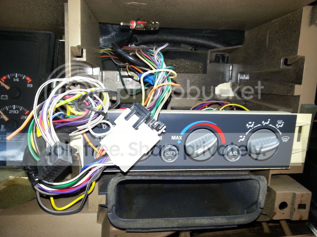

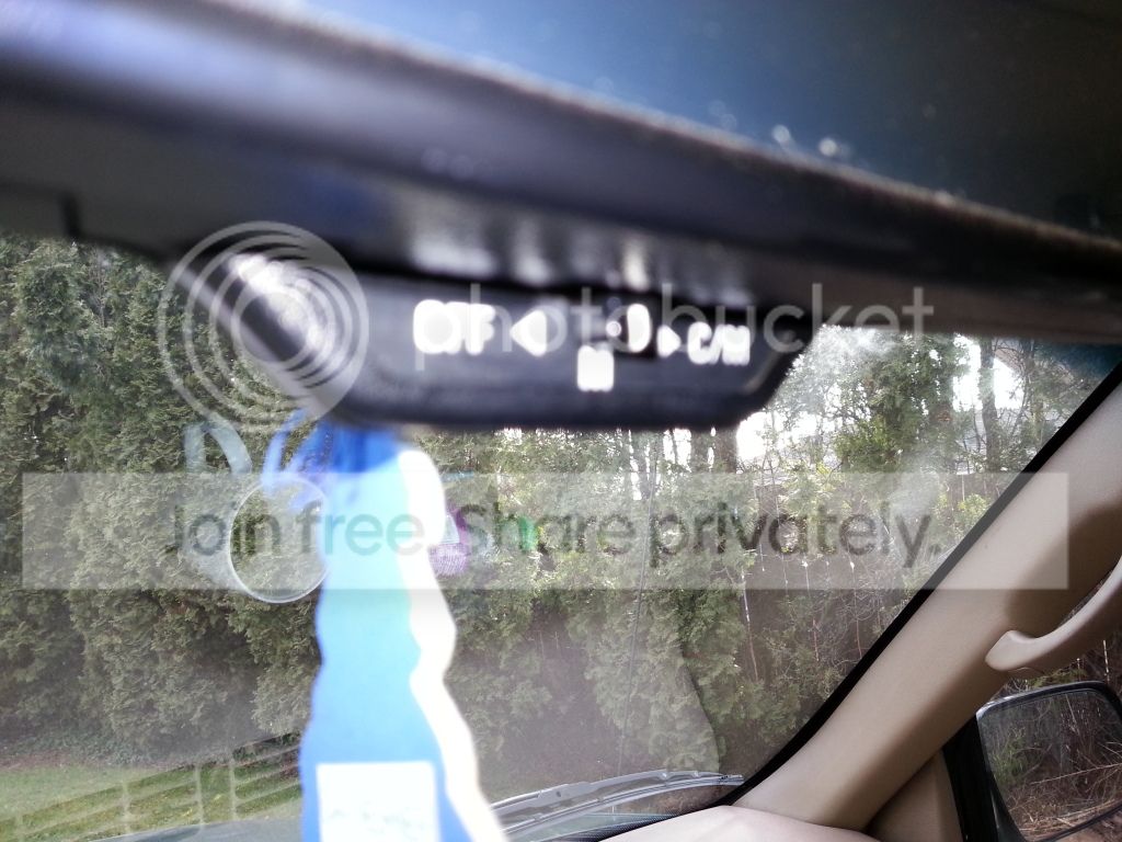

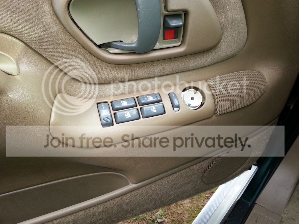

Ok, now here are my first two questions, what does the M and CM mean on the mirror,

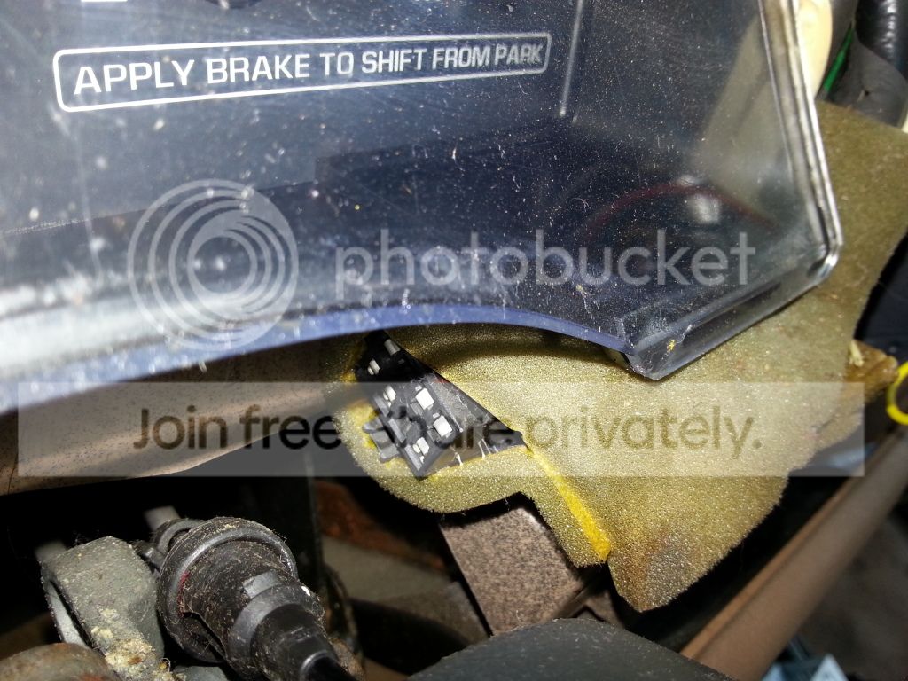

And what do these wires go to?

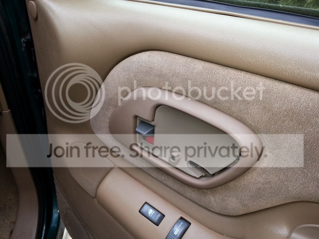

whats sad is how many issues identically my 95 has

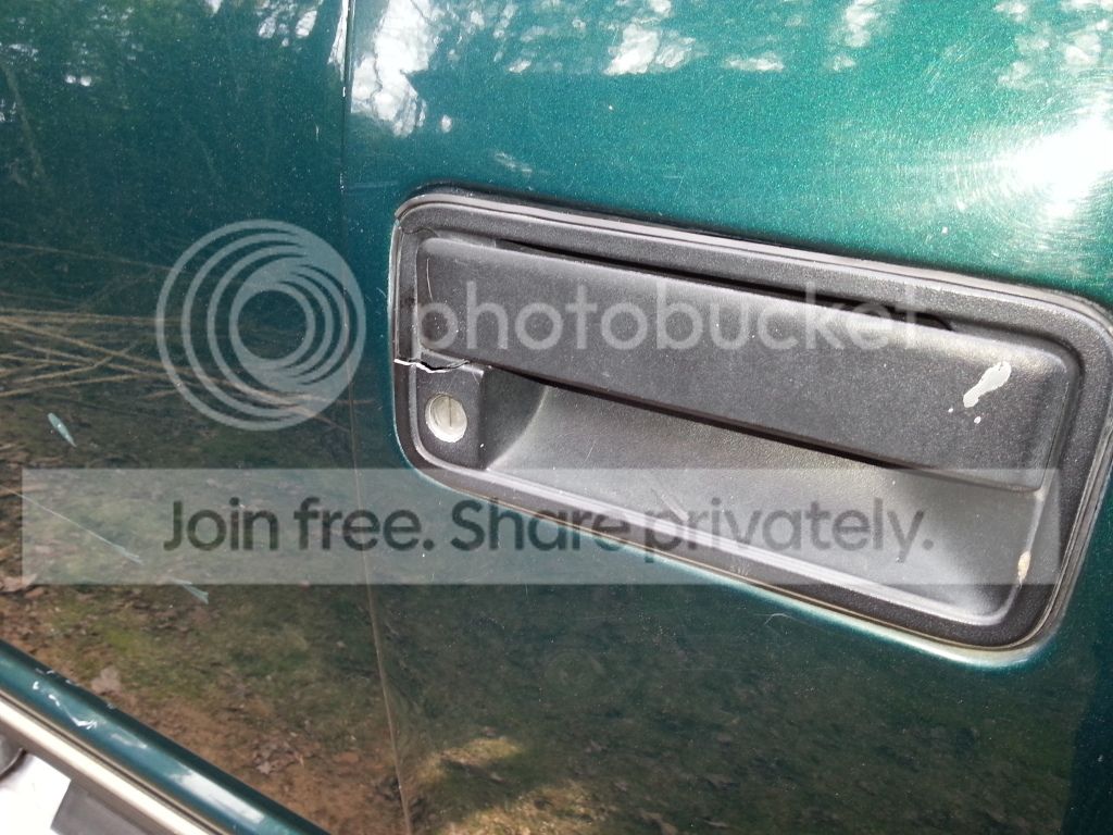

exterior door handle broken in same spot by key hole
interior door handle broken off (just get one from rockauto, $8 + shipping)

The C on the mirror is compass and the M is the auto darkening.
Kerts SAS kit makes impressive lift. Just be sure you replace your front rear spring hangars with truck ones. They are built different and provide more lift.
Those wires under your gauge cluster don't plug into anything. My
95 burb had them there too. Must be for some factory options we don't have.

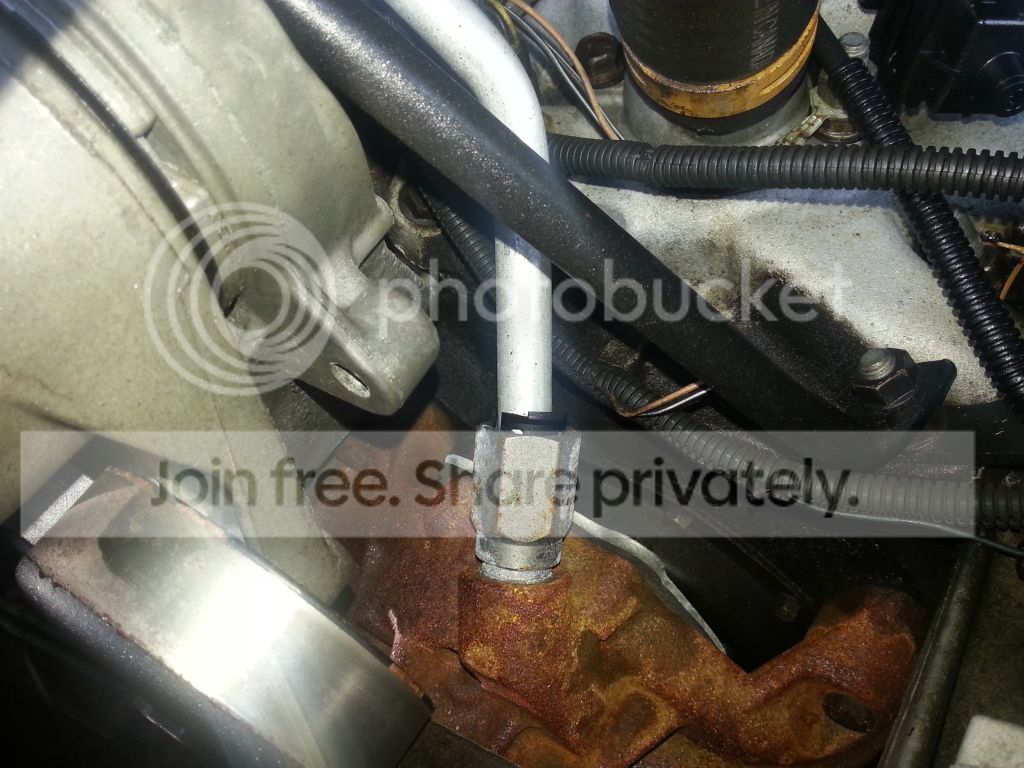

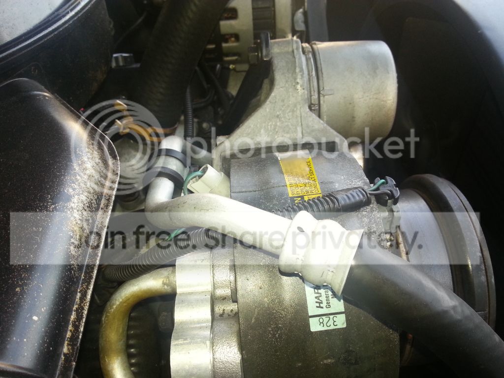

This is what the fittings look like. ONe in the water pump and one in the intake near the distributor. They need to be swapped for normal barbed fittings.
GRP-15637g_1
And this is what the hoses look like. the ends just snap into place in the fitings and are o-ring sealed. Sounds like a good idea until they start corroding and leaking.

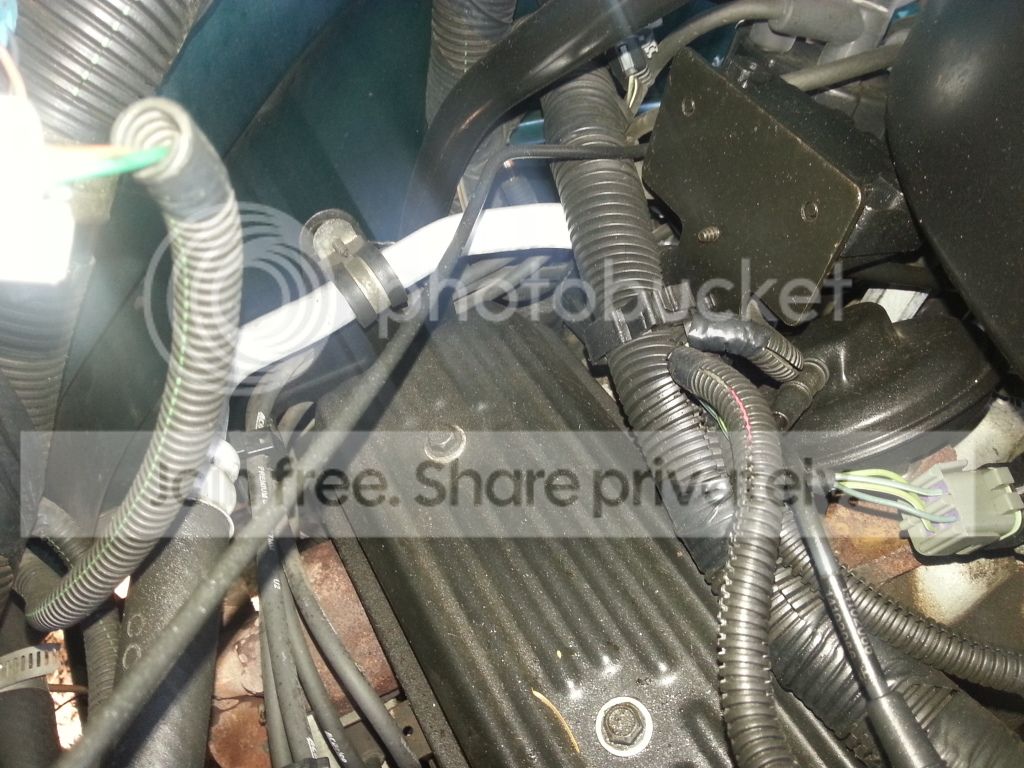

Ok, here is the one coming out of the pump,
It goes up and over the ac compressor to this bracket and then goes into a soft line.

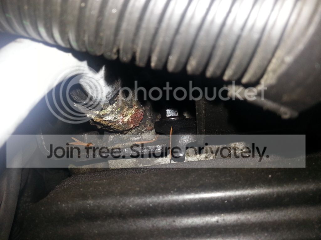

And this is the one at the back of the intake. As you can see, it appears to be leaking already...
It goes over to this bracket before going into the soft line.
The heater inlet is just normal hose clamp style. I plan on getting larger ruber lined hose "mounts" to replace the ones that mount the hard lines now to keep the hoses properly routed. I just need the barbed fittings. We talked about this here once upon a time, but i need to do some searching to remember what sizes i need.

ok perfect.
you summed it up perfectly and i know that i do in fact have those so now i know to keep an eye on it.
:waytogo:
I have just never liked the design so im doing away with them.
