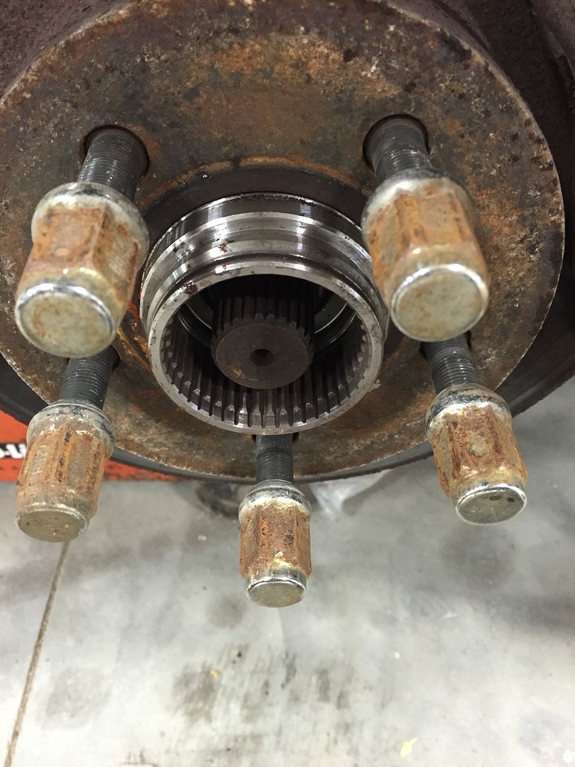

I have a "cutomer" rig that I am working on. It is a 1999 Ford Ranger. What is the best lockout hub for the cheapest price, and the cheapest place to buy it?
How does it work with no holes to attach the hub to?
Martin
Video shows how it is attached. Looks pretty sketchy to me. Little plastic snap on doohicky.

I have a set of manual lockouts from a 1st-gen explorer (should fit that era of Ranger) (Warn, IIRC). They slide in over the hub and are held in place on the lugs by the rim. But 99 is a couple half-generations removed from that. I have no idea whether they would work. I'm pretty sure I'd be the cheapest place you could buy them from, though. :whistle:
http://www.amazon.com/AVM-Hubs-99-01-Ford-Ranger/dp/B0039H9PE8
Apparently they make one that bypasses the stupid snap and utilizes the lug studs to hold it on for a bit more.
http://www.summitracing.com/parts/mmk-428/overview/make/ford/model/ranger
Snap on hubs was sure a surprise to me.
Those are for the older TTB axles. Won't work on a '99.
http://www.ranger-forums.com/engine-drivetrain-122/how-avm-hub-install-version-2-a-104560/
Install instructions.
