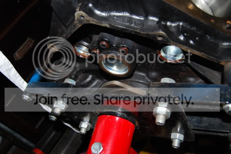

Uhh, no idea, lol. Can you tell from this picture?

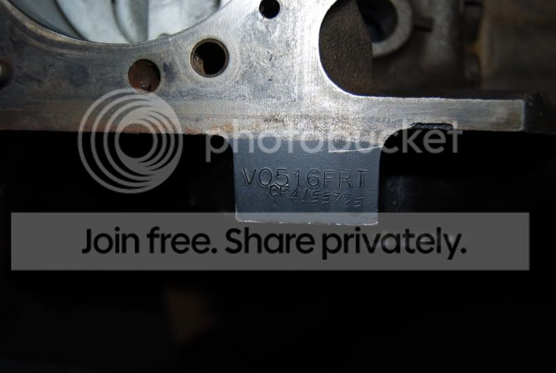

The code says its a 80-85 block, so does that auto mean 2 piece??
Looks like a 2 piece to me.

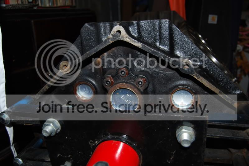

But take a pic from the bottom rear of the engine so we can see it better.

Also can you get a pic of the actual casting numbers on the top of the block by the left head??
The easiest way to tell a 1 piece rear seal engine is just look at the end of the crank, if it's a full round it's a 1 piece, if it has a flange offset then it's a 2 piece seal.
Yea, its definantly a two piece, can tell by the crank now that I know what im looking at.
