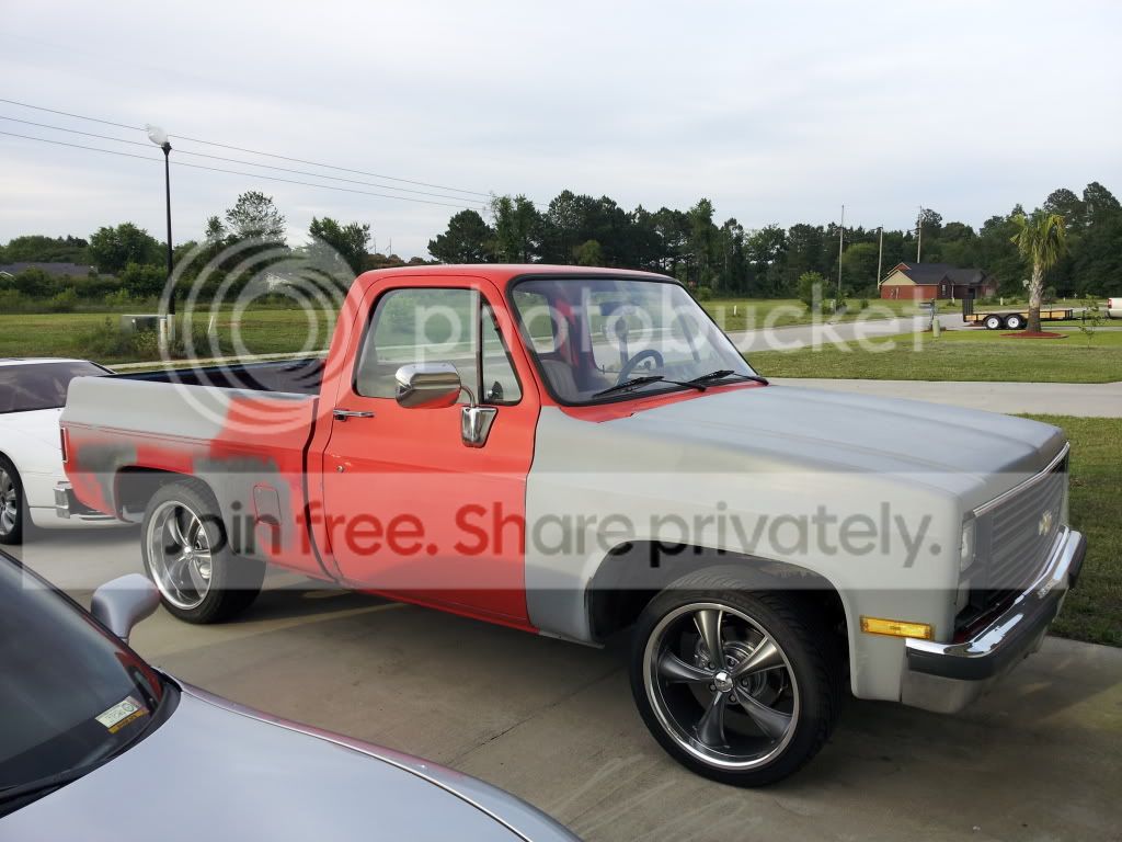

got the replacement cab in the shop today and did a little tourch time on 3 broken / cut / frozen bolts got them out just fine :D
then cut off wheel / flap wheel 40 grit grinder / some measuring and fitting and went from rusted out cab corners to nice and solid cab corners. and 1 tiny patch in left rocker next to cab corner seam line to rocker.
few more pics.
right side was not as bad as left was. but had small bubble little higher up on back side that wasnt threw yet but i could see from inside so cut him little higher up than left.
also as you can see few spot weld holes drilled to match factory style . and had to trim the back side of both repair panels as the body line was off 1/4" to wide to the center of the cab. would have looked funny. so i cut it off and rebent the flare / lip just like factory.
last few for today .
next time fix right cab / cowl area little patch needed . and weld shut the ash tray door and also the fuel tank switch hole. also few extra holes i dont need.
