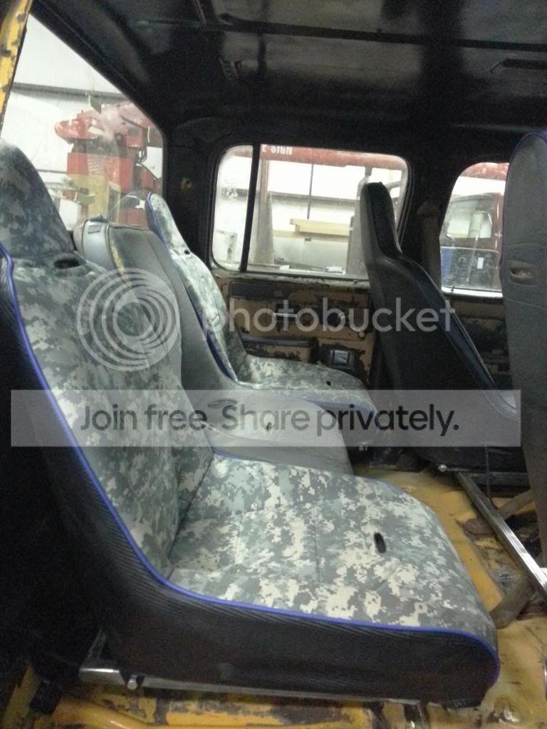

Broke out the measuring tape. My baja SS seats are 22" wide each. EMPI kids suspension seat is 15" wide and a K10 cab I have sitting here is 66" to the door jam. fits with room to spare. Can anyone share a picture if they have one of one setup?
Don't know if it's much help, but here's a pic of my rear seats.
