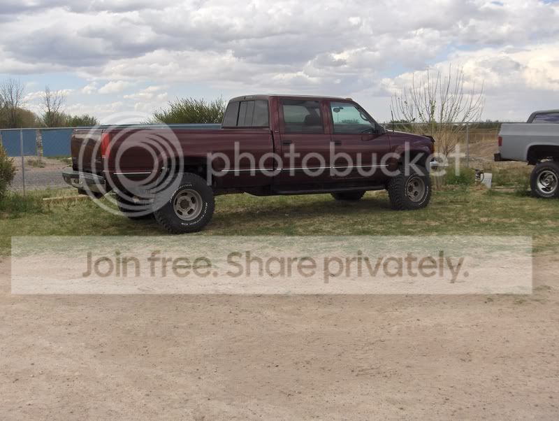

looks good. my 03 is already cranked up with rear shocks that has coil spring on it. might get leveling kit for it too. maybe half inch to one inch body lift. tires are 265 75 16s i dont like it.. heres the pic
thats not bad at all! i actually like it a lot. most of the silverados i see with hardly any lift and 33's look kinda crappy (they have wheel spacers so the tires stick all the way out.) but they are skinny!

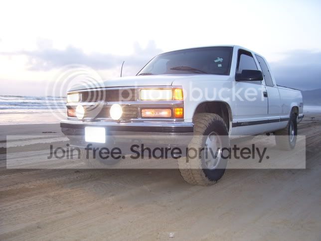

heres my dads 97 gmc
has 3" bl and a 2" leveling kit on 35/12.5/16.5

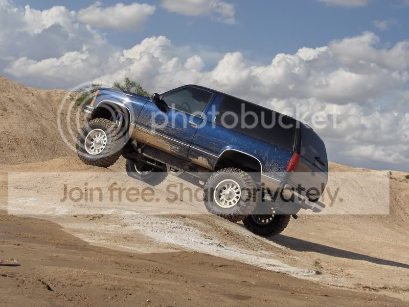

and my friends 99 tahoe
with a 3"bl and a 6" suspnsion
has 38/13.5/18

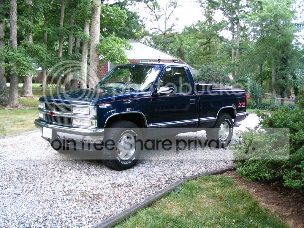

I fit 305/70s on stock rims on my 97 Z with a slight crank and minimal rubbing on the LCA at full lock. It makes all the difference if you keep your stock rims... lot's of bs and pretty narrow. Please don't buy a "leveling kit" for your truck, it's a waste of money. Just buy some Ford keys and perhaps some heavier duty bars and call it a day.
Here is a shot of my 97:
Nice lookin truck man
