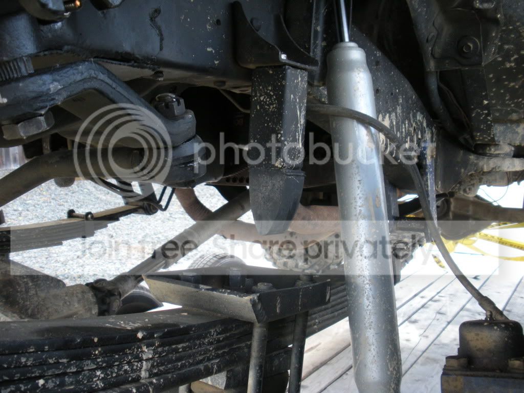

Those of you running 52" front springs, how do you have your front shocks setup? How much compression travel vs. droop travel? Are you happy with it?
I have mine set up about 5" up and 10" down on the shocks. I bumpstopped uptravel though to keep the springs from going negative. Honestly my pass side could use a limit strap to prevent the 1310 joint from binding.
I don't have the shocks mounted. But by measuring the comp is 2" from the factory bump. The extension is 11" or close. My 52's have no load spring.
