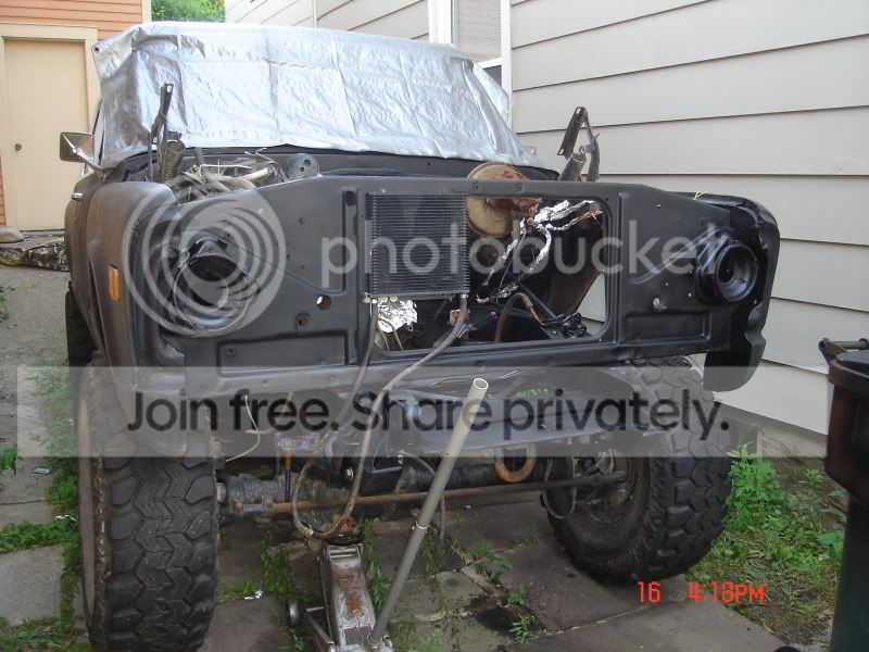

I have a 71 blazer, and was in your shoes a few years ago. I put in one tons a while back, but wanted more flex.
I ended up doing crossover steering, hydro assist, and 52's.
The only regret I have is not getting the front drive shaft done right the first time. The 52's flex like MAD. More droop than you can imagine, and even though I have a long slip, it pulled it apart twice on 2 hills.

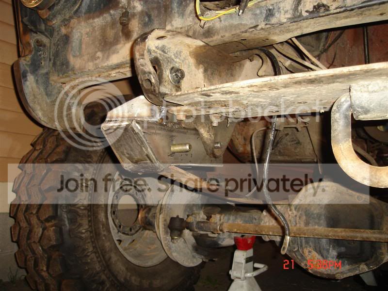

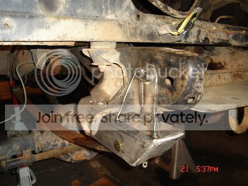

I am uber cheap, and build most of what I can. I built front buckets to hold the 52's, I made them so nothing had to be cut off the frame, and the factory shackle location is used.
I pulled a 2wd sector shaft from a 95 2WD truck. Worked fine. Drilled my 71 box myself, had a local hydro shop make the hoses, and bought a ram from a surplus company.
I have ZERO complaints on road, run 37's with no blocks. It might help that I have 6 inch skyjacker lift springs in the back. They are pretty stiff, but I tow a 4000lb boat with it sometimes and my buddies car hauler with his HEEP on it.
The 52's were from a chevy van I believe. Used from a junk yard.
Also had to use ford shock towers in the front. I wouldn't go back to the stock springs at all.
OH, and I have a ramsey 9000lb winch behind the grill. Put that in way back when I still had a D44 up front.

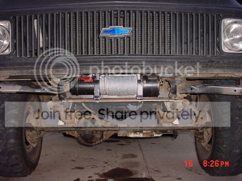

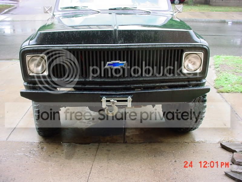

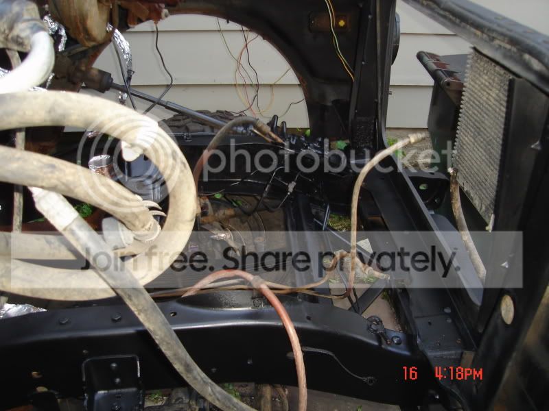

Here's some pics.
those pictures are extremely helpful garlicbreath. Thanks. Could I get a close up of your winch mount and maybe your crossover?
My plan for the winch is to keep the stock bumper, with rollers sticking out.

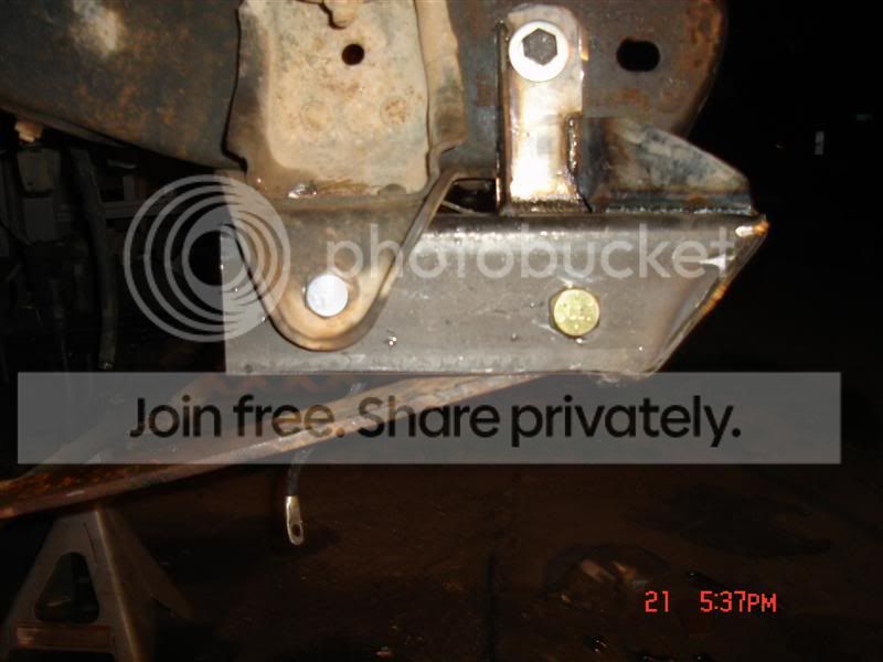

I wish I had better pics of the fab and install. The truck is currently in storage on a car hauler waiting for me to move back to colorado.
Here is what I DO have.
It's all 3/16 steel. Plate for winch mount, tabs welded on for mounting around factory shackle hanger, the back is bolted to the bottom of the U channel, and the U chanel is triangulated to the frame. I messed up the factory crossmember that is normally at the back of the 2 angles pieces, so I made this to serve double duty.
My only regret is design of the winch engagement lever and location makes it a tad difficult to get to. But I got a smokin deal on the winch, and it has worked every time.
