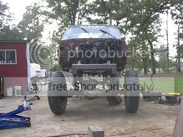

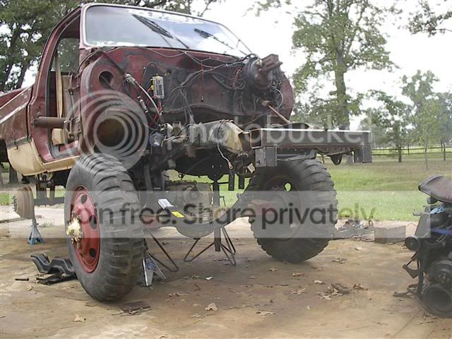

Here you can see how I mounted them. Basically I just chopped the front of the frame off so that it would be straight and I added the 4X4 1/4" wall square tubing. THen I just built the front springs hangers and the springs in the front are mounted at the same height as that factory mount just moved forward about 3"s.

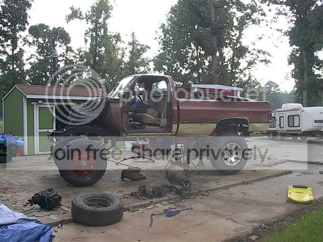

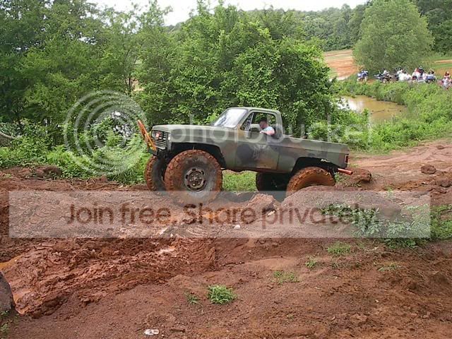

Just for reference that is a 40" tire on the truck.

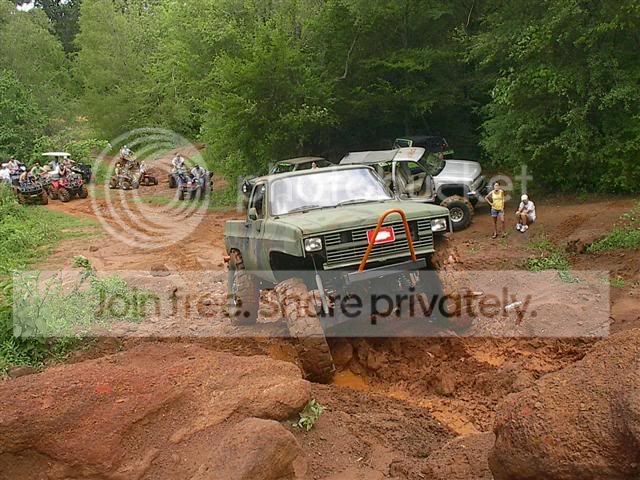

Also all those pics were taken before I removed the lower leaf and it settled a bit. Basically when it is all said and done I want to be sitting about the same if not a bit lower than this truck. The tires that are on this truck are the ones that I am gonna be using.
