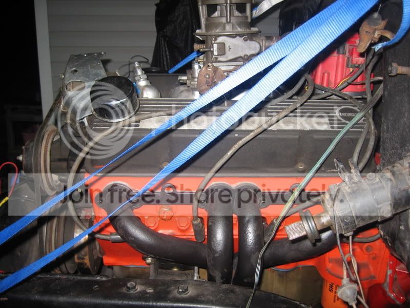

I'm not sure what headers mine are off of, but were the only ones to fit out of three sets I had...mainly because of the boxed frame. But long tubes hung down way toooo low, another set of shorties did not fit on the passenger side...and then found some off a '76 FJ40 we have with a SBC...I'm planning on routing the exhaust under the pan from the passenger side to the driver side and then singling a single tube all the way back...
