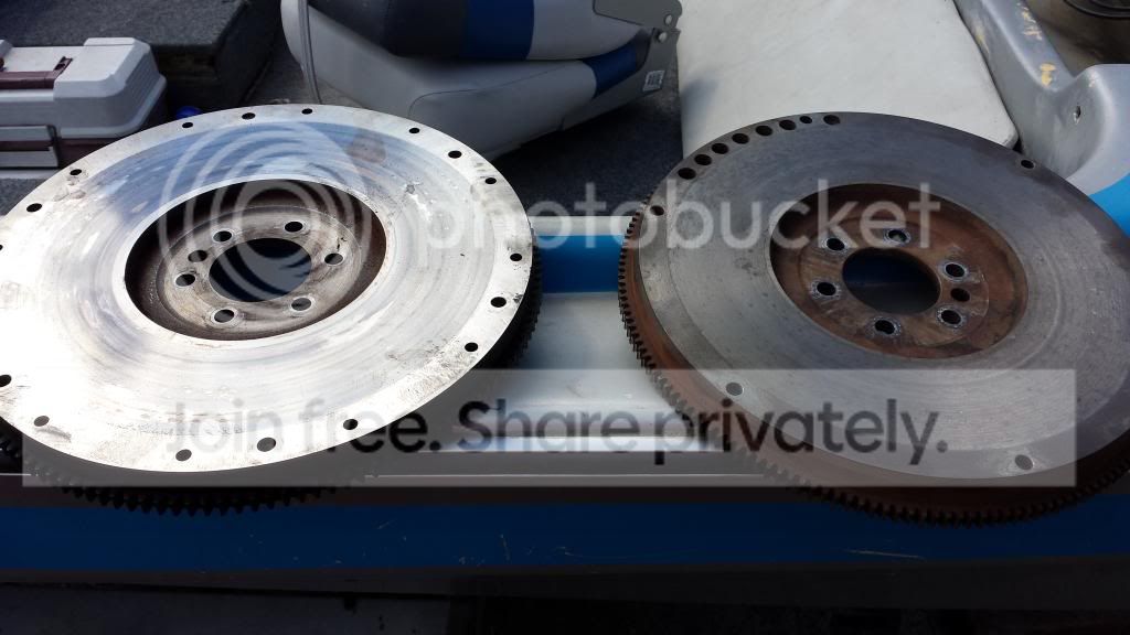

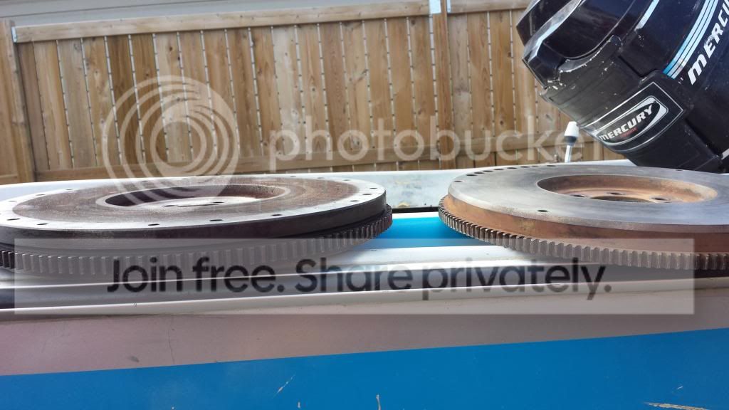

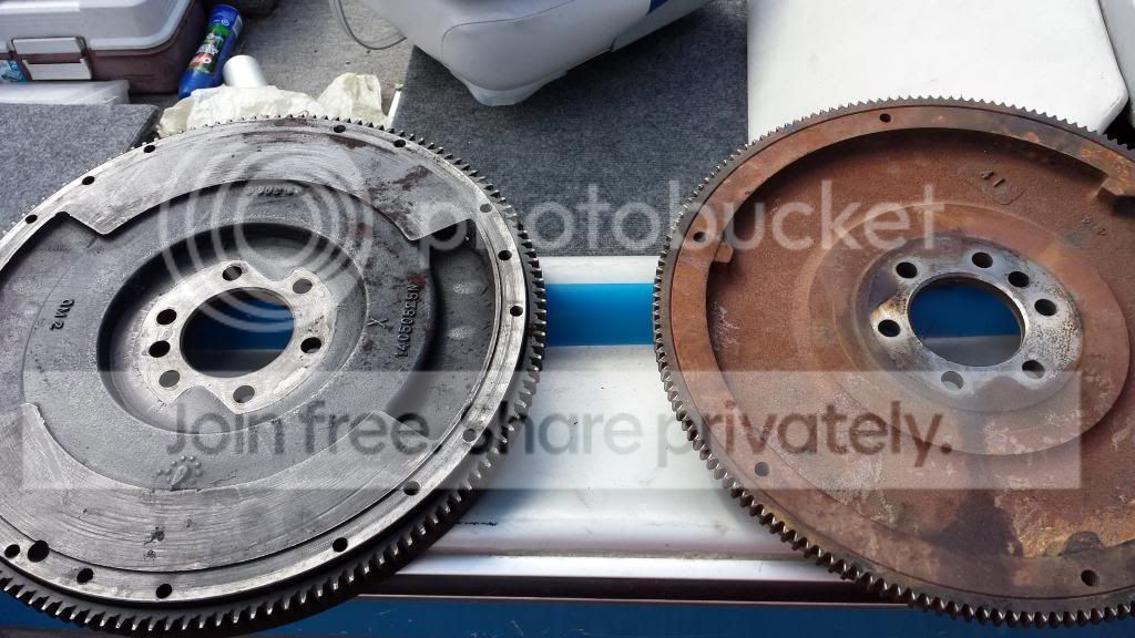

Ok here's the side by side. In all these pics the 6.2 flywheel is on the left.
Friction surface:
Side profile. Not not only the thickness but that there's probably 1/8" of material or so behind the starter ring on the diesel flywheel.
Backside. See how much more material, and it's got to be twice the weight.
