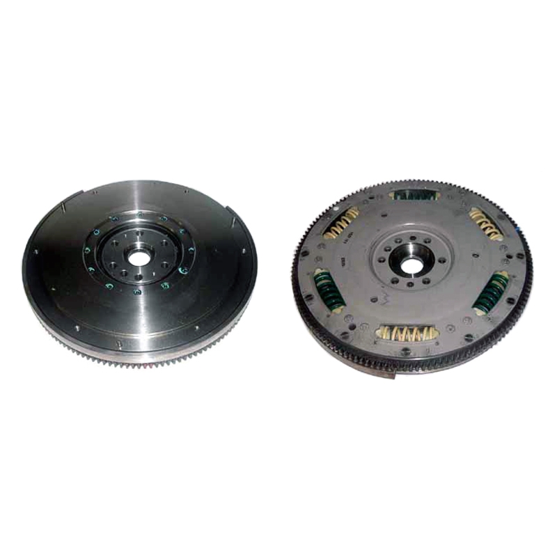

I also think they had a "dual mass" flywheel ,and later replaced it with a "normal" style after many failed,but I may be thinking of 6.5 diesels..

The dual-mass flywheels were used on early 6.5 engines to reduce the shuttering that these engines produce when first letting up on the clutch pedal. It's an NVH reduction.
The springs were prone to failure, leaving the outer flywheel free to slam back and forth against the spring stops, making a terrible clatter at idle speed and probably contributing to the snapped crankshaft reputation.
Those ones are much harder to find, and the last price I saw was $600. But why would you want one? :dunno:
