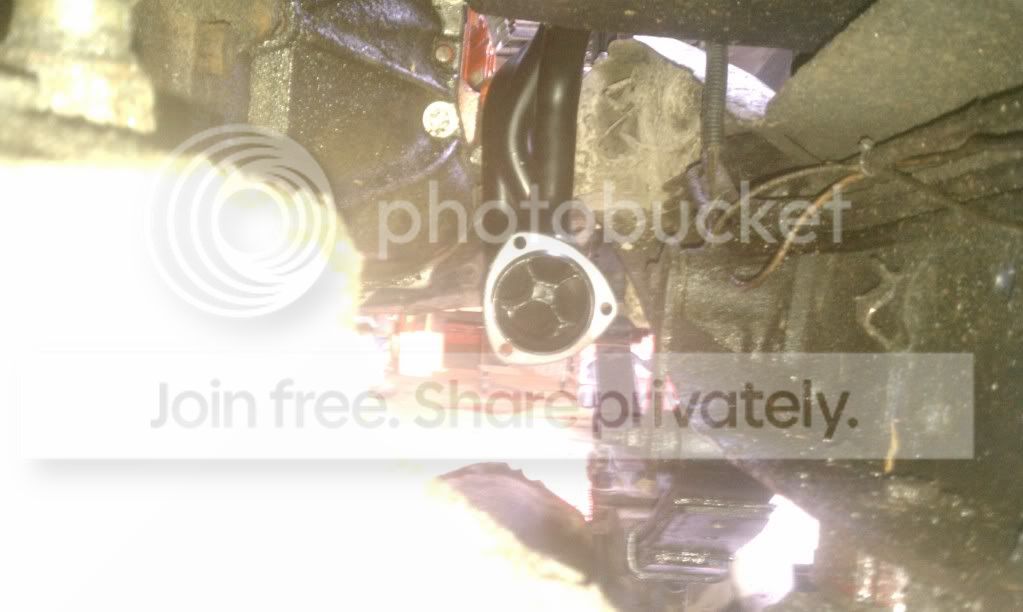

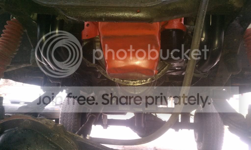

From the front looking back.

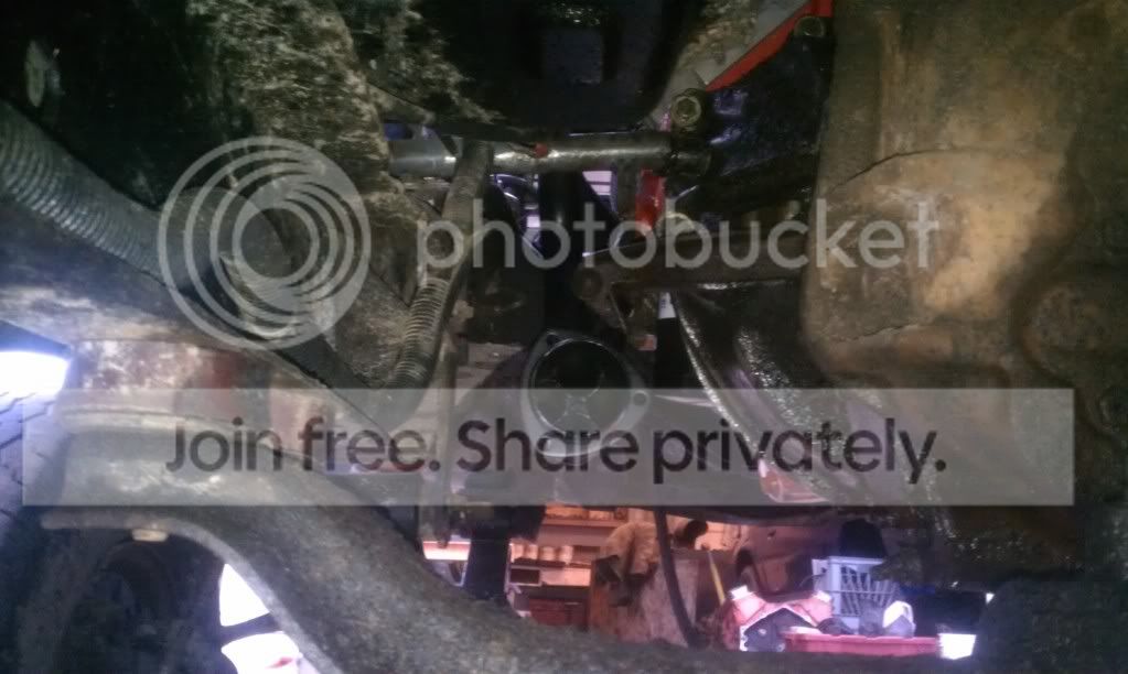

Drivers side looking at the colletor. There is more room than it looks near the clutch fork.

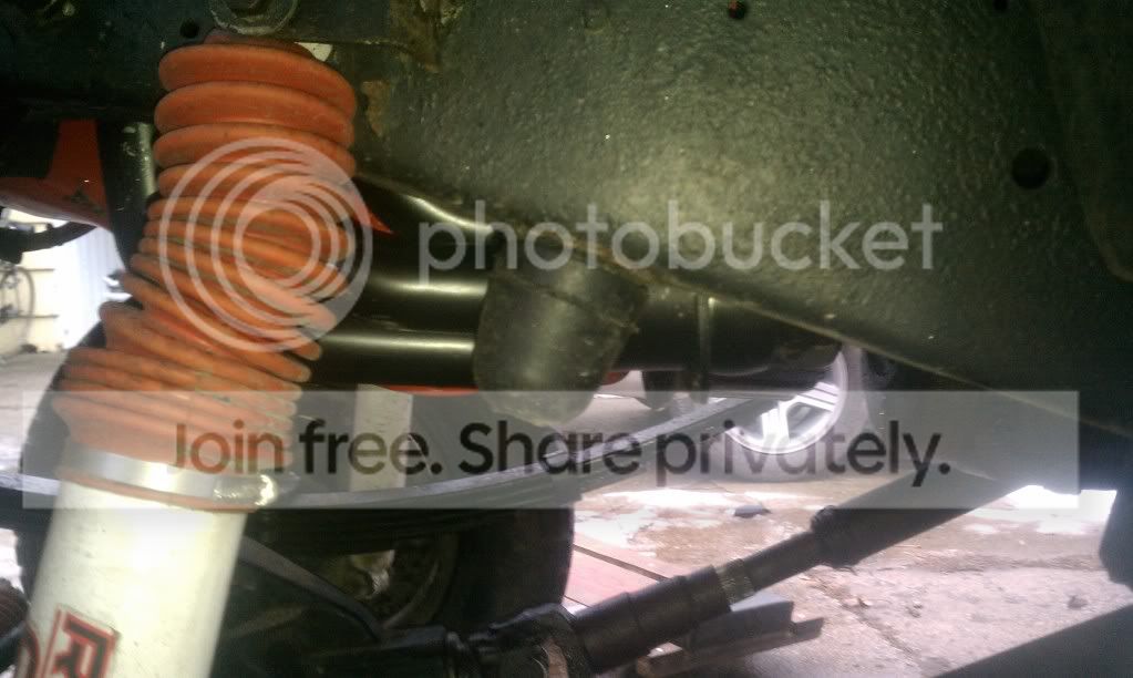

Passenger side looking at the collector. No where near the shackle. Both sides look to be a straight shot back. Won't have to bend around the t-case.
I have a long tube on my drivers side right now, clears just fine. So that being said the pass side should be fine. The only thing that concerns me in your pic is if you moved the fush mount forward it could be tight where the collector and shackle would be. I hate to get a set and it be wrong but im running out of options.
your header Looks a hell of a lot closer to the block than mine, so that's a good thing.
