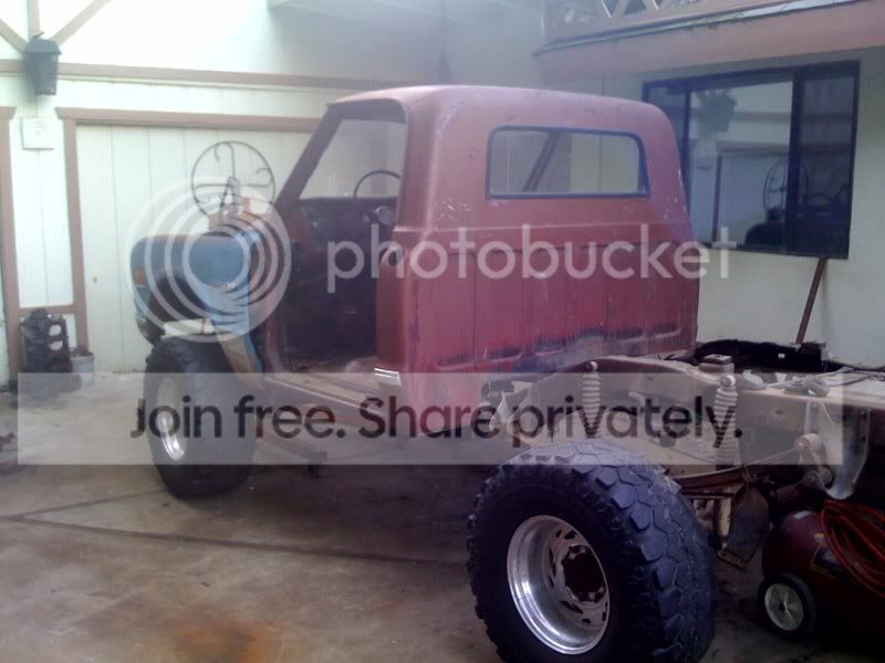

new to the forum and plan to become a full on member. heres what ive got so far. i took a 76 k5 that i traded for and tore the body off the frame,and just set my 67 pickup cab on it. havent fought it enough to see what im gonna have to do to make it all bolt up. decided to call it a night cause of the lack of light and long day. Just wondering if anyone here has done this yet and could shine some light my way to make sure im not gettin in to deep

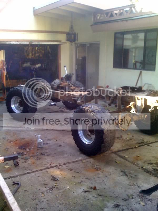

heres the frame with the 3/4 ton axles and 35''s

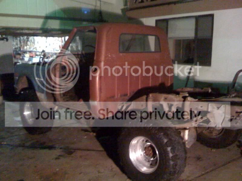

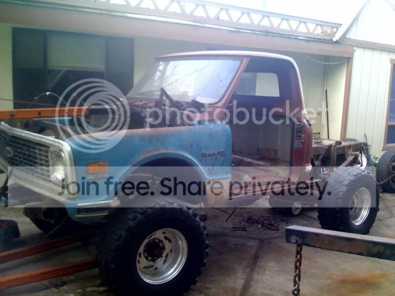

heres the cab just resting on the frame

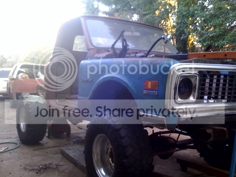

ok. mudder helped me out with some info, got the cab and cap bolted on and body lift all secure. got the sm465 in and snug. now i just gotta get the steering to line up. then its just brakes, engine and hydo clutch setup away from being able to beat on, ill post updated pics after work,it was too dark last night to take any
lemme know whatcha guys think

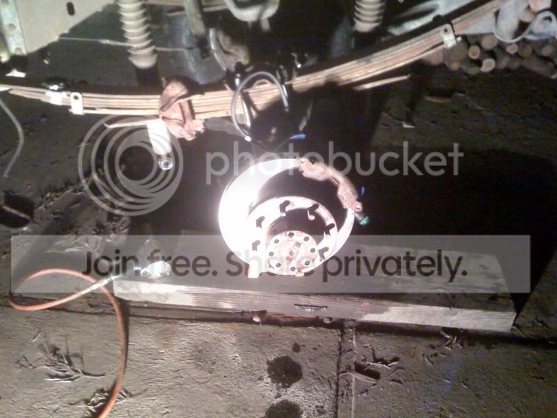

got my 14bff disc brackets from DIY4X today. i must say i am thoroughly impressed with the product and service i recieved. i got the drivers side wheel off and tore into it. everything went so smoothly.not as expected.lol. put new calipers up front and just carried the old front ones to the rear,with new rotors and pads. ill do the passenger side tomorrow when there's more light out, i also tore the diff cover off the 14 bolt to see what gears it had. open 4.10s . now i just need to decide on what locker to go with. this is my first 4wd. whats worked best for most?
i have more pictures of the swap. from ripping the blazer tub off to setting the truck cab on. but they are on a different camera. ill get them up as soon as i can. it was a pretty straight forward. one thing i did different from what ive seen is i didnt change the mounts on the frame. i just modified the cab to fit the existing mounts. the rear cab mounts had to be moved 1 1/4'' outward.once i got the rear done i just drilled up through the bracket and made the new hole in the cab,braced it and called it good. as far as the core support mounts go they have to be made because they fall around 4-5''s shy from lining up in the holes. if theres any other ?'s feel free.

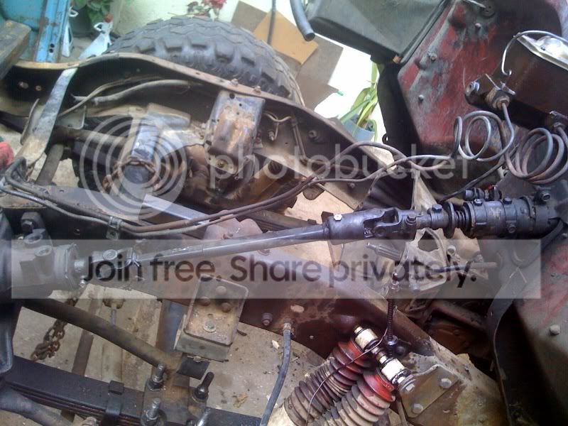

progress update:

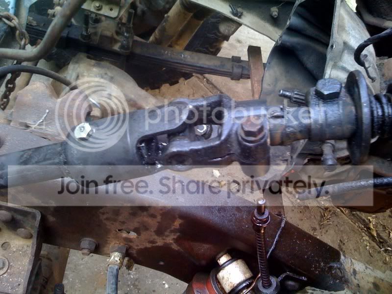

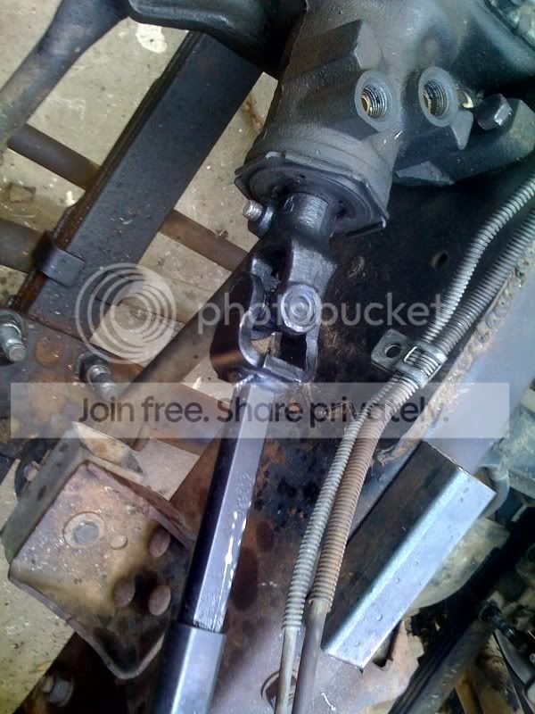

went to pick n pull today and found the only xj in the lot.kinda surprised to not find more. popped it open and the upper steering column was already removed. i didnt even need any tools to get the intermediate shaft off just a good tug. gotit home heated it up and cleaned,greased and installed.
the splined part fit perfect on my steering gear box. the upper DD section i had to make a little spacer part and it bolted right in. easy install took no time at all and works awesome
Steering------done

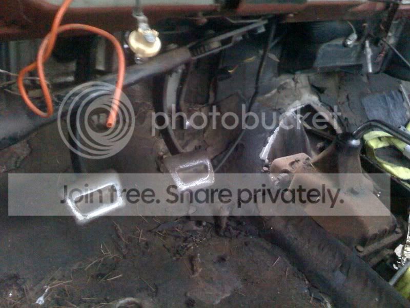

i also found a pedal assembly and put the clutch pedal into my automatic cab. also another easy install.. all in all it was a fairly easy day but got some stuff accomplished in the little time i had
