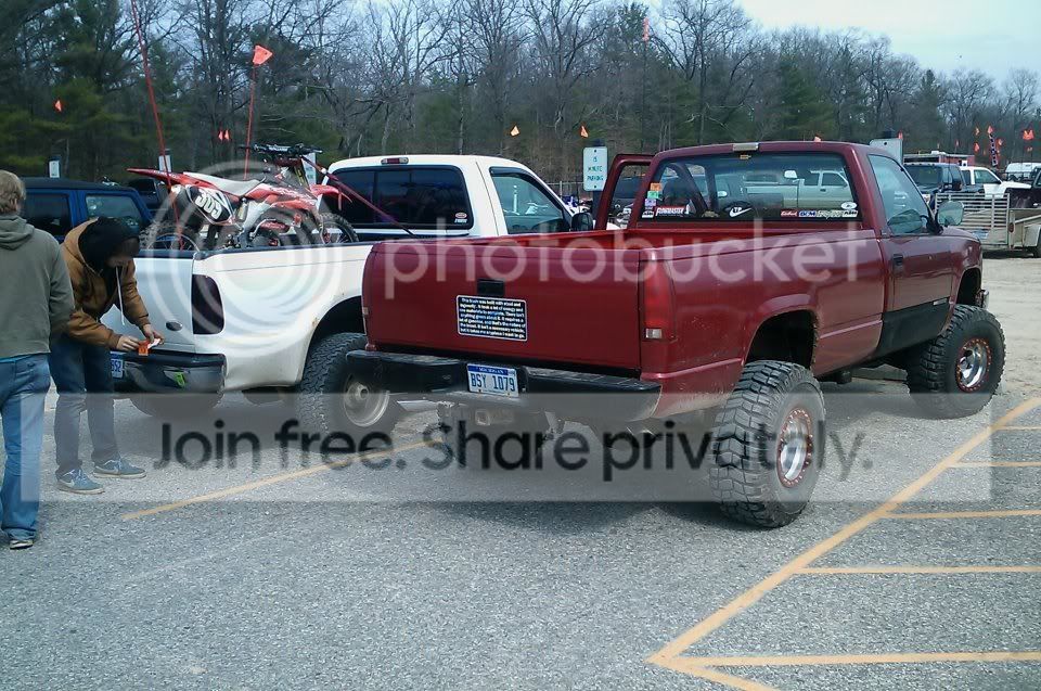

It was pretty nice up there last weekend...not to many guys, and beautiful weather. No, but i got a bunch on my computer. Give me a few mins and ill put some up
Yah my buddies were up there all weekend while I was busy. Im sure you saw them.
Everytime i didnt make it up a hill, i had my buddies dig out my tires, and they had to push me back down while i had it in N
Good lookin rig! Mine looks lame at the moment haha. We shall have to meet up sometime up there.
Yeah the po took great care of it, and im gonna keep it up. Yeah we should, ill be up there a lot this summer too, ill probly see ya around.
