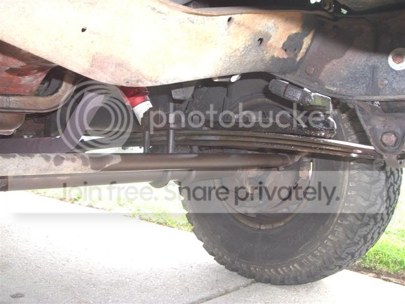

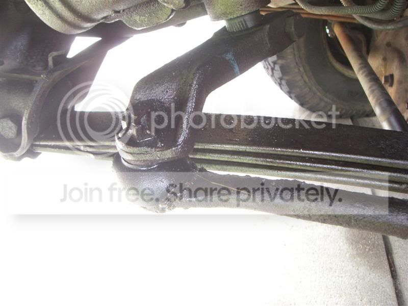

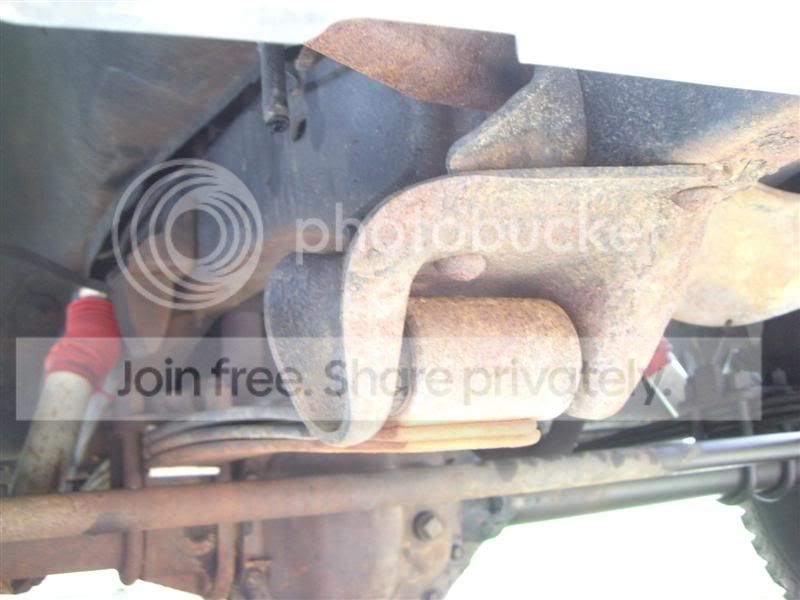

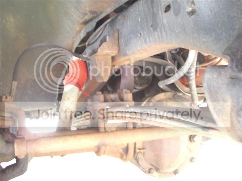

I just got my '71 Blazer this past weekend, and I have some questions for the experts around here. My front springs seem to be inverted. Is this normal? One issue is how the joint on the steering arm hits the spring when turned all the way. Can anyone advise what would cause this, and would a set of 2 inch lift replacement springs fix the issue?

They're not inverted. Factory springs had a negative arch to them.
Normal factory springs.

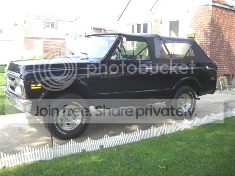

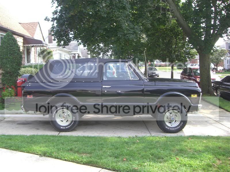

But....Please post pics of the new truck and details on it.
What he said. Need pics. Don't new springs will fix the steering bump, sounds like your draglink isn't adjusted right.
The drag link actually hits the springs?

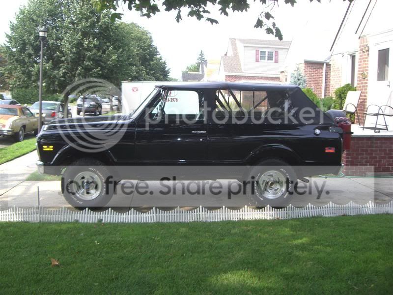

stock 72 Jimmy with 32's on 15x8 rally's
