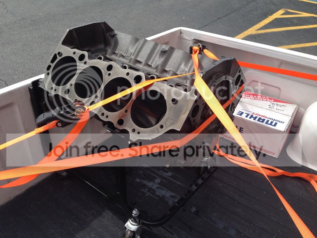

Picked up the block today from it's first pass (bore and hone) at the machine shop.
Next steps will be to mock up the bottom end to determine correct deck height and then it'll go back to the machine shop.

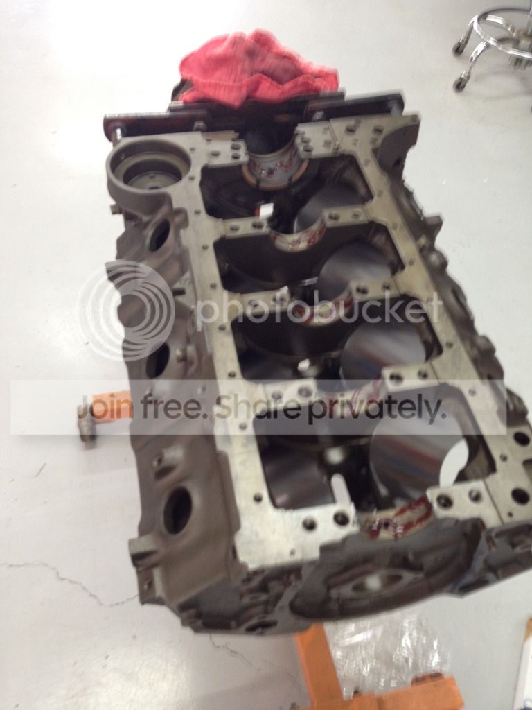

Update 4/24/16 - Are you mocking me? Got a free weekend and met my engine builder at the shop. Mind you, he's just keeping me honest. I'm doing all the work here...
Yesterday was all about getting the bottom end mocked up to check for rod clearance of the stroker. Got the journals cleaned up, put in the bearings and lubed it up.

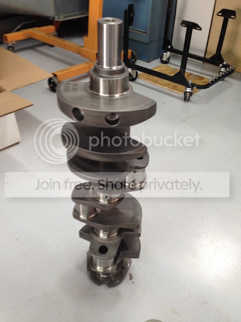

Unpacked the Scat forged crank and cleaned off the shipping grease

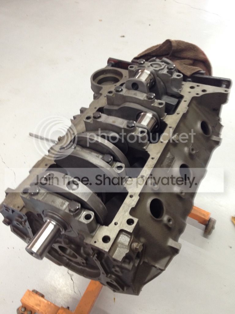

Dropped in the crank and hand tightened the main caps.
Assembled a couple of rods and pistons to check for clearance. Turns out the block may have had a little work done previously as there were zero clearance issues. Flipped the block over to check for deck height and measurement came right about 0.005". So, no decking needed either. Will doublecheck at final assembly.

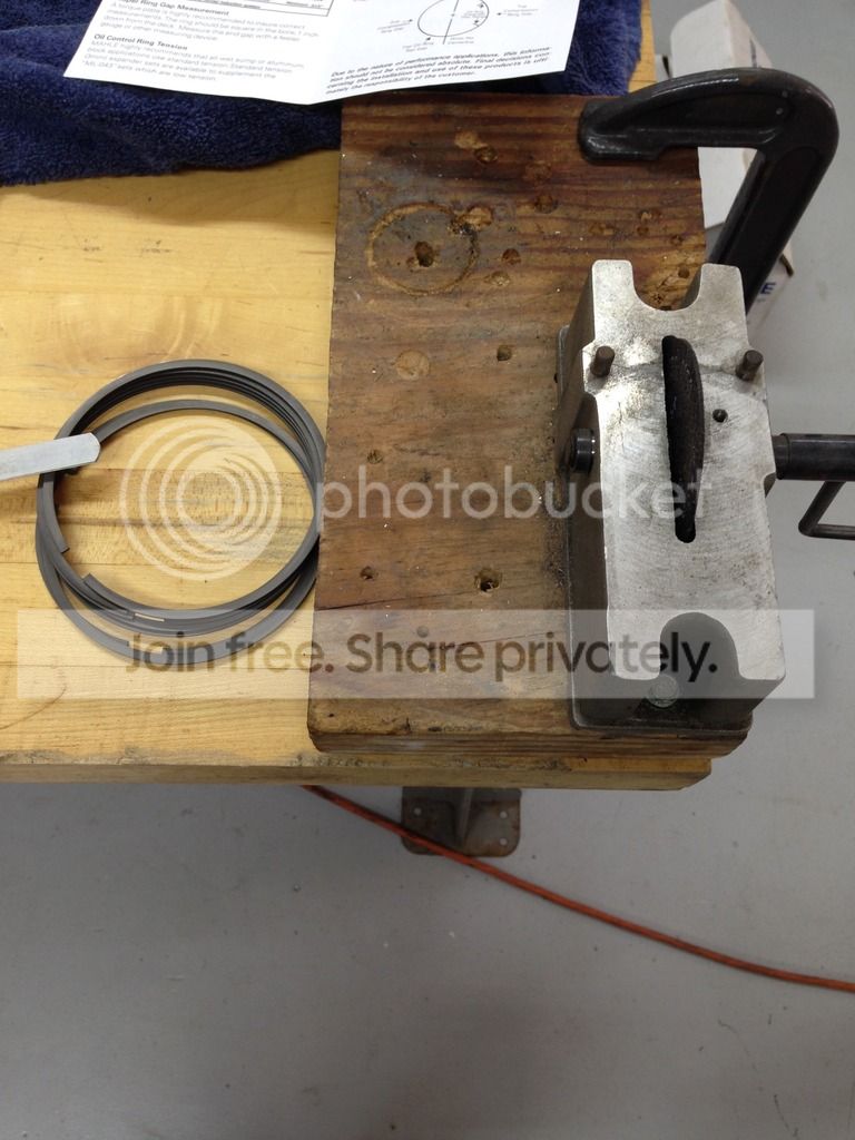

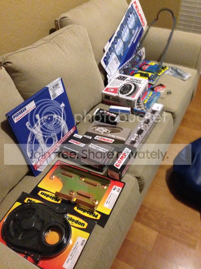

Took the day off on Tuesday and spent the afternoon file fitting rings. Thumb and index finger on my left hand were sore for a couple of days.
Didn't have time to start on anything else, so I headed home and placed the big order with Summit. Almost everything else to finish off the engine. Oil pan, intake, and rocker arms are being reused from the previous build.
The big box showed up today. I'd forgotten how fun it is to unpack this much stuff....
The Brodix heads are backordered a couple of weeks. @Greg72 knows what I'm talking about on these.

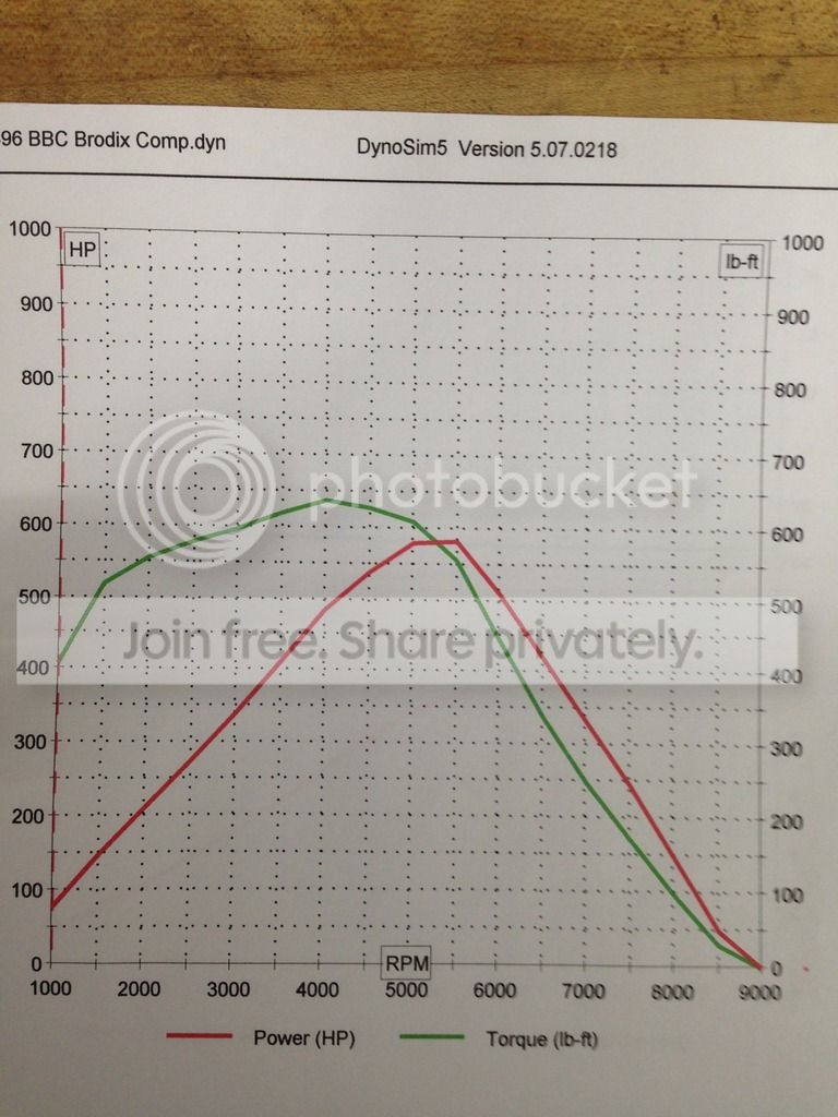

Full specs for the 496.... Heath was a ton of help here:
Mark IV 454 4 bolt main block bored to 4.310"
Rotating assembly:
Scat forged crank (4.25" stroke)
Scat forged H-beam rods (6.385")
Mahle forged pistons (18cc dome, 2cc valve relief)​
Brodix Race Rite BB-O (115cc combustion chamber, set up for solid roller cam)
Comp solid roller cam 11-771-8:
Duration - Intake 280* Exhaust 286*
Lift - Intake 0.646" Exhaust 0.653"
Lobe separation 110* (it'll be lopey)​
Edelbrock dual plane intake
Static compression 10.25:1
Dynamic compression 8.17:1
Should be pretty healthy according to DynoSim5...
Next step is to clean the block and start assembly. :D

Donald Trump just got a look at your TQ/HP numbers.......
"Its HUUUUUGE....!!!!!" :thumb:
