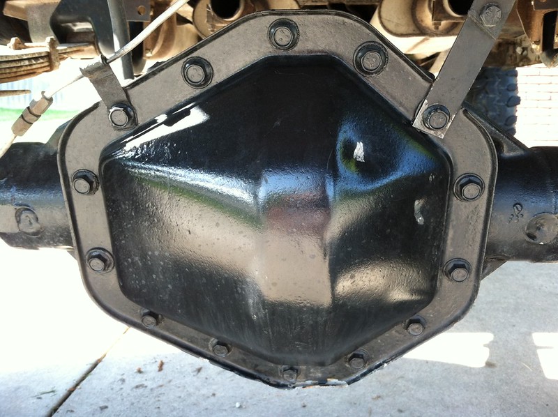

14 bolt cover took some damage this weekend.

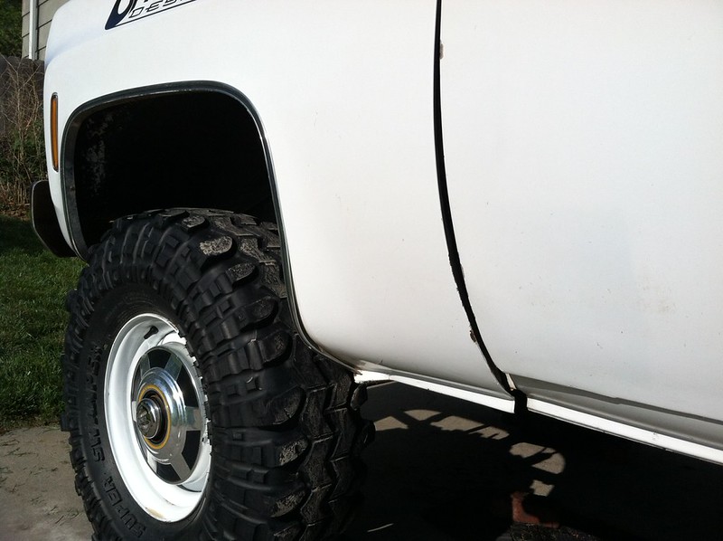

I must've had it flexed out pretty good. Definitley time to do some trimming, but im not sure where to start.... Going to have to do something about that big ass gap too..
Yeah I saw that. I need to figure out how to get it back where its supposed to be and do some trimming. Do most people just just a little cut-off wheel or what? I also don't want to go crazy on the cutting, just enough to clear.
I used a sawzall, but I also don't give a ---- about what things look like.
Martin
I used a sawzall on the back part of my fenders but it wasn't as accurate as I liked. So when I cut the fangs off the front part I used a pneumatic cut off wheel. That worked much better but I've since acquired a pneumatic body saw. That's the ticket man. I got mine at Harbor Frieght for like $5.00. You need a compressor that can flow a lot of CFM though. If you do that, you can make the cuts real easy without vibrating yourself to death like you would with the sawzall.
Just put some blue tape in the middle of where you want to cut so the paint won't chip. Also when I was through cutting, I sprayed a little primer on an acid brush and brushed it on the raw metal so it wouldn't rust.
On the front fangs, I would just cut them square along the bottom so the cut is parallel to the ground, and have the cut at the same level as the bottom of the radiator support. That is how I did my Suburban. On the back just cut off the "mud flap" of the fender.
Martin
That's how I ended up doing my front fenders after I put the tube bumper on. It looked kind of silly with the fangs hanging down below the bumper. Plus it would be stupid if they got smashed, so I just cut them even with the valance. :hack:

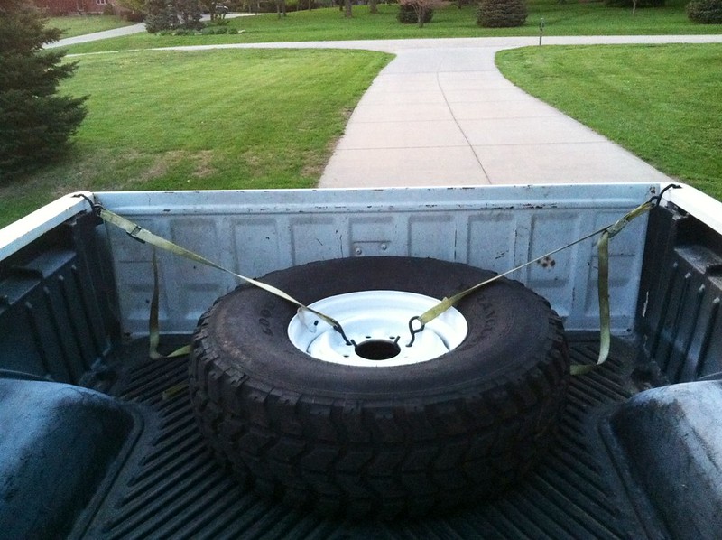

Thanks man. I haven't really done anything with my tire carrier yet cause I haven't had time. What I wanted to do is build something like what you're talking about that is detachable so I can still use the rear as a "truck". What you have in mind would be awesome, but like Adam^^ said, I would be a PITA to haul anything. To just make it removable would be perfect.
Here is what i'm doing for now haha.
