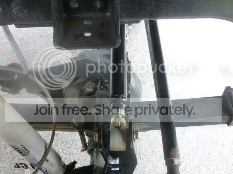

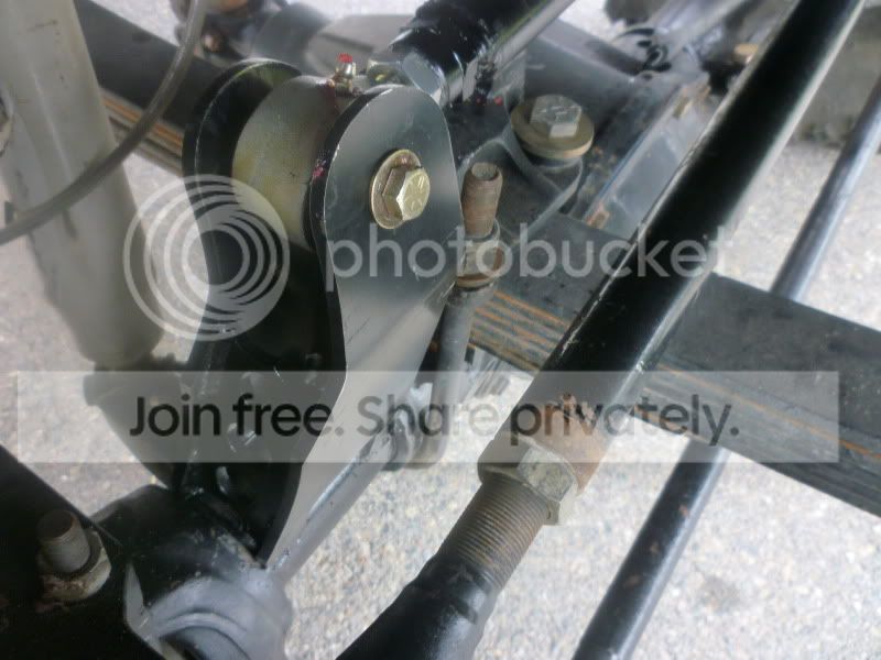

I need to get a 1' spacer for under both arm so the tie rod will clear the springs, also the tie rod would need to be shorter not enough adjustment in the stock tie rod. One thing always leads to another it is a future mod that i will be doing, once the front suspension is moved forward and everything is checked for clearance. With going to a more off set main leaf it will put the tie rod closer to the arch of the spring and may hit.hey just a ?. If you have both hi steer arms, y not run high steer.

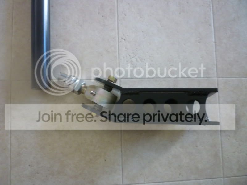

Yes sir I'm ready got a new rig/ build coming up so i can use it on there.Are you almost ready for the front spring hanger and kit? I can get you the hanger and shackle mount. No track bar mount yet though.

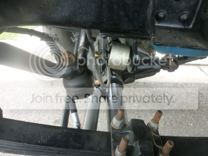

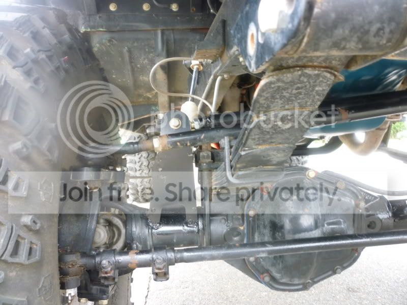

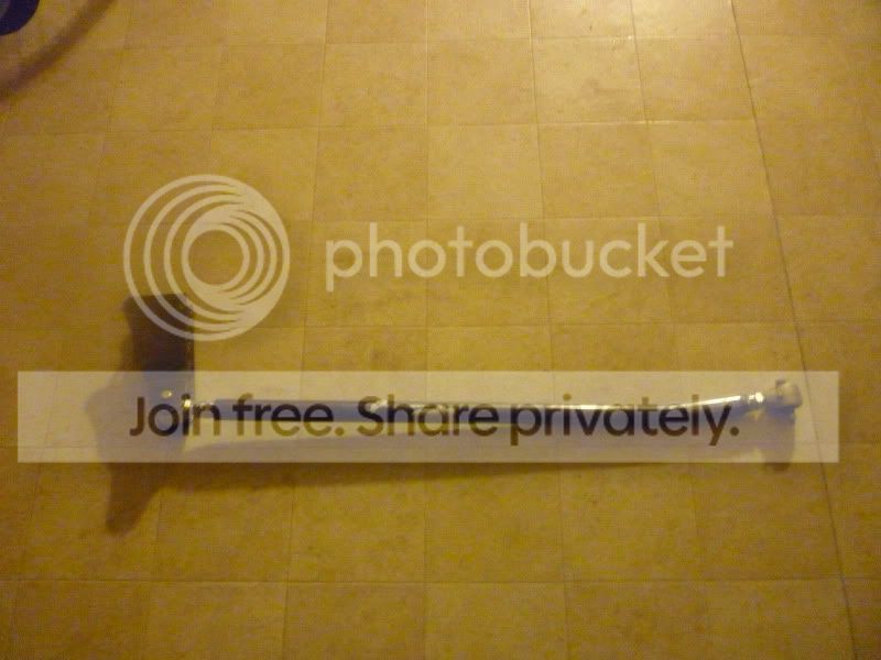

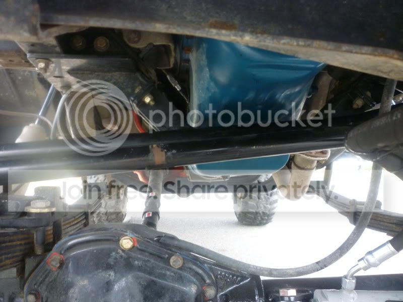

Yes i added the hydro then a couple weeks later the pan hard they both added to the solid feeling. The hydro took out a lot of play and wondering on the road. The pan hard bar maid it drive straighter and feel even tighter especially when cornering and turning no more frame and axle flexing while turning. When i was mocking up the pan hard mount the axle shifted 2 inches or more side to side by just turning the wheels lock to lock.
