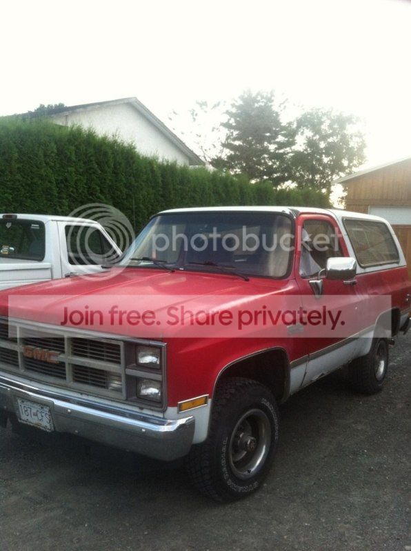

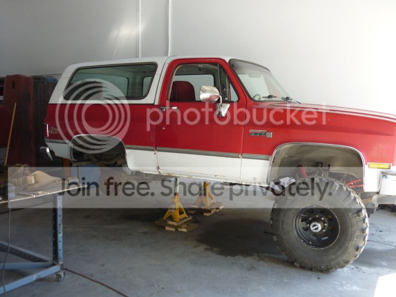

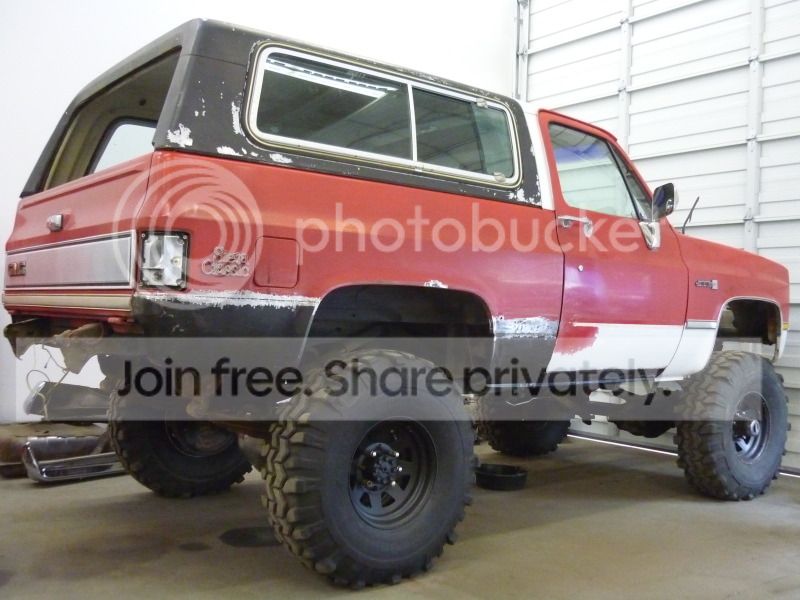

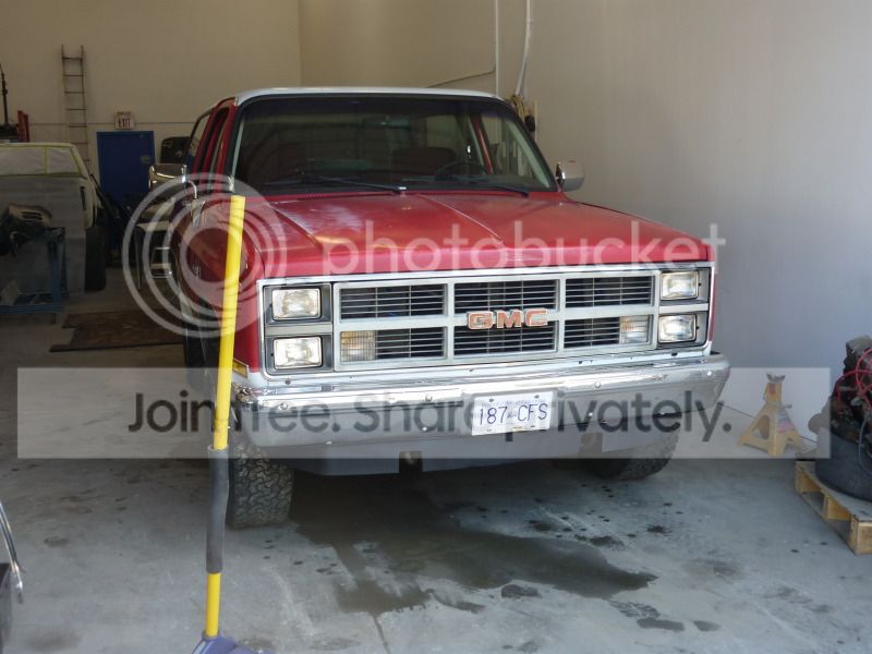

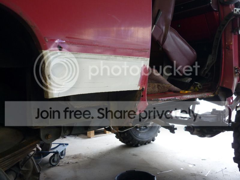

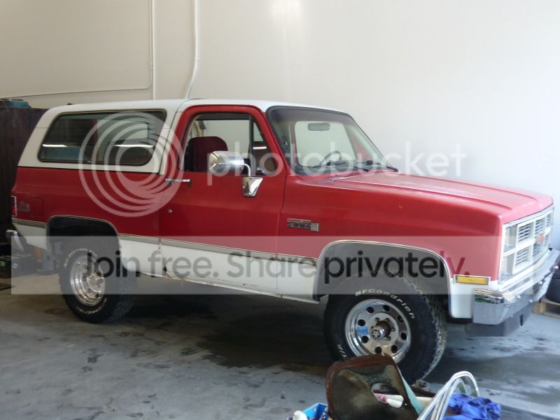

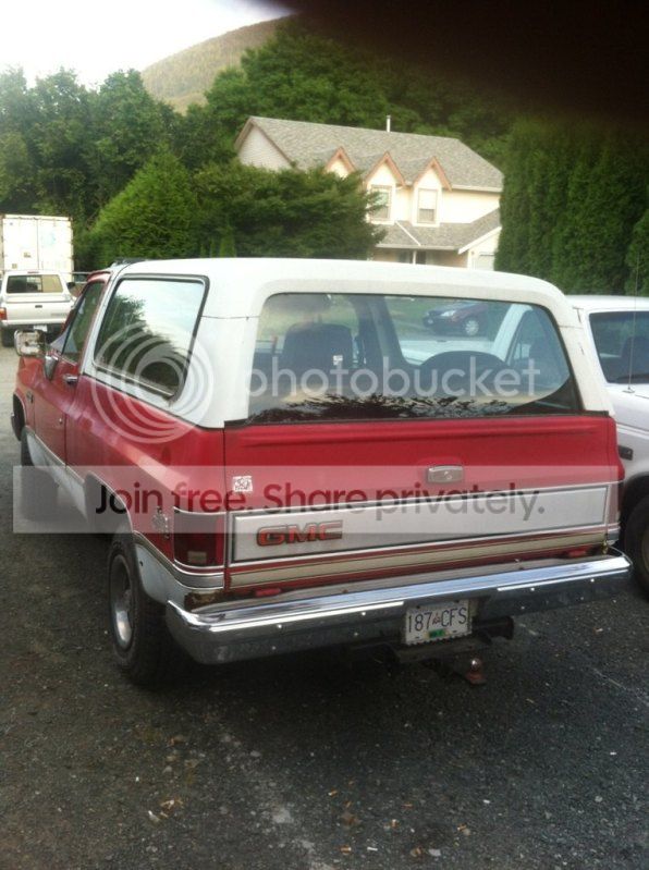

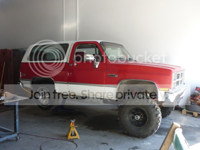

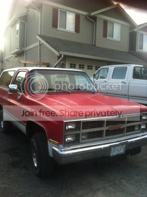

Picked up a 84 Jimmy for $800, stock with no modifications. 305 slug with the 700r & 208 combo.

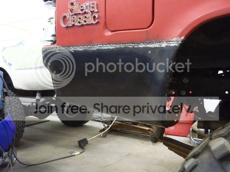

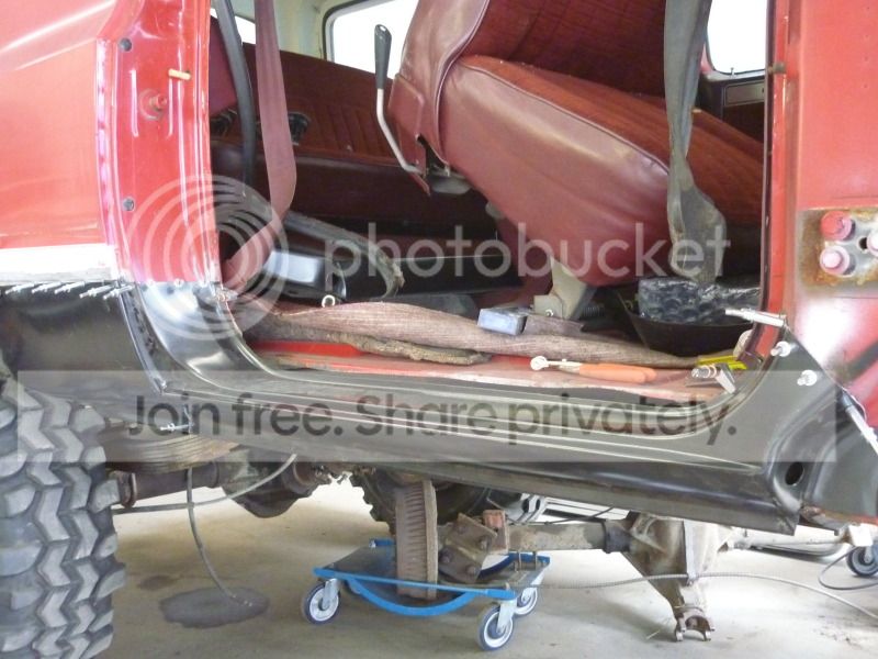

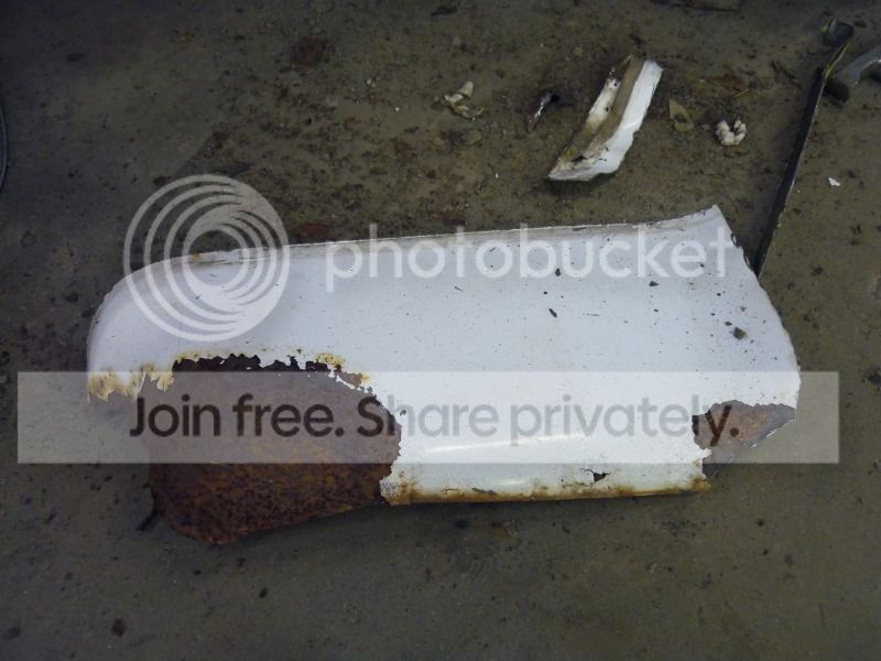

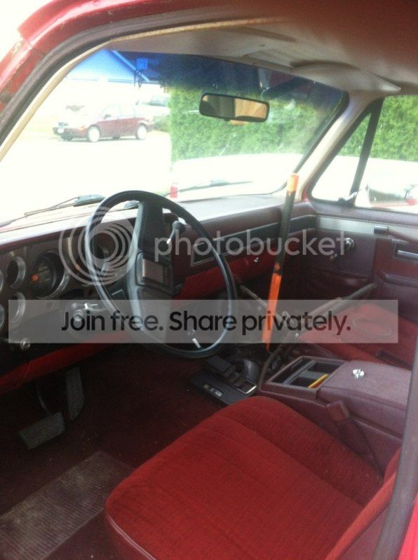

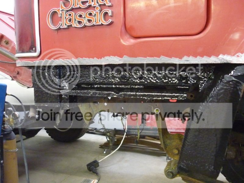

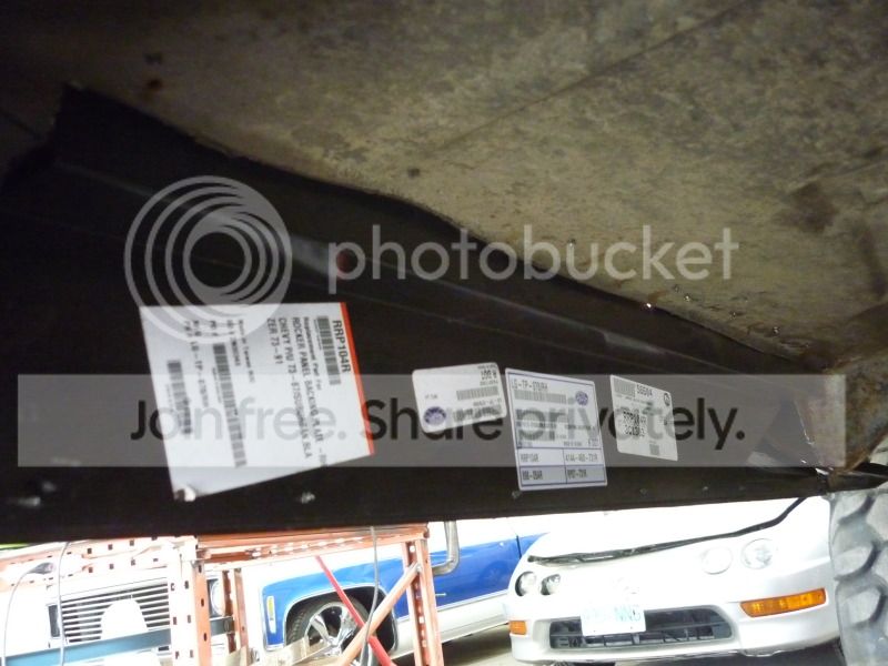

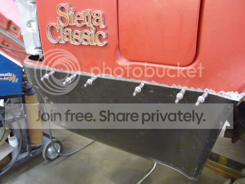

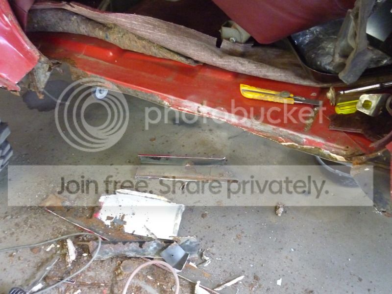

Typical rust you would expect to find and interior all there and not bad condition.
All in all i feel i got a good deal.

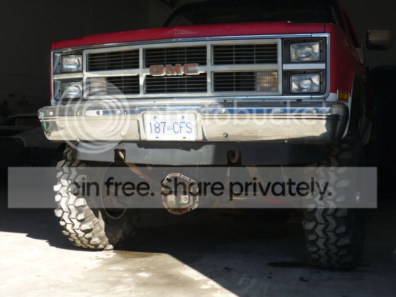

D60/14BFF combo
Motor swap
Suspension lift

Color change ( not a fan of the red )

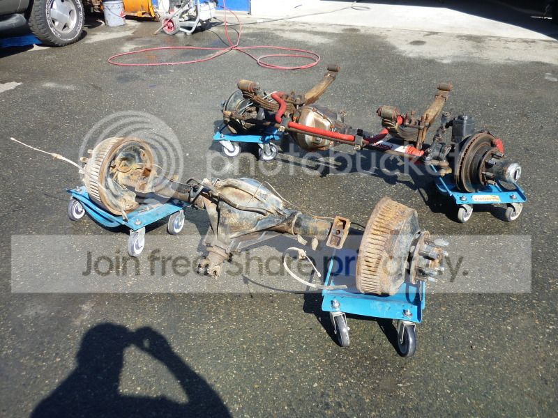

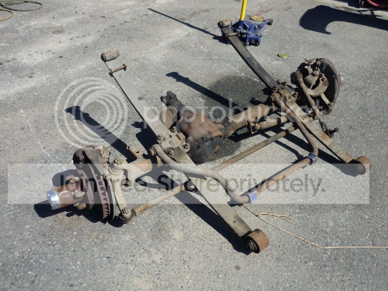

So about 2 weeks of searching for parts to gather a buddy of mine shows up at the shop ready to do some " Horse trading ".
Long story short I end up with his 79 chevy PU with most of the goodies im lookin for.

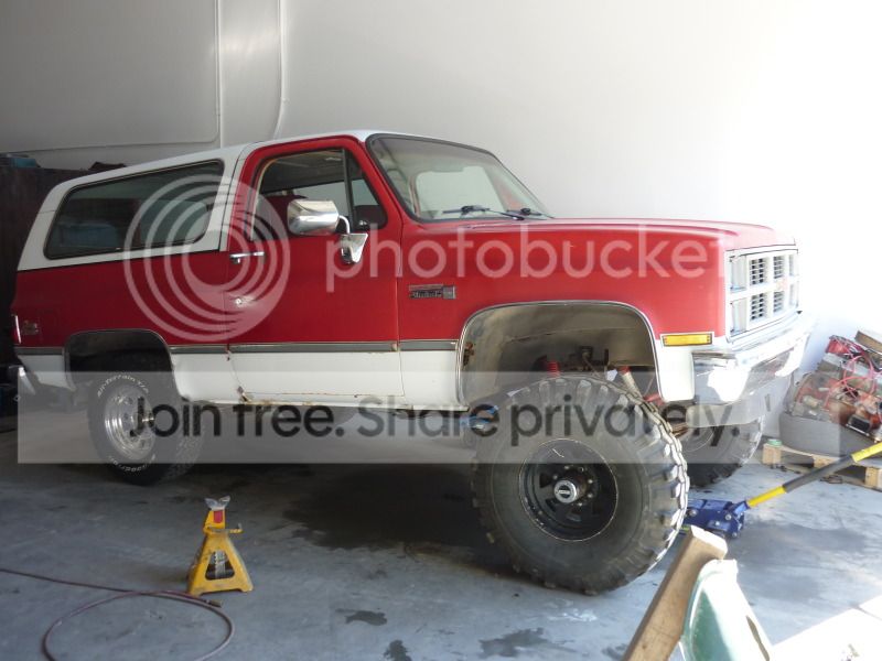

Here is the start of my Sierra Classic build......

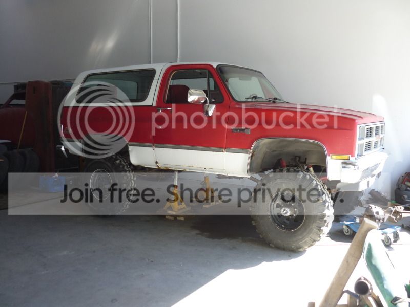

Pics of when i first got her.

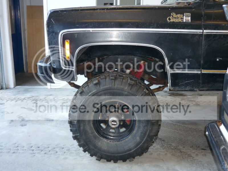

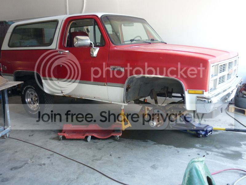

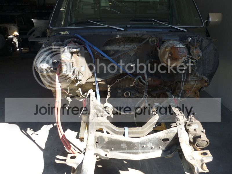

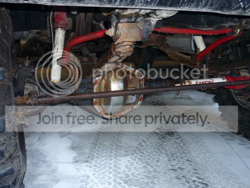

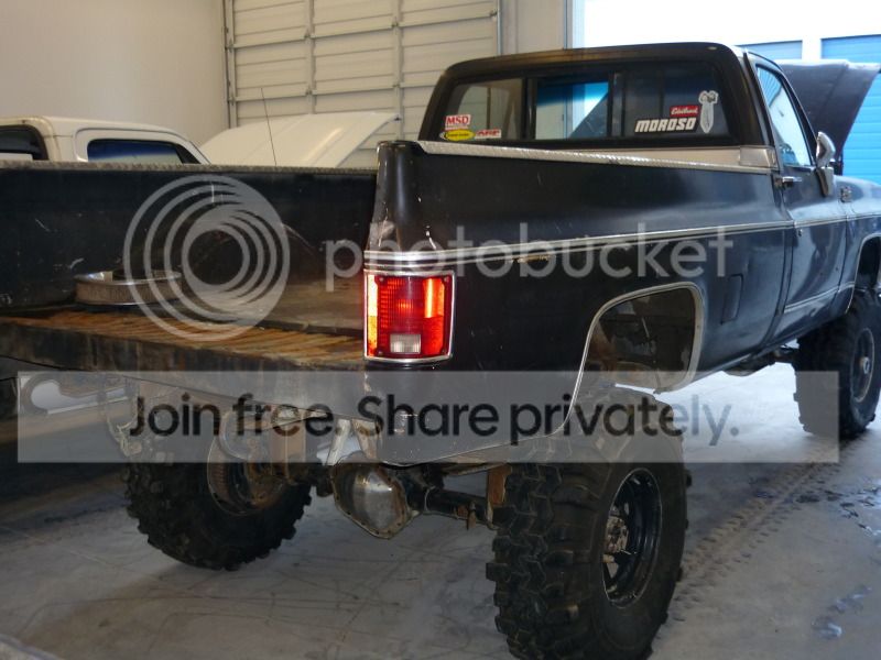

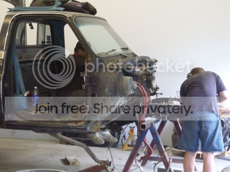

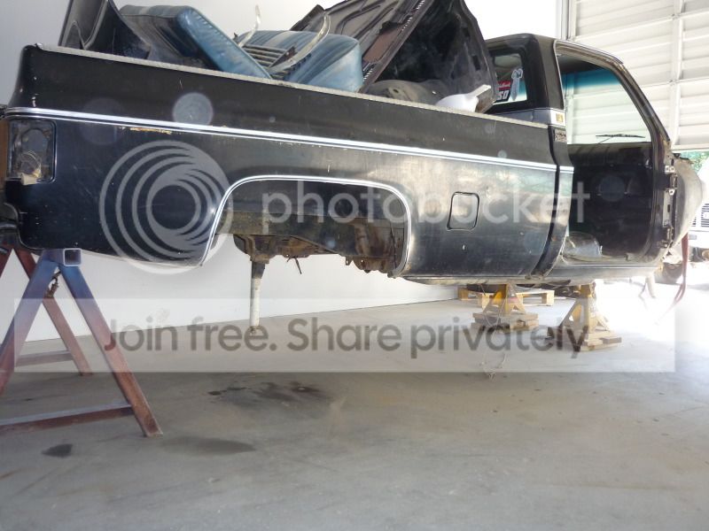

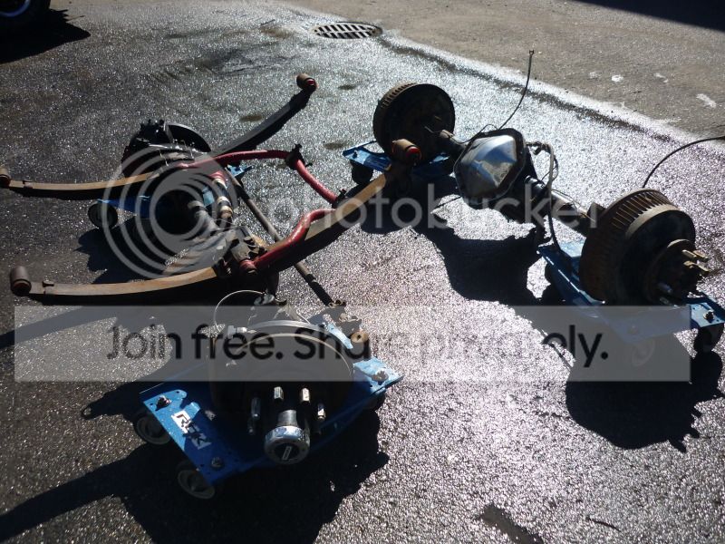

Pics of the donor truck.

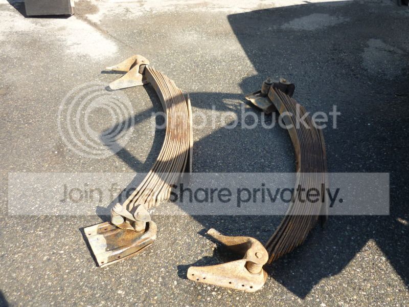

Try to look past the 5" blocks and 15 leafs, yes 15 :dunno:
383 stroker

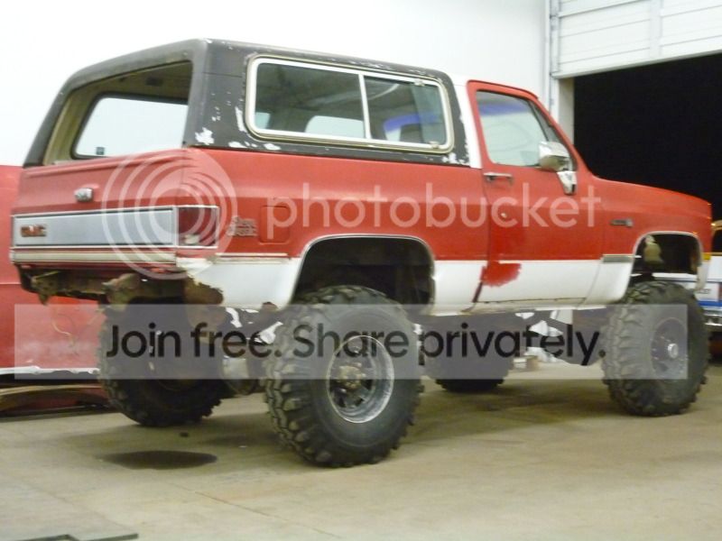

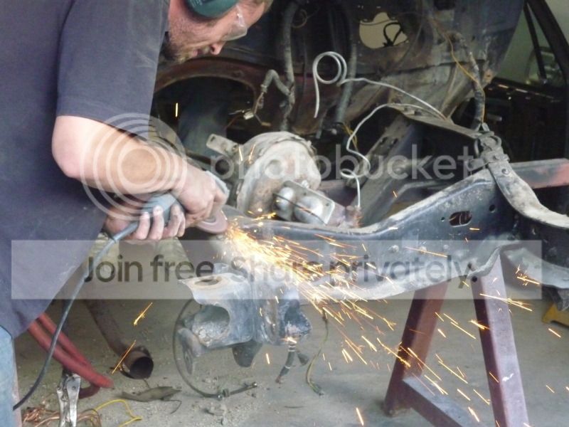

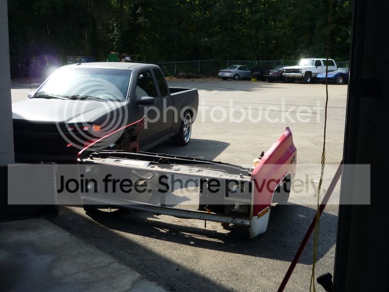

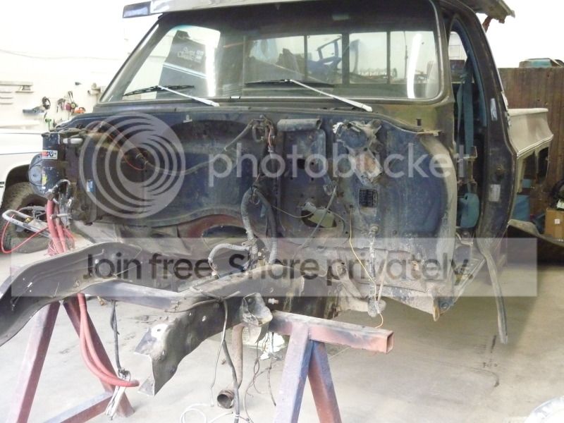

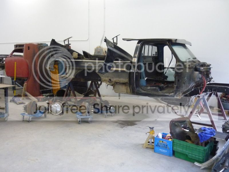

So the donor truck didnt last to long, a couple of buddies and myself had it tore done and ready for the squisher in about a day n half.
Thought i was kidding about the 15 leafs........
Its easy to get help when you tell buddies they can have parts for free
Not much left of the donor.

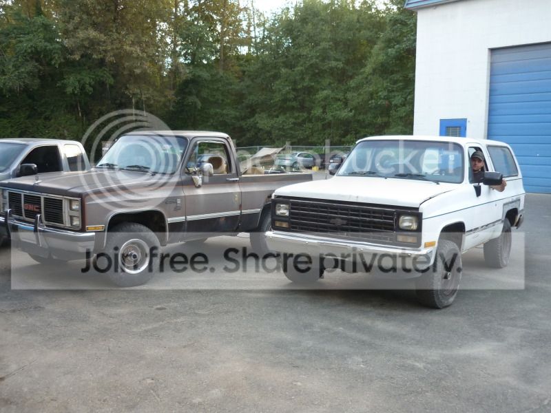

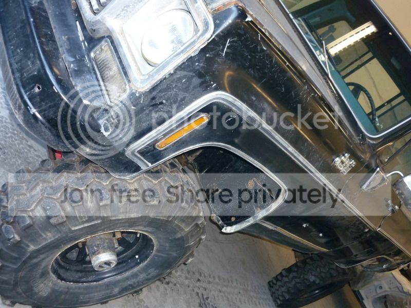

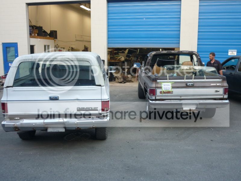

Couple pics of Wade & Jamies K5s

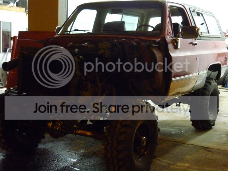

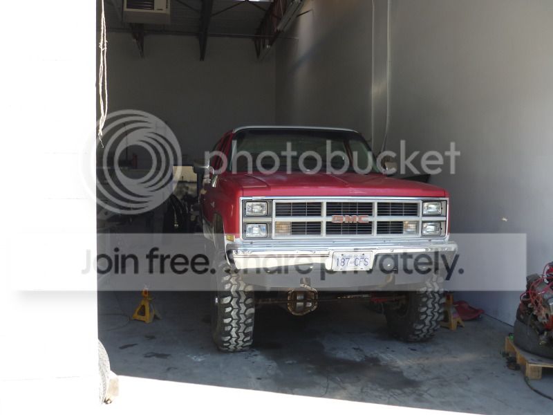

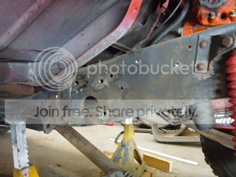

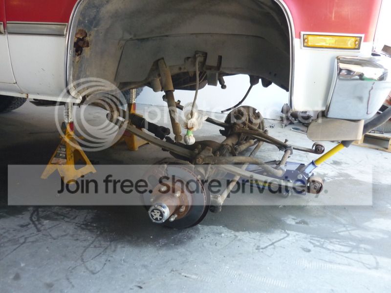

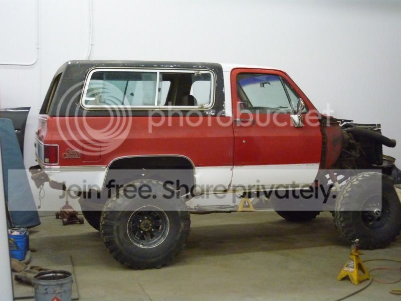

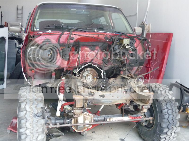

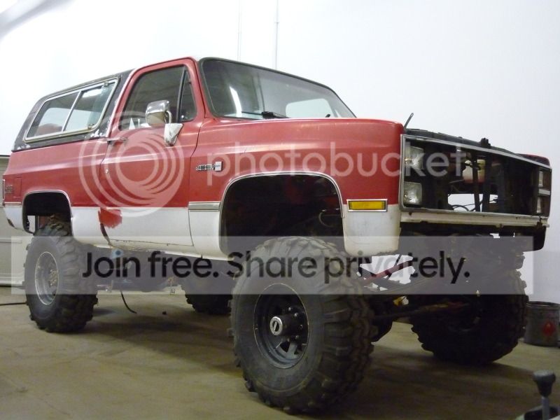

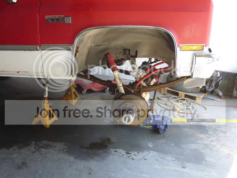

The swap begins....

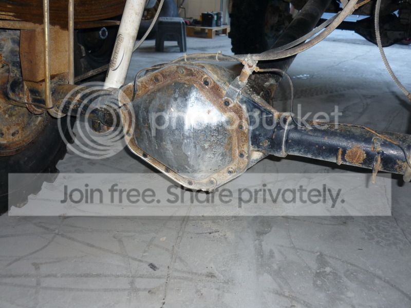

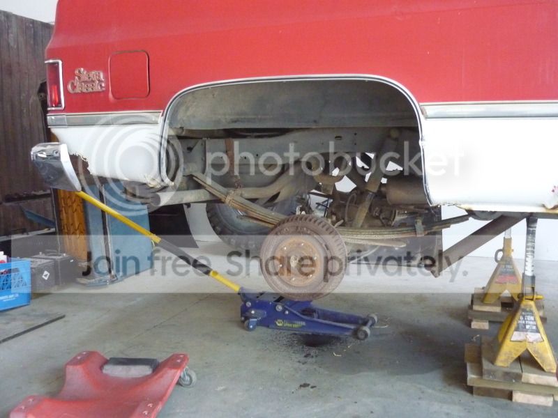

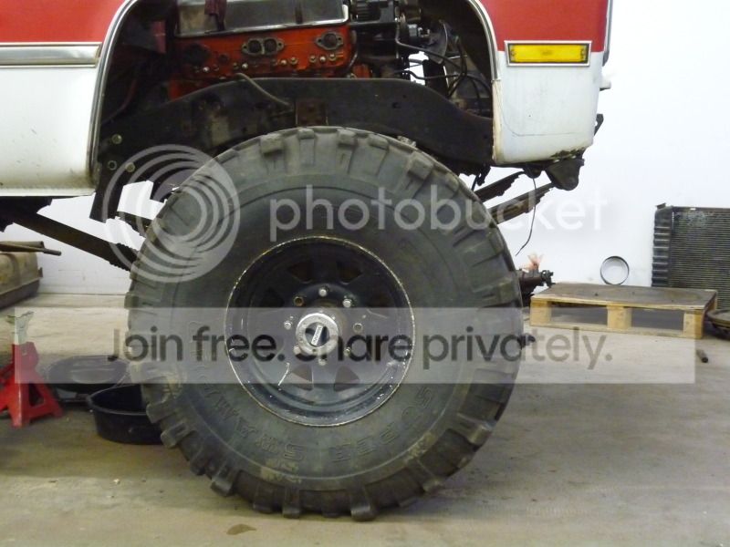

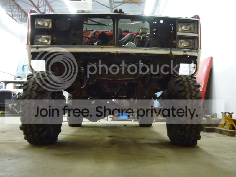

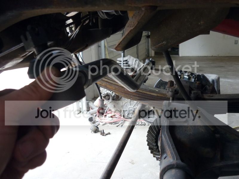

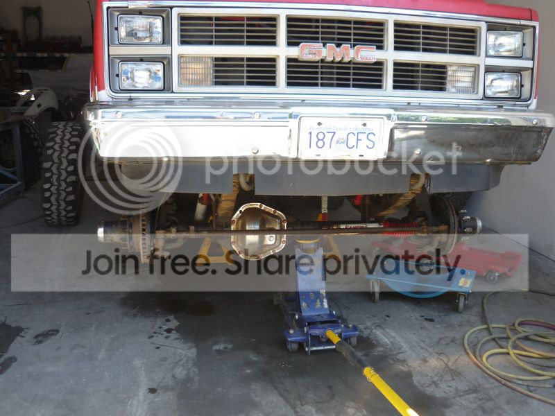

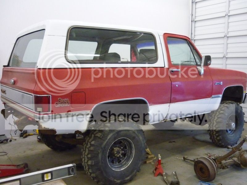

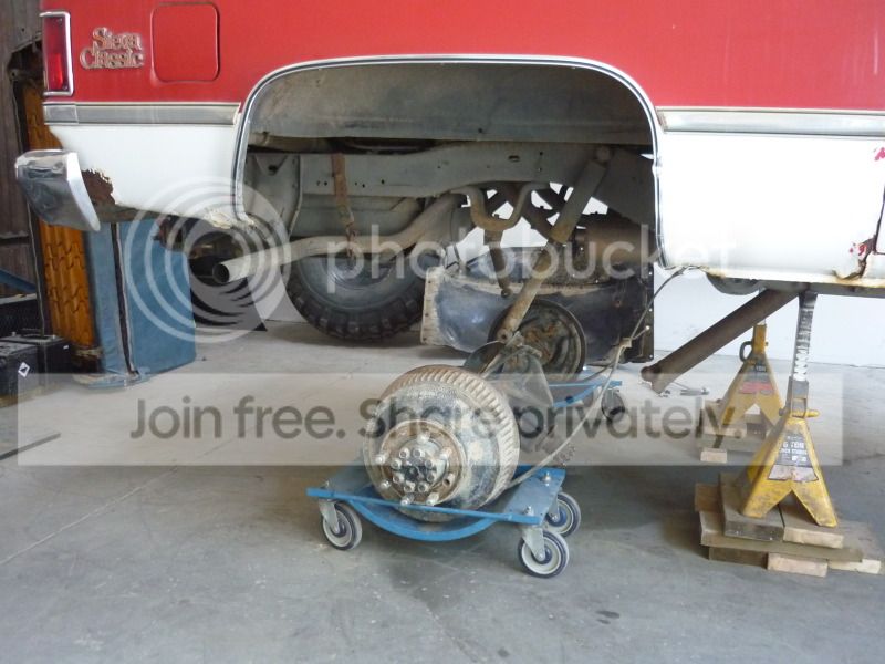

Mock up of rear tire

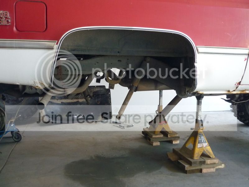

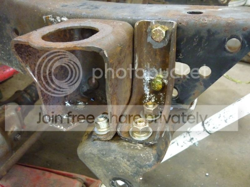

Onto the rear

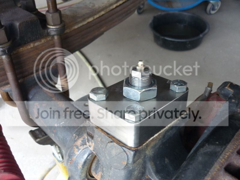

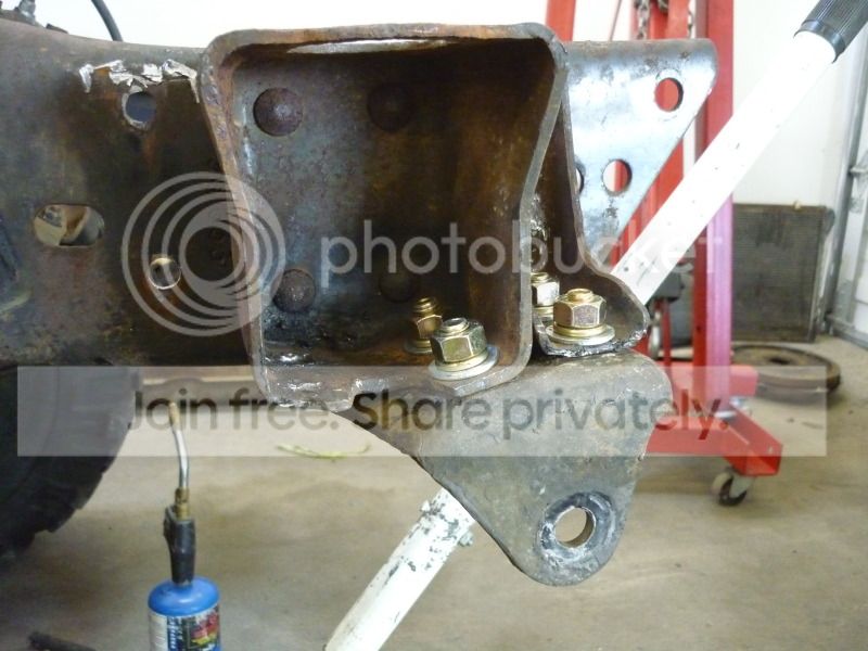

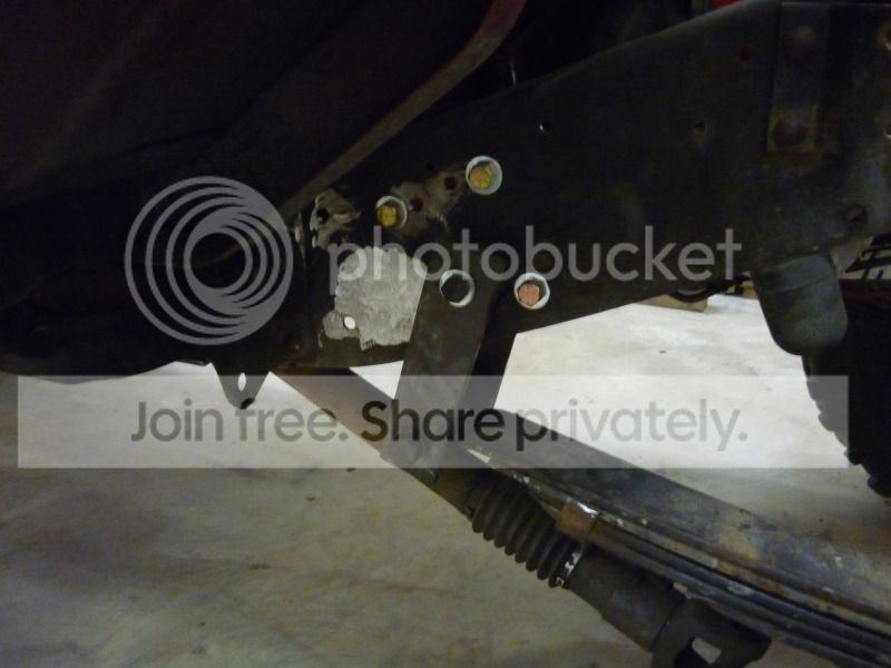

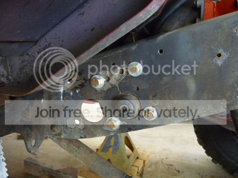

Used the front rear hanger off the donor p/u to do the shackle flip, gonna replace it with the ORD or DIY4X shackle flip soon.
Had to make a Zero rate for the rear to move back wheel 1.5" to center it.

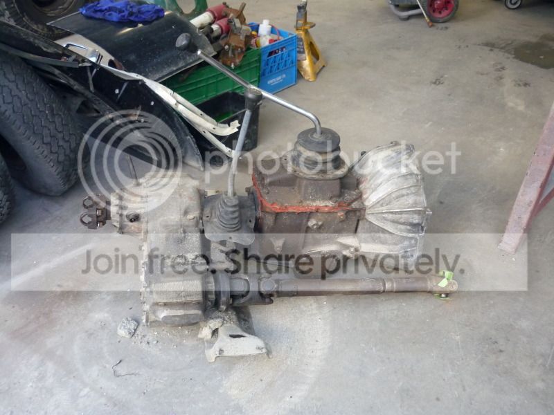

Decided to leave in the 700r & 208TC, there both in good condition with little or no abuse on them.

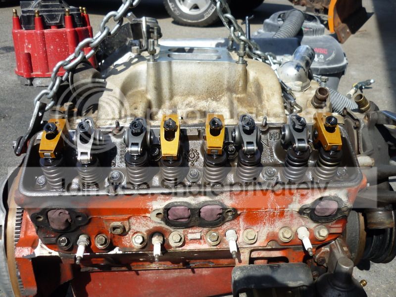

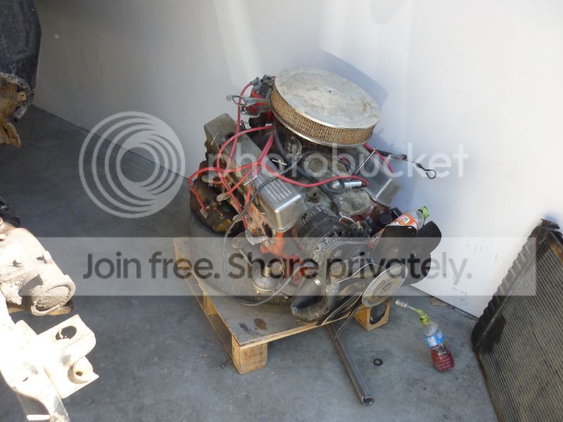

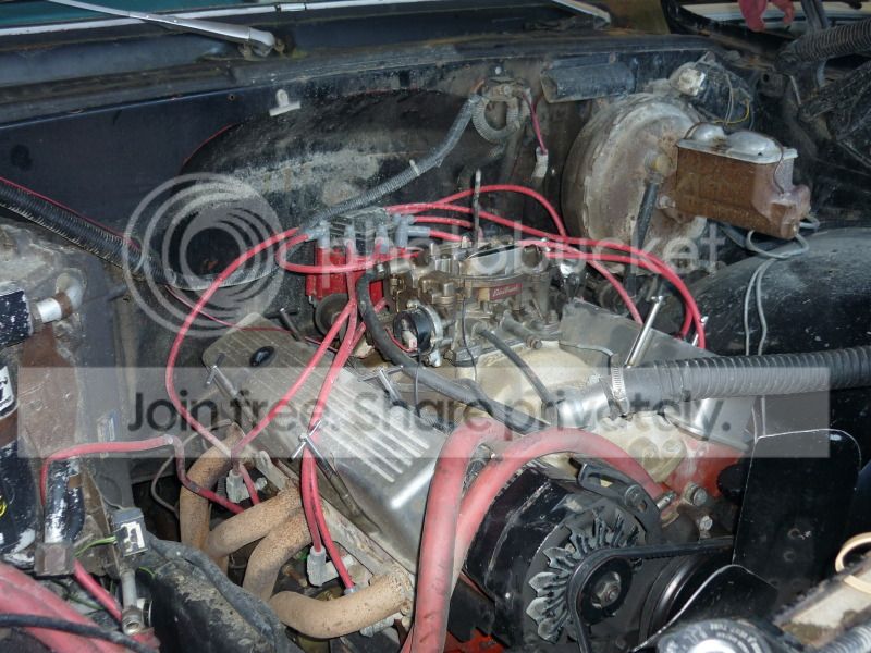

As for the " Boat Anchor " 305, gotta go.
Its always nice when they tell you it has roller rockers it really does.

I realize i have no pics of the motor installed, once its up and running will post.

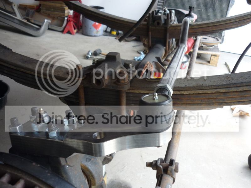

The one i couldnt resist to do is the 52" swap, not only very simple but very cost effective.

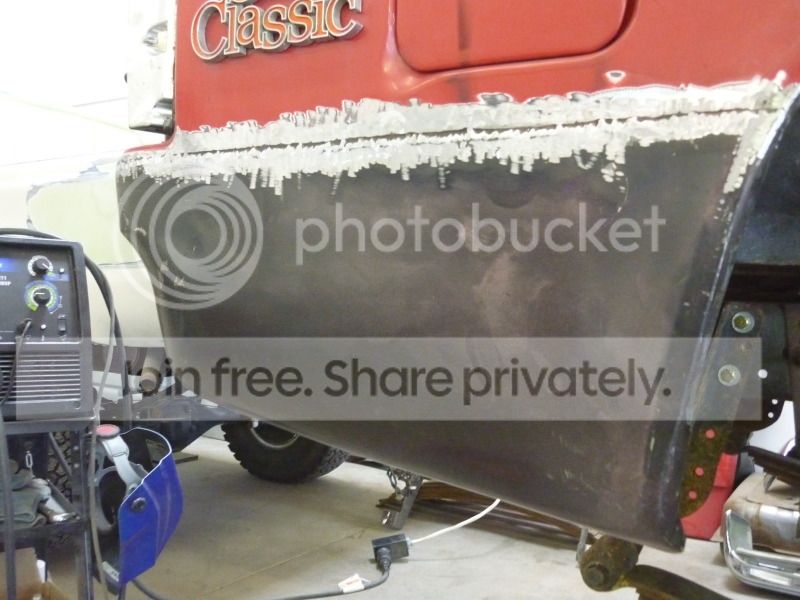

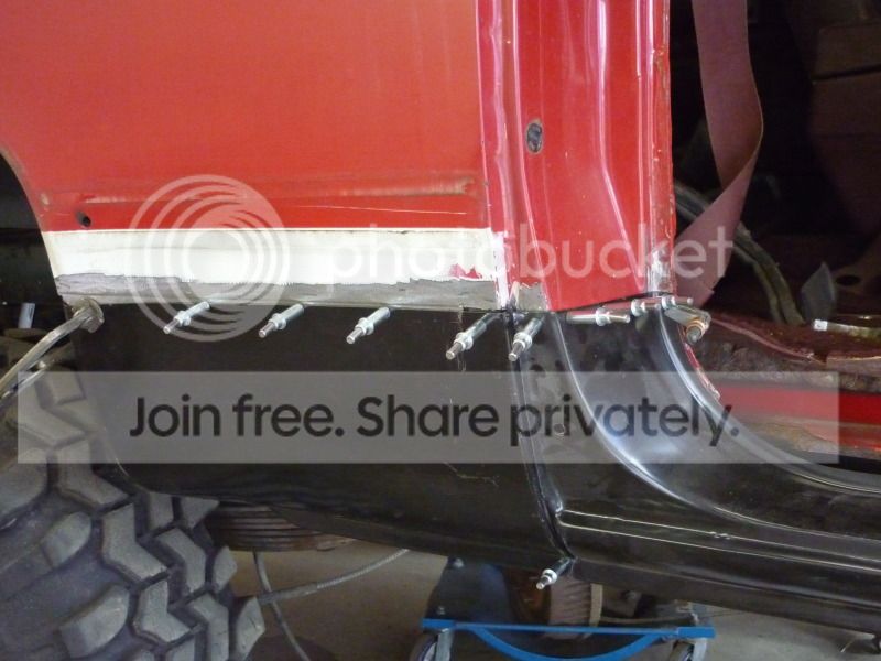

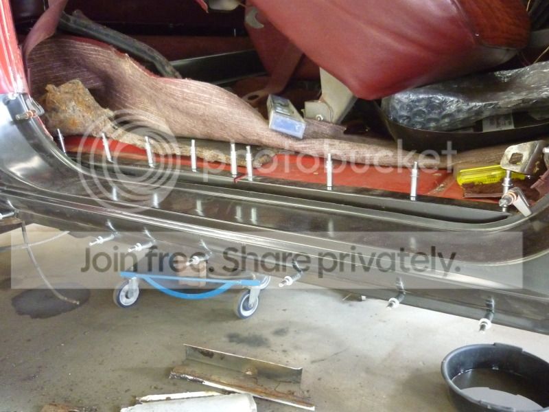

Made some temporary shackles from 3/8" steel and used the metal i cut out from the hole saw to weld back in the old hole.

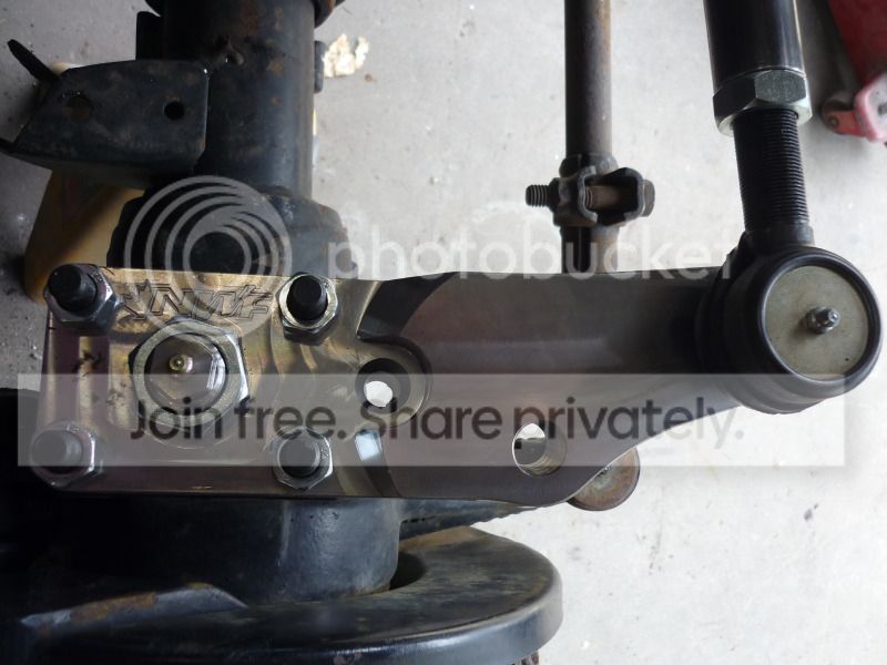

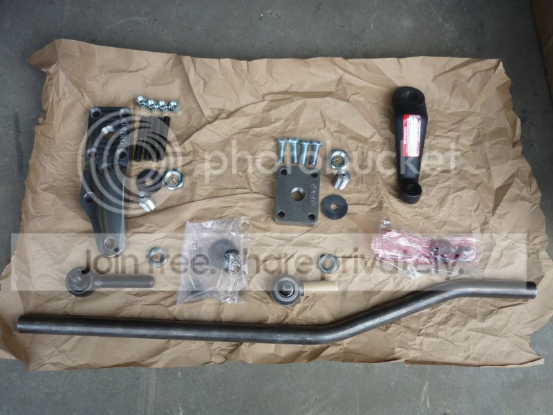

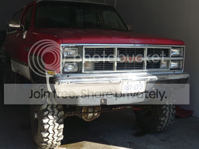

So im wainting on some misc. parts, shocks, brake lines, x over steering.
NorthWest Fabworks will have my X over steering to me by Friday.
Will post some more progress pics.
Thanks for looking!

Also definitely keep the SM465, way better than the 700r4.
What was wrong with the donor truck? It looked pretty solid.
For right now im gonna run the 700r/208. Im keepin the SM465 not to mention it has a 205 attached to it and i have all the parts to convert to manual.

Recieved my X over steering Friday, gotta like when a shop tells you it be there Friday and it is.
Thanks to Chris @ NorthWestFabWorks.
Still have to pick up a 2WD steering box and the weld in frame plates, other than that rest of the parts are in.
