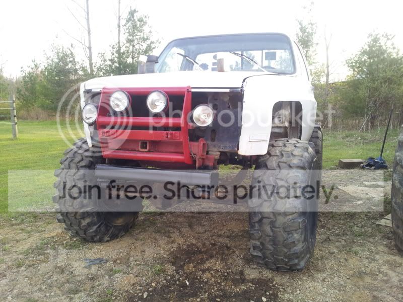

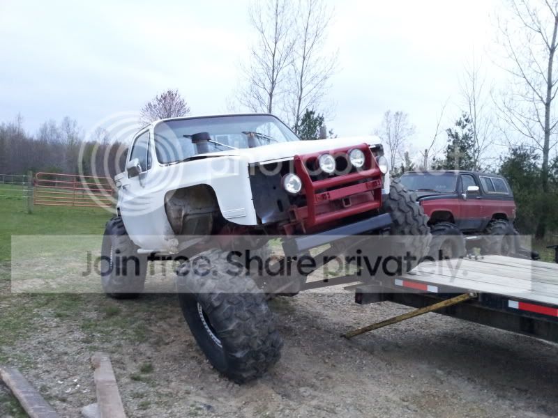

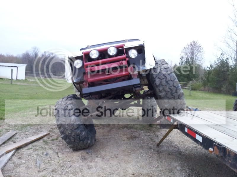

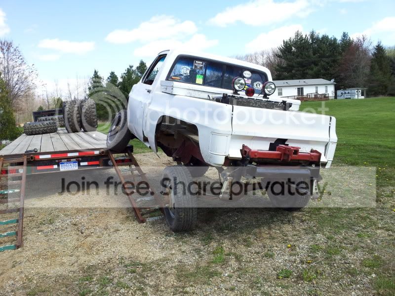

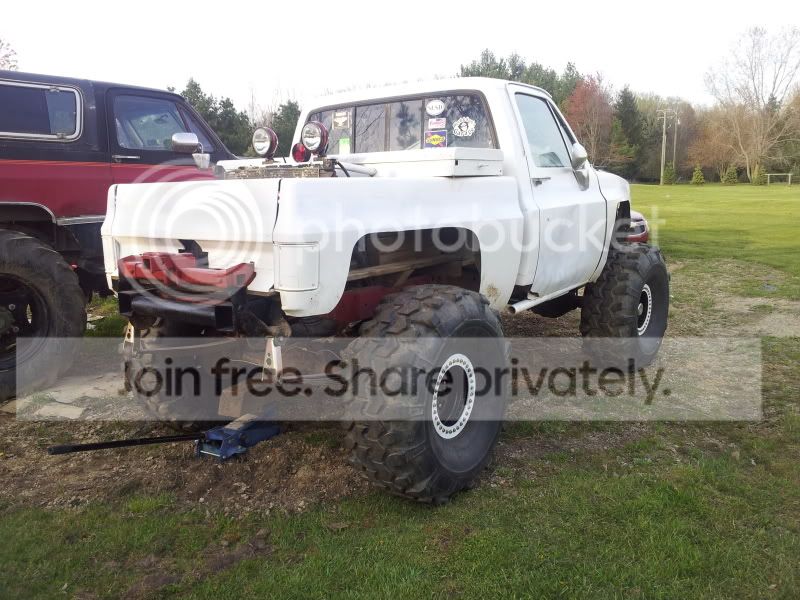

For thrown together, I am pretty happy. Made it to the deck of the trailer with the rear tires still on the ground.

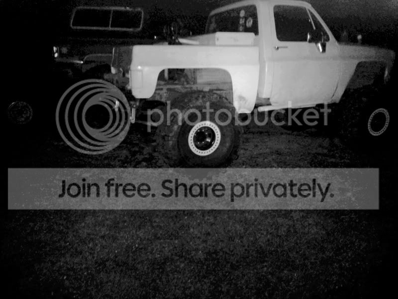

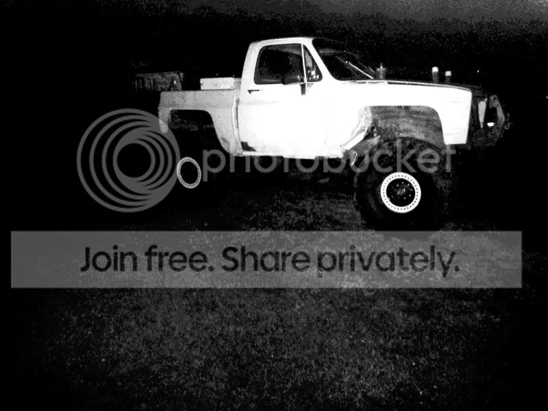

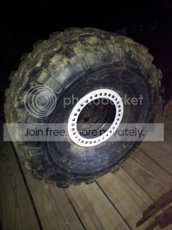

Finished up the beadlocks with enough time to bolt them on the truck.

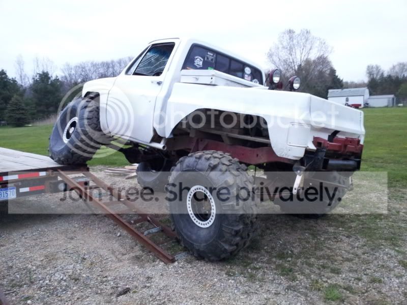

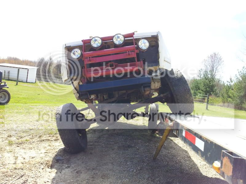

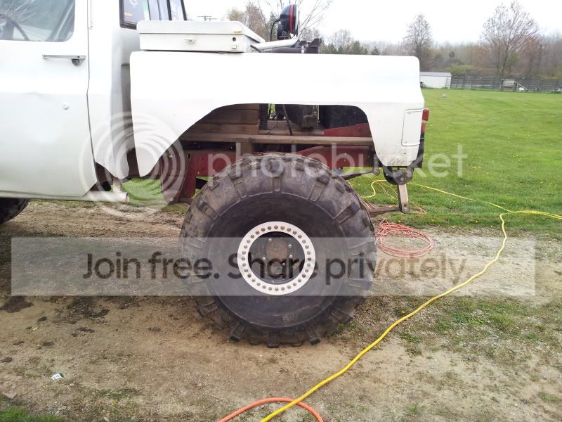

Front clearance looks good. Major interference with the front of the rear wheel well. Off it will come!
Need to grind down my front calipers some more. Little rubbing on the rim.
I'll get some better pictures this weekend.
Had to grind the calipers a little more. Must be some differences in the rims I used to have to these ones. But it was minor compared to what I did last time.

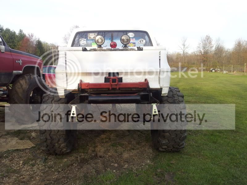

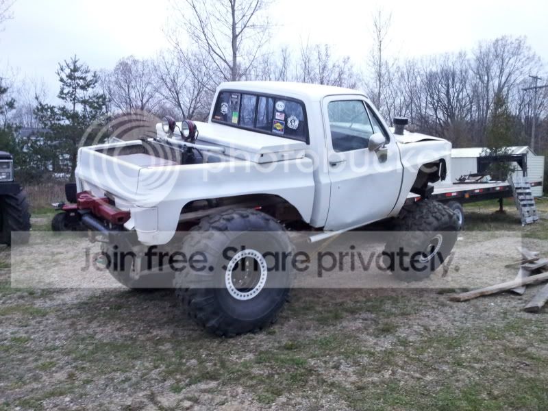

Next is to trim the front of the rear fenders and the front of the front fenders.

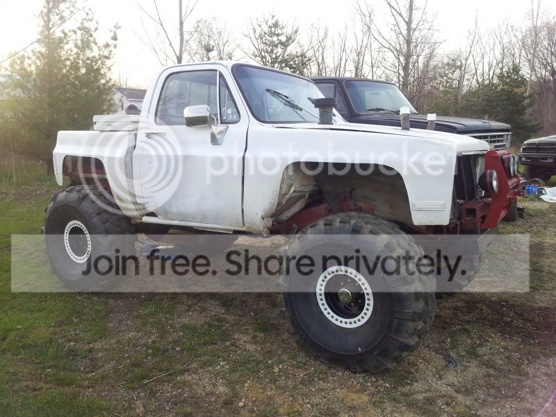

Did some testing for a good 15-20 minutes in the ditch tonight. Nothing broke and it didnt over heat... and didnt seem to stumble.
Still needs some tweaking here and there, but I think it is Mounds ready (local ORV park).
