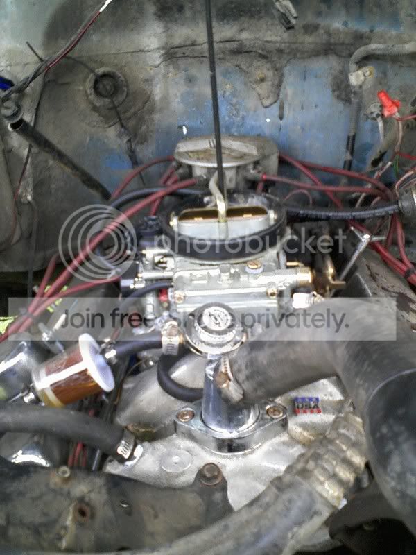

holley 670cfm truck avenger
edlebrock performer intake
k/n air filter
Holley red fuel pump w/ regulator

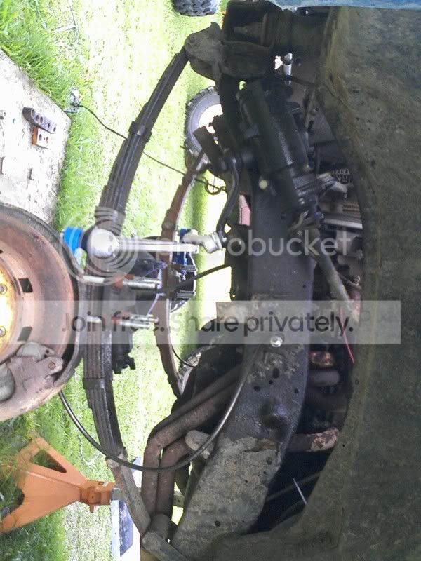

Ord steering brace
After marketbillet grille and h4 headlight housings with 55w bulbs
12" lift Kevlar wrapped brake lines from ORD
14" travel fox 2.0 w/ resi's
2wd steering box tapped for hydro assist w/ 4" drop pitman arm from superlift
10 front w 4.10's 30spl aburn posi/warn premium lockouts, dana 44 flattops milled and drilled, new bearings and ball joints new gears totally rebuilt ...Got a smoking deal so it works for now..d60 search in progress...
Sky tall highsteer x-over arms and draglink w/ 1 ton tre's
Arp steering studs w/ new conical washers
Blazenoffroad tie rod w/ 1 ton tre's ( Awesome service!)

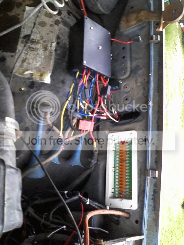

Complete rewiring of all after market wiring

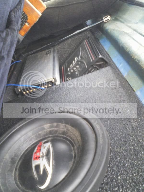

Custom built sub box speed linered for 2 10" punch hx2 subs and custom amp rack

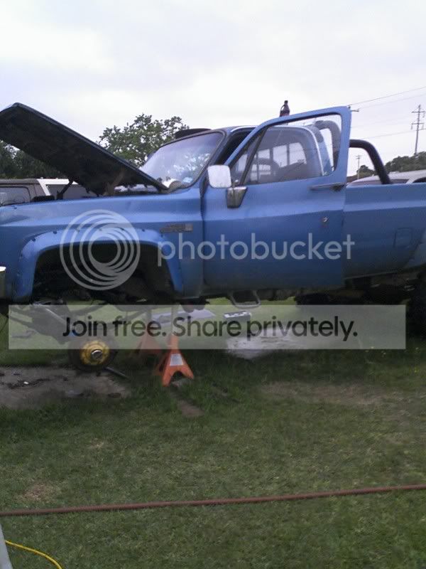

Ok heres some picks more on the way
what I started with
new holley and edlebrock intake
All the new wring and relay box

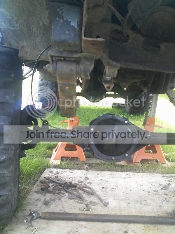

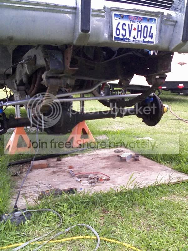

steering

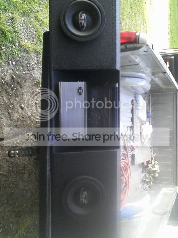

speaker box I built
A tight fit.. mephis 1000d/kicker 350.4/memphis X03 cross over mounted on custom rack and secured with 7/16 security tor bolts..
Tight fit...

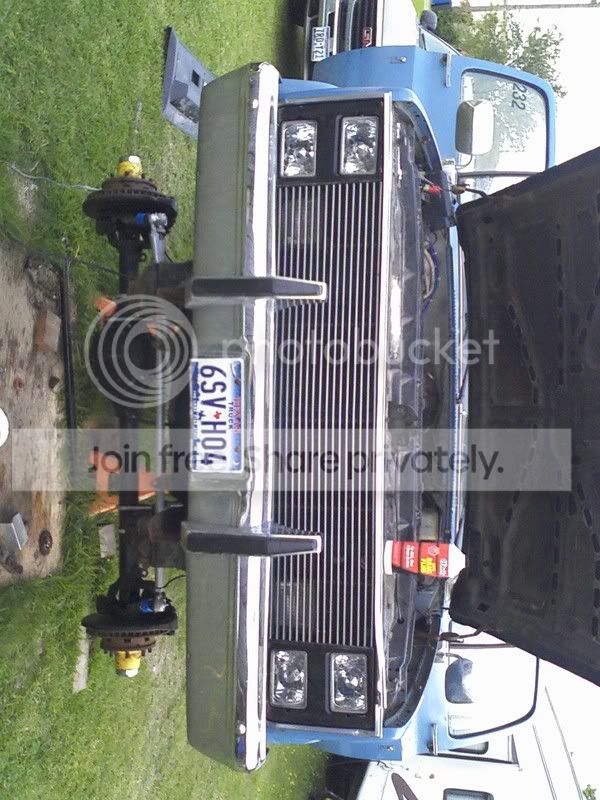

Front end coming back together ..Hid upgrade may in my future for the highs low are plenty bright

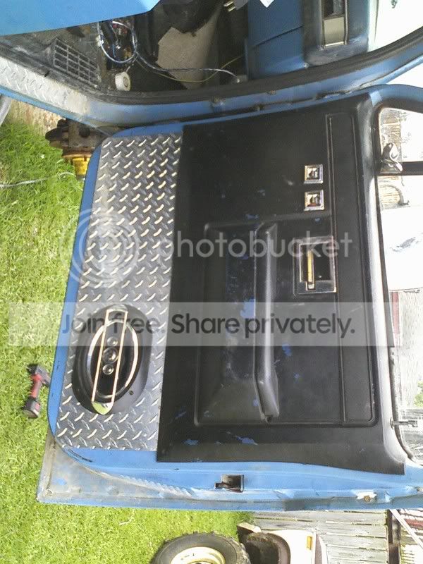

Added a lil bling to the old door panels and a place to mount my new 6x9's

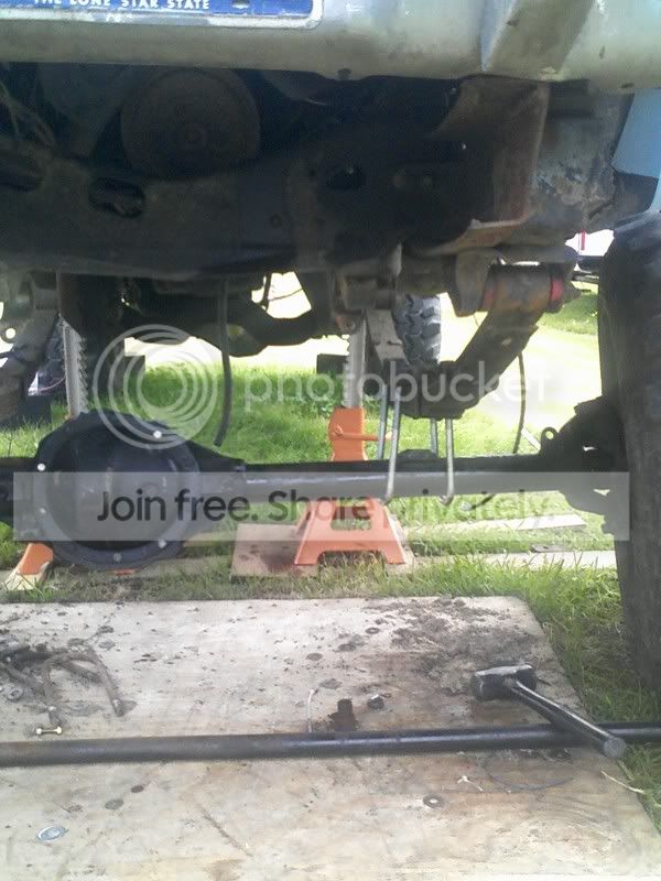

Had planned on running zero rates as well but clearance issue with tierod held me back..reasoning for long ubolts.. portaband treatment coming soon
The reason I picked up the front end for a song.. Was once under a samari and had the spring perch moved then a 4 link was added.. 6hrs with a grinder and a relocated driver spring perch and I was good to go again

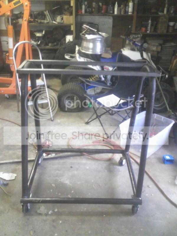

bender stand I threw together to make shock hoops for the fox shox just need to get the oxygen filled so I can cut out a top and bend the tube accurately.. I made the uprights with the bender sitting on the table w/ a hf 8 ton ram and a tape measure...
steering
speaker box I built
