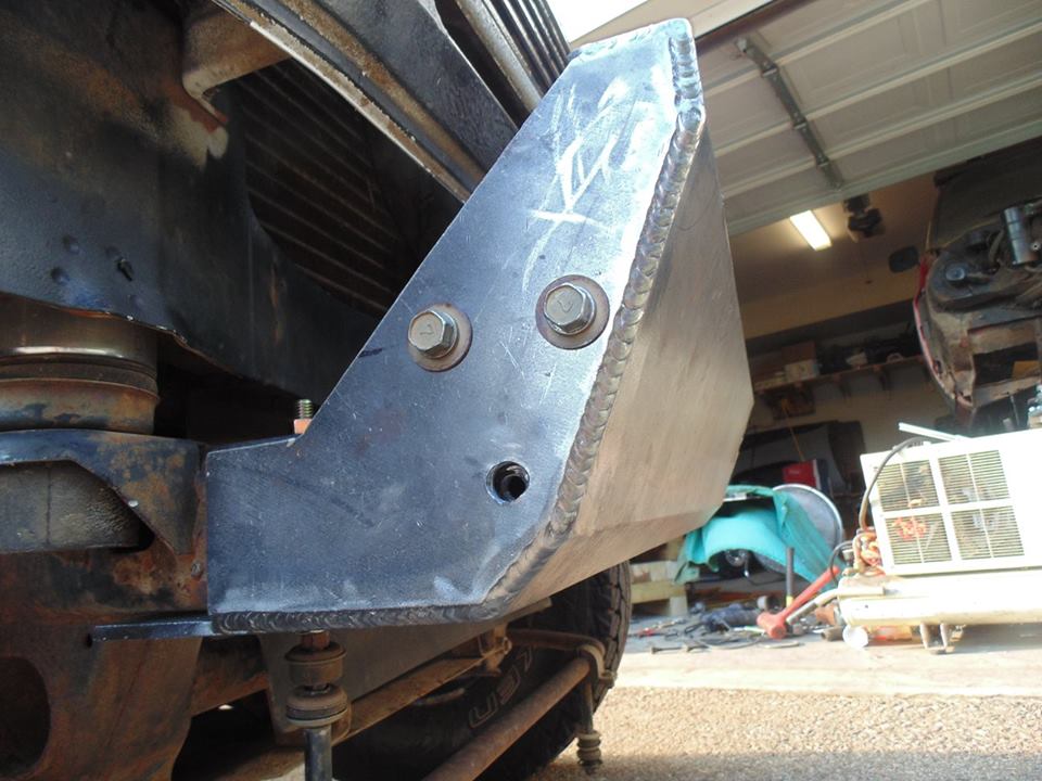

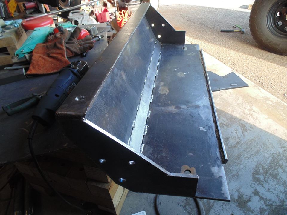

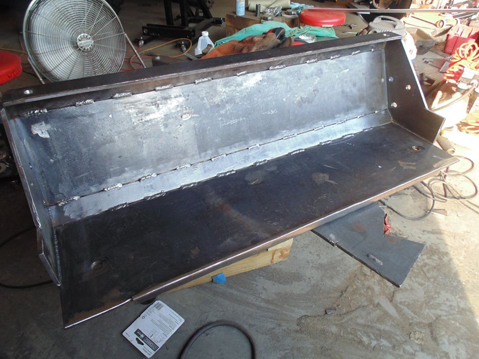

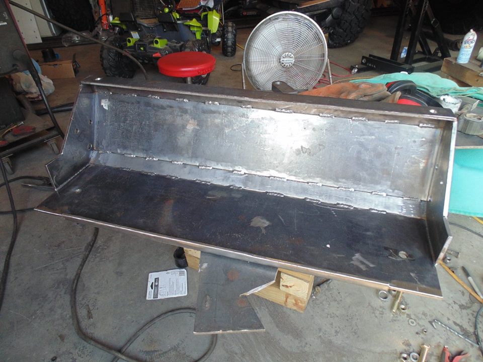

Got the 1" body lift half way installed. Pucks are in but need to get some longer 7/16" grade 8 bolts and then make 1" drop brackets for the fan shroud. Making good progress on front winch bumper. Should have it all welded together and bolted in sans round tube wings by the end of the weekend.
