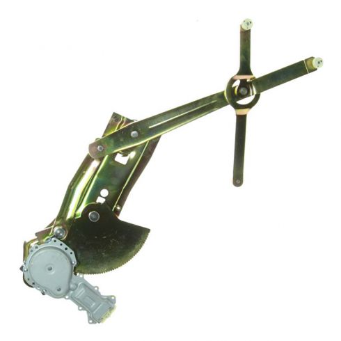

I'm right in the middle of rebuilding another pair doors and there is no drive tape in there. Regulator gear is driven right from the motor.
The gears can strip but it makes a lot of noise. You'll know stripped gears when you hear it and you would have seen the bad teeth when you did the motor. Plus motor would be spinning until it hit good section of gear teeth so you can rule out bad gears.

Power regulator for '81-'91 Blazer/Sub. No drive tape. ;)
