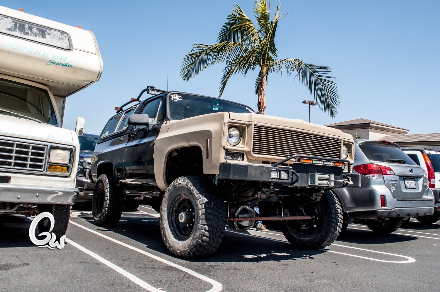

Well its been a while. Yall know the paint started peeling. That paired with one tons, 4.56s a locker and crossover steering led to me beating the Crap out of it. Not,being afraid of every branch is liberating. I also converted to a 1976? Front clip. I love the round eye!
But i cantbleave well enough alone. I took a year off from the build so i can go be a marine. When i got back I took it wheeling once and it went back under the knife
Currently getting coilovers and 5.38 gears and a spool out back. I also upgraded to hydroboost brakes along with disc brakes out back. Im trying to be #Racetruck haha so far its going pretty well. I have some engine upgrades lined up for when the suspension is done
Well the truck kicks ass. Its very very fun. Painting my grill and trim black, as well as gearing the front axle to match the rear. After that its just the little stuff till hammers! Any ways here are a few misc. Pics. One is at ride height and the other at droop. Need to pull the shocks to see what bump is like
Maybe its the angle of the pic, but looks like your coil over goes negative on full droop. Also what driveshaft are your running? I need to buy one as the stock one runs out of angle at about 28 degrees.
It might look that way, but it stays in a progressive curve, if it dropped anymore it would go digressive but the shock tower actually touches the body, that was the only thing we could do to fit this and the bypass. Not a ton of room.
He’s also got a Tom Woods 1350 cv driveline.

Yeah my rear bumper is meh. Was initially built by another company with a spare tire mount and stuff but it kept breaking, so what you see now,is my,first ever attempt at welding and fabricatiin to try and build something that wasn't going to fall off again haha. I do plan on building a completely new rear bumper down the road. Ill keep you posted on what is going on
