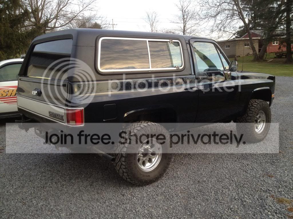

I used this kit. I don't know how much lift I actually got. I took out a hacked 6 or 8 inch.
http://www.ntwonline.com/76-87-GM-1-2T-2-INCH-SYSTEM-W-52-INCH-RR-SPRGS-W-SHKS.html
I like it just fine. In the future I would like to get some Bilstein 5100 shocks for it.

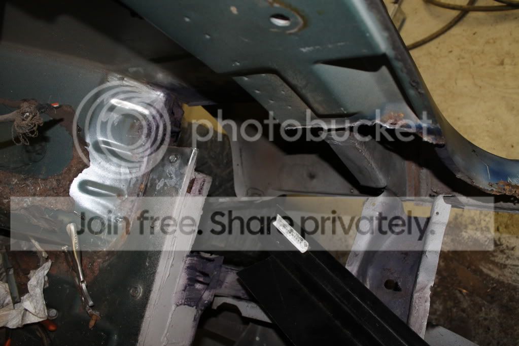

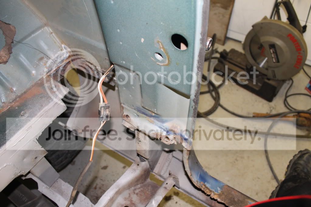

I have made some slight progress. all the rust is cut out and I am starting to fit mew metal.
This is the first piece I welded in
before
Rust work
I will be handling this same kind of damage you have next year. Mine was not so bad. Good looking truck and dog. Scribed.

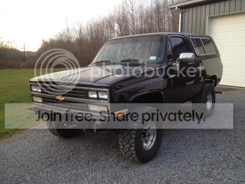

I did the drivers side. I ran out of time so I had a body shop do the passenger side. I also had them paint the doors and rear quarters. Except for the rockers and floor all the panels are original.
I did not dyno it after I changed the pistons and cam. I did can the TBI and equiped it with a Holley EFI system.
Looks like you did a good job! Turned out great, hoping to start my rear floor sometime in the next month or 2.
