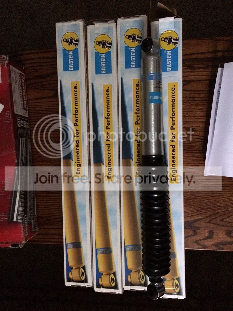

I love the UPS guy. He brought me a box from Summit Racing today. Hope to get them on this weekend. Brake lines should be in Friday and then I can take it for a drive.

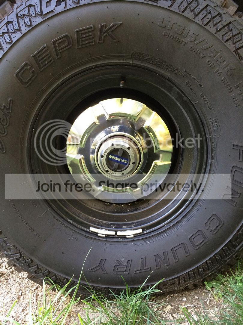

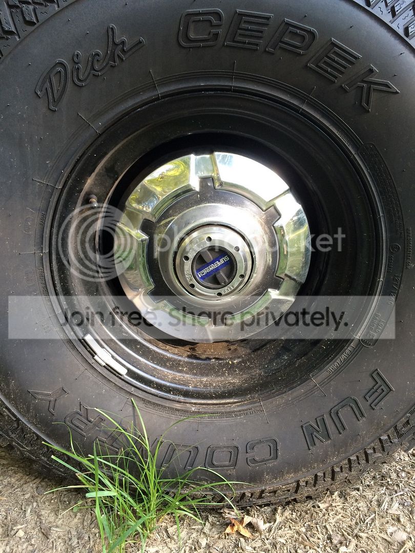

Not a lot to update right now. Installed 2" spacers on the rear and finally got around to cutting the centers out of a couple of hubcaps. Used a Dremel and then a small grinder to smooth out the edges a little..

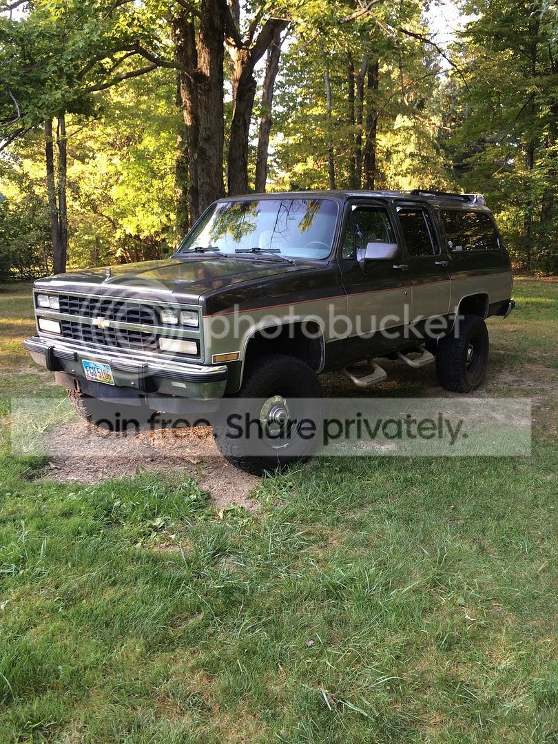

made the first pic my desktop...:waytogo:
Thanks for the kind words. I have a pic of it as background on my phone. Wife doesn't understand why my truck is background and not her. I never have the right answer

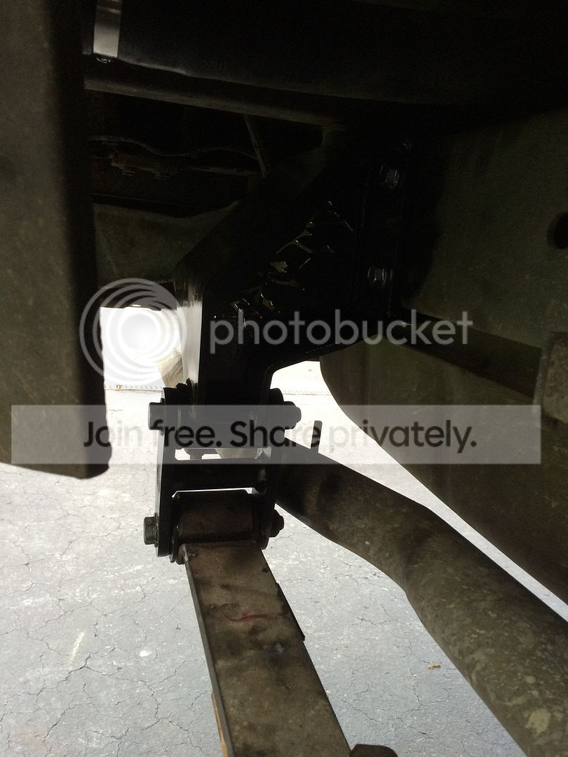

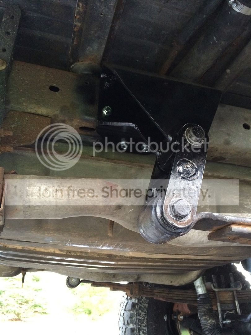

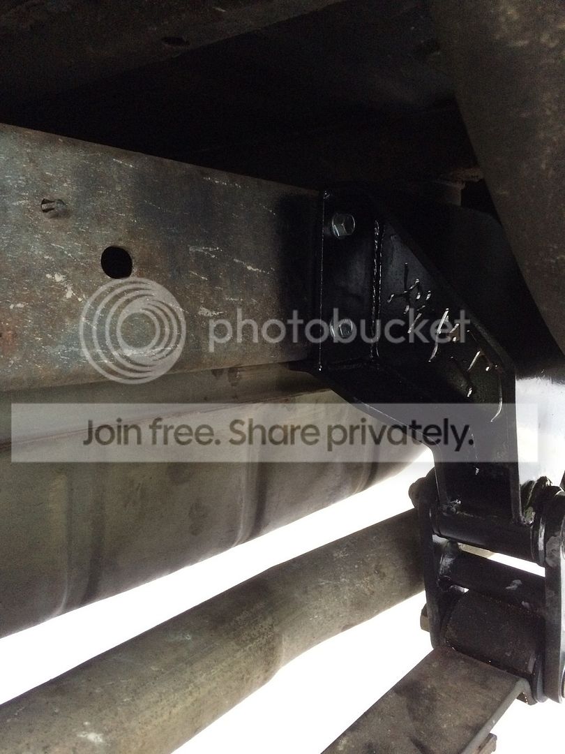

Couple of new update. Put a Detroit locker in a couple of weekends ago and just had a DIY4X shackle flip installed.

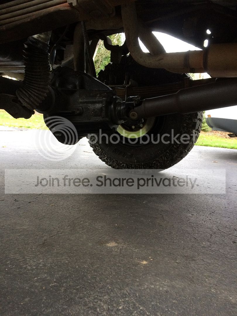

Drove it 25 miles and the vibration I was getting when I let off the throttle has disappeared. I had my pinion angle off when I welded spring perches on and had a pretty good vibration. It's still not right, but no vibration up to 65 mph or when I let off gas
I did away with 4" blocks. Didn't take before measurements, but it looks to about the same height. Not different enough to notice. I had all new poly spring bushings put in too. It's probably just my imagination, but it seems to be a little less floaty
