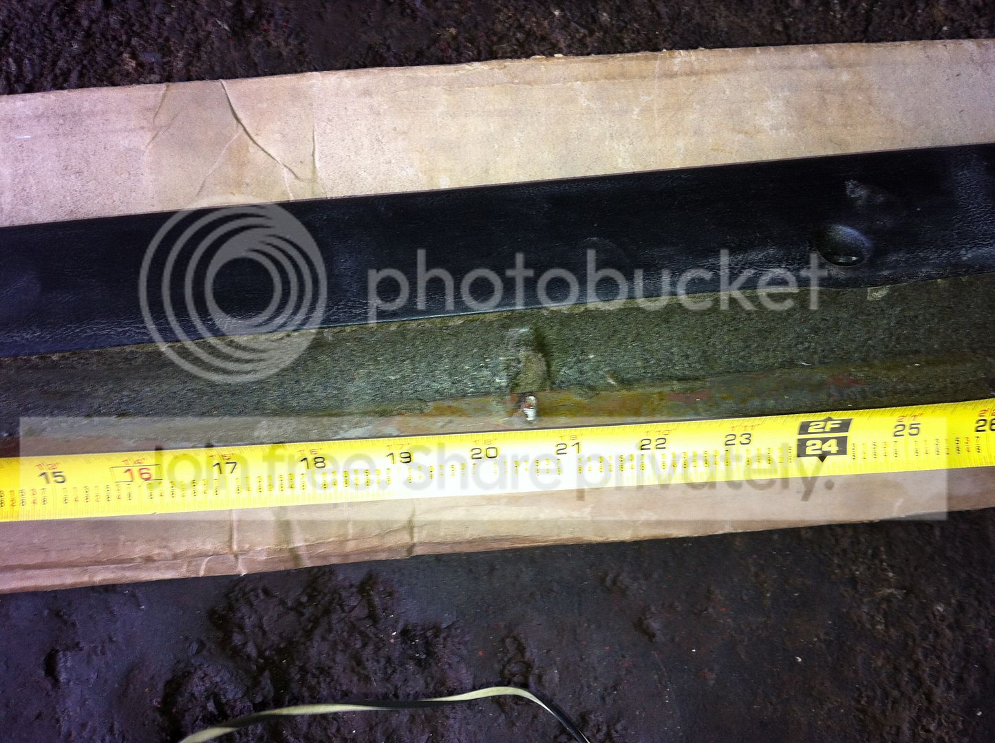

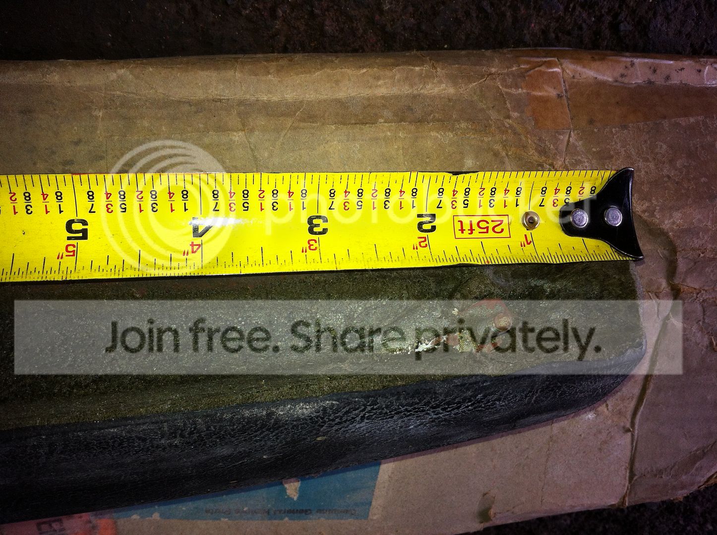

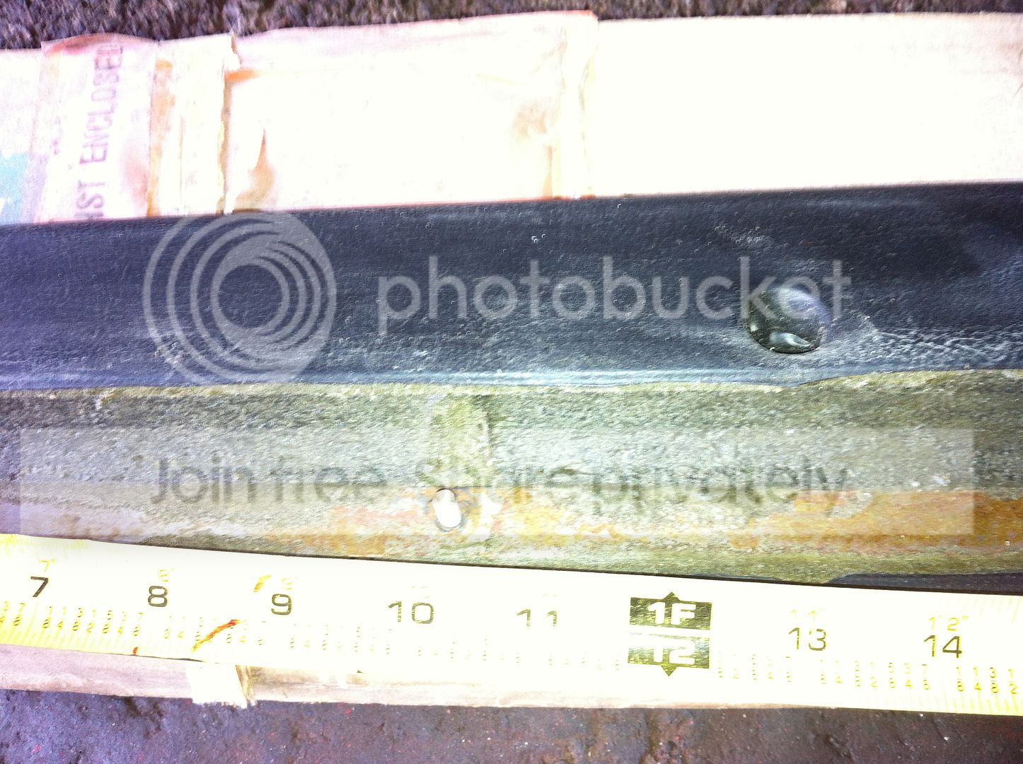

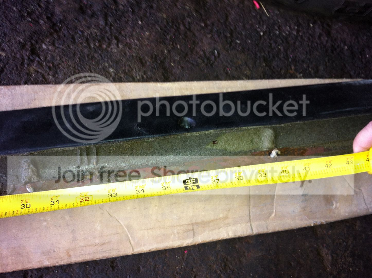

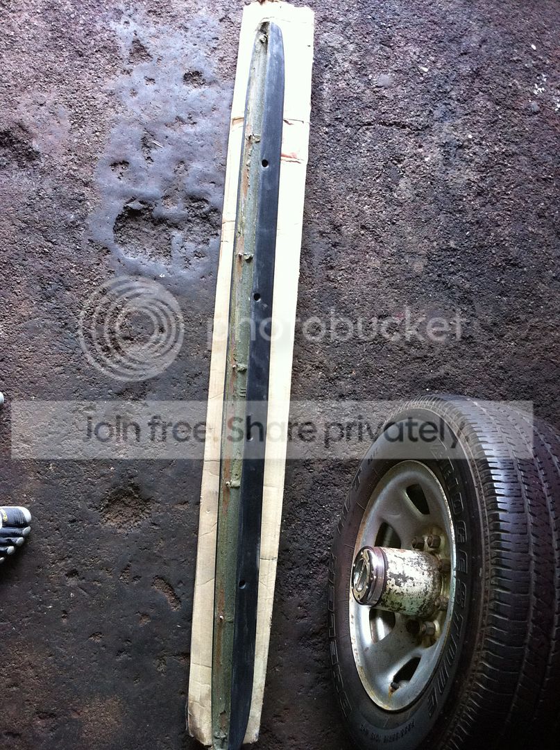

Here you go, let me know if there are any other angles you need.
Cool man, thanks. :waytogo:

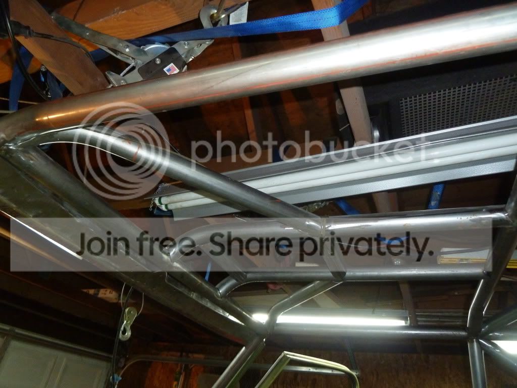

It looks like there is a "bump out" at every mounting bolt that actually holds the dash pad away from the dash. From the pics, it looks like I could do my my mounting through the dash everywhere except directly where the actual dash pad bolts are.

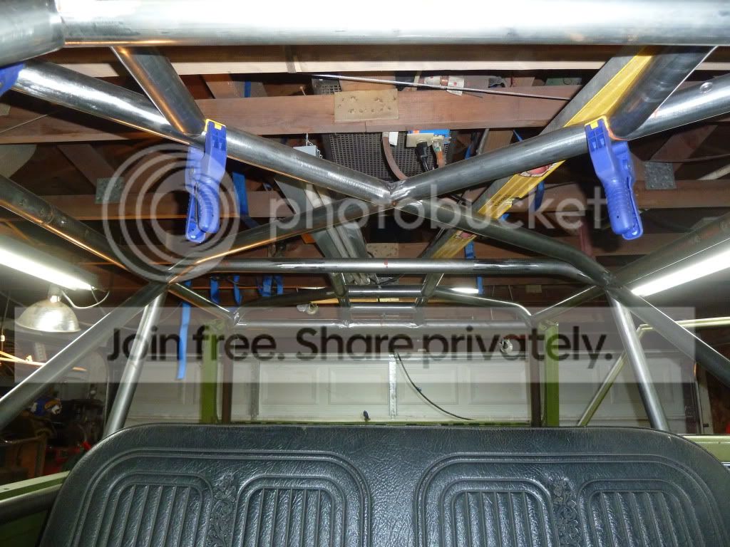

Oh, by the way, what do you think of this crazy set up. I took those back bars out last night to see what it would look like. I'm sure that I took some strength away, but I wasn't even going to put bars in there in the first place.
It feels so much more open with just those front bars in, it's crazy. This way I win with the bimini top, wiring and still have an open feeling.
I like it! of course, I'm a "less is best" kinda guy. part of the reason I like these trucks so much is because they're open. I don't want to close them in again if I can help it.
I like it! of course, I'm a "less is best" kinda guy. .
That's where I'm at now. When I had those two other bars in over the front seats, it looked complicated. If I stayed with those, I would have needed to add more bars to the back and so on, and so on, to get it to look and feel symmetrical and even. Eventually, it would have been easier to build it out of 1/4" 4x8 sheets and cut holes in it for the windows.:eek1:
I'm done and moving on. :D
I like it. When I do mine I plan to keep it as simple as possible. My truck won't be put in situations where multiple rollovers could happen. It'll be more of a what if I flop it on the road and want people to be safe. Then I'll probably make it a wheeler and add more...
Looks great man, I also plan on a very simple cage.
My truck will never be capable enough for me to tackle trails that would put me into something super crazy.

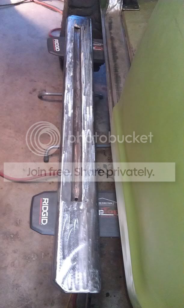

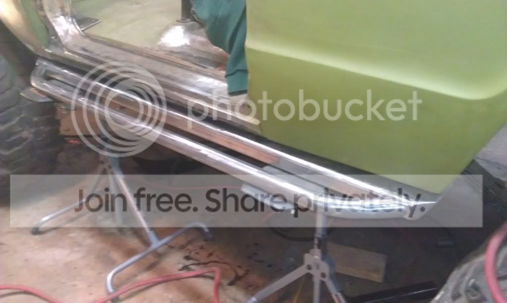

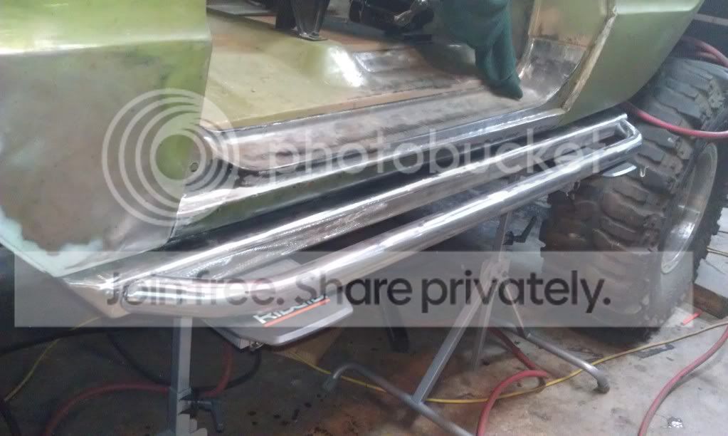

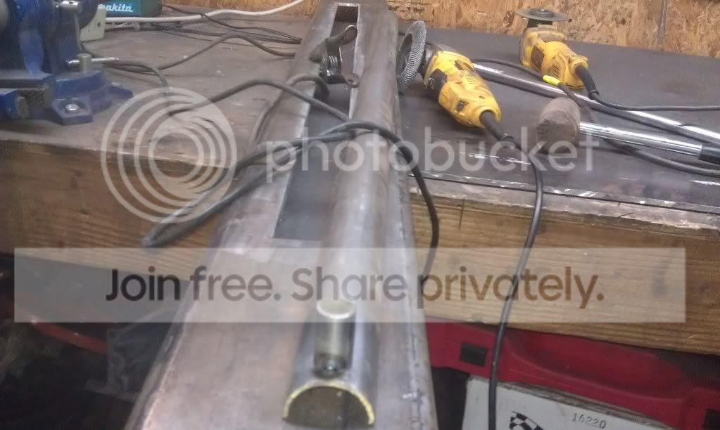

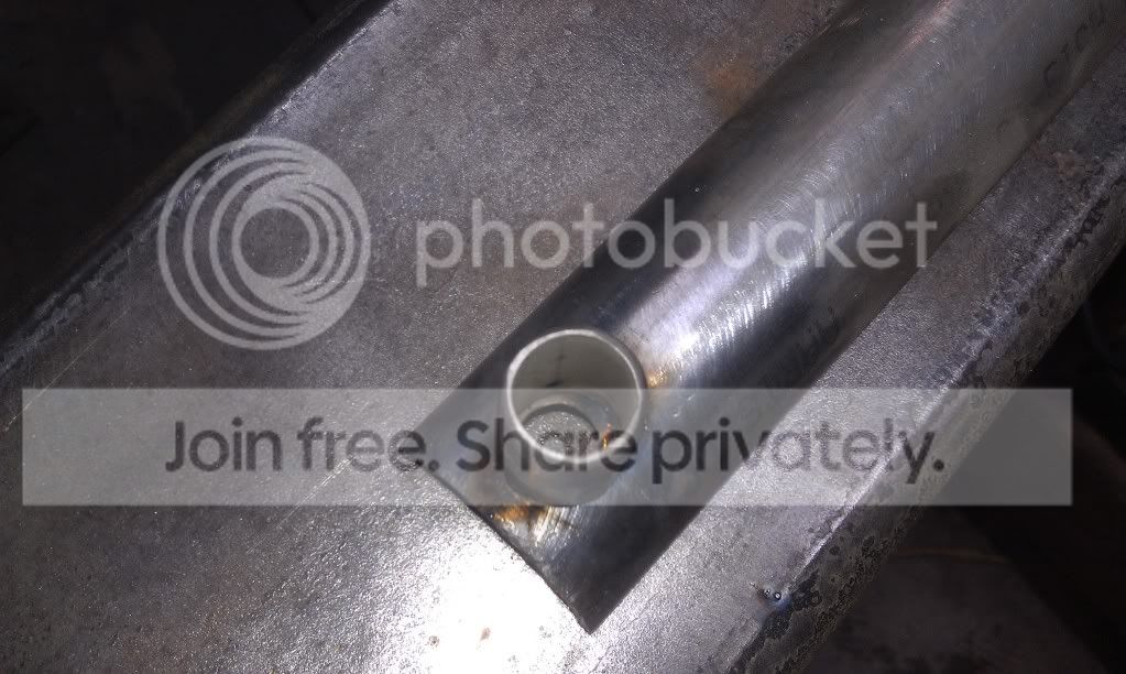

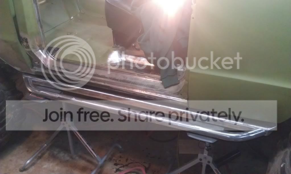

Got a little garage time this weekend. Didn't want to really screw with the cage until my tabs and stuff come in from Kert, so I started some work on the sliders.

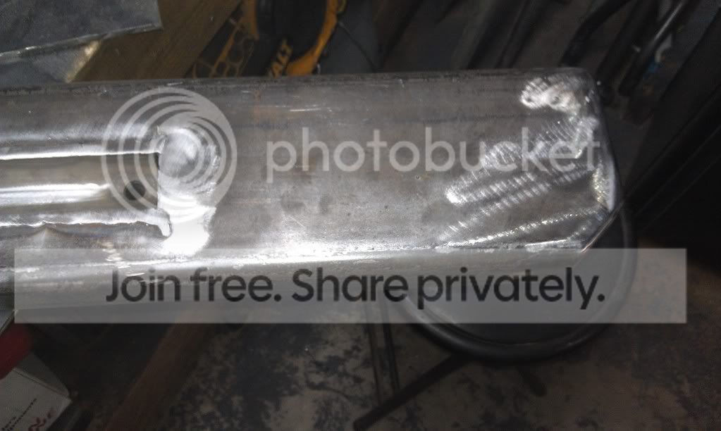

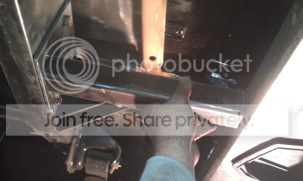

I wanted to keep them up as high as I could to the bottom of the rocker but the pinch weld held me down some. I ended up grafting in a piece of 1.75 to the 2x6 where the pinch comes down. As I looked at it, it kinda reminded me of a gutter. Being the contractor type, what's a gutter without a downspout??

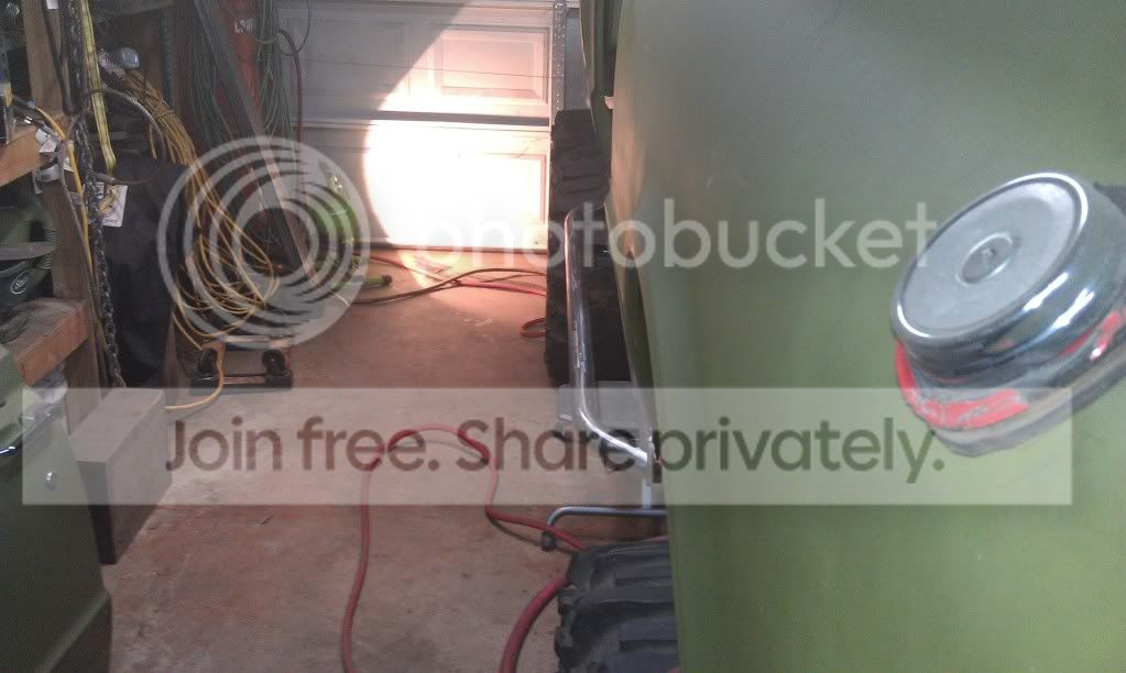

Still haven't mounted it all up yet, but I have the drilled plates in the frame and the 2x2 cut to mount between the 2x6 and plates. With the 1" BL, I ended up with about 2 1/2" from the bottom of the rocker box to the bottom of the frame. Plan is to do a gusset system where it mounts to the frame plates. Should be plenty strong..
On with the pics..(cuz everyone knows SBD loves the pics)
Still need to cap the ends of my gutter. :D
great work man! good call on the drain for the gutter. just know that would fill with water otherwise.
